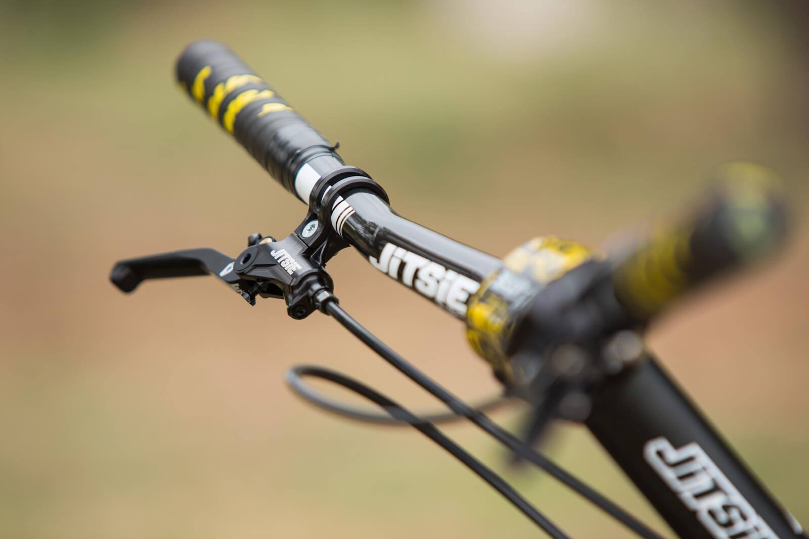

  7. Not to be a downer, but using a barbed fitting there is not the smartest thing to do. Also, the brake lever cannot be changed without taking the grips off. This could have been prevented by using the Avid XX design, which retains the smooth clamp. It appears that Jitsie has gone with this design.
