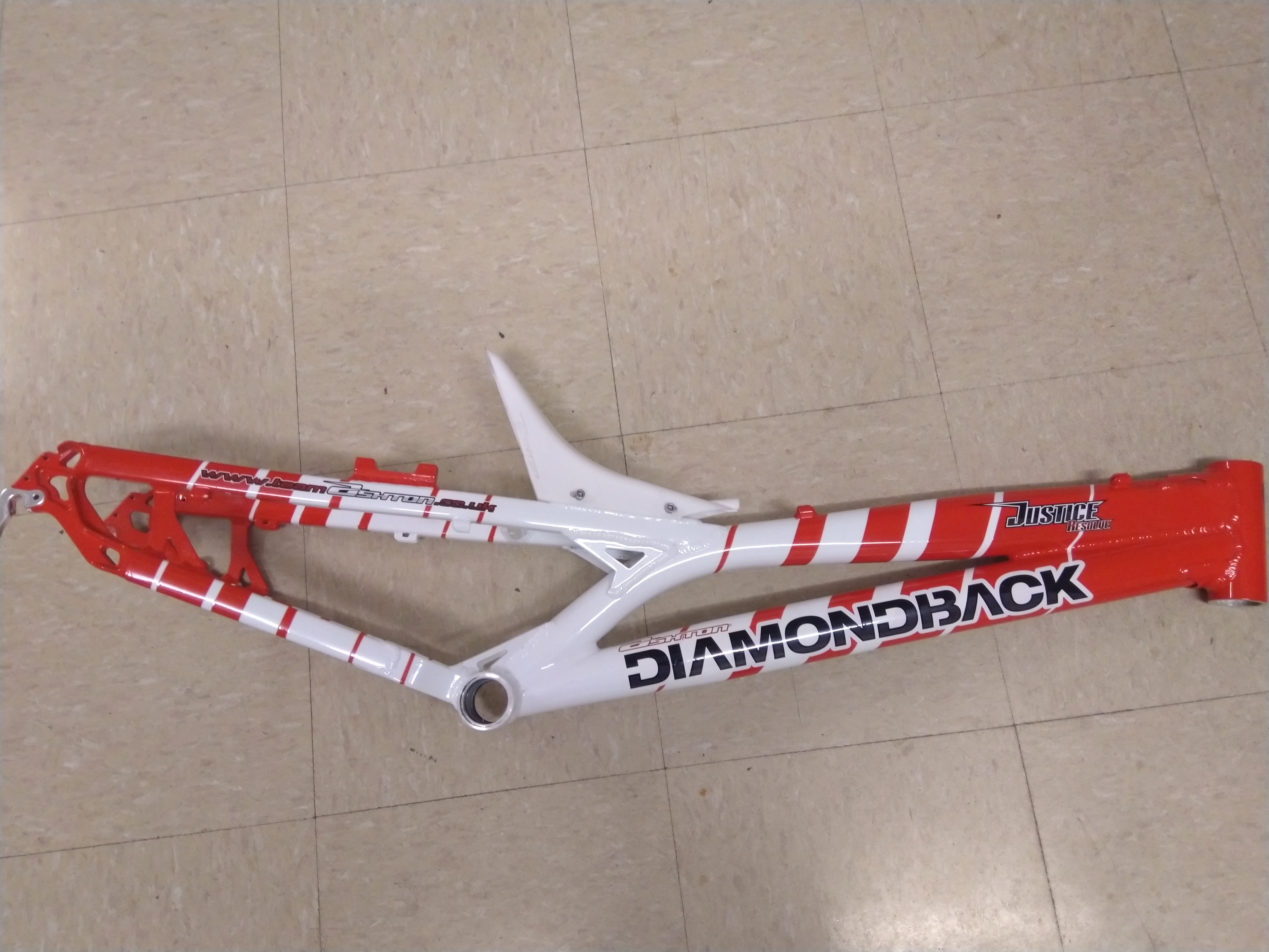

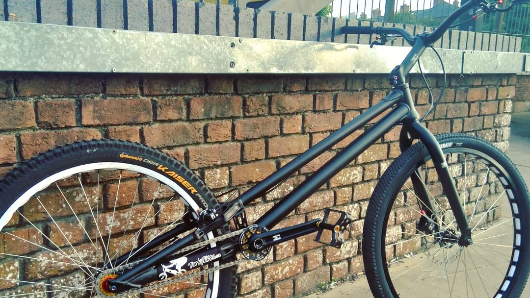

  2. Got a little bit bored so I decided to go for something different. I did have an inspired a while ago but didnt fully get on with it but i managed to pick up an Octane One Void frame. I dont ride as much as i'd like to these days so just something to still have a bit of fun on but not 100% sure on geometry yet as im unfortunately isolating so cant get out and ride - _ -

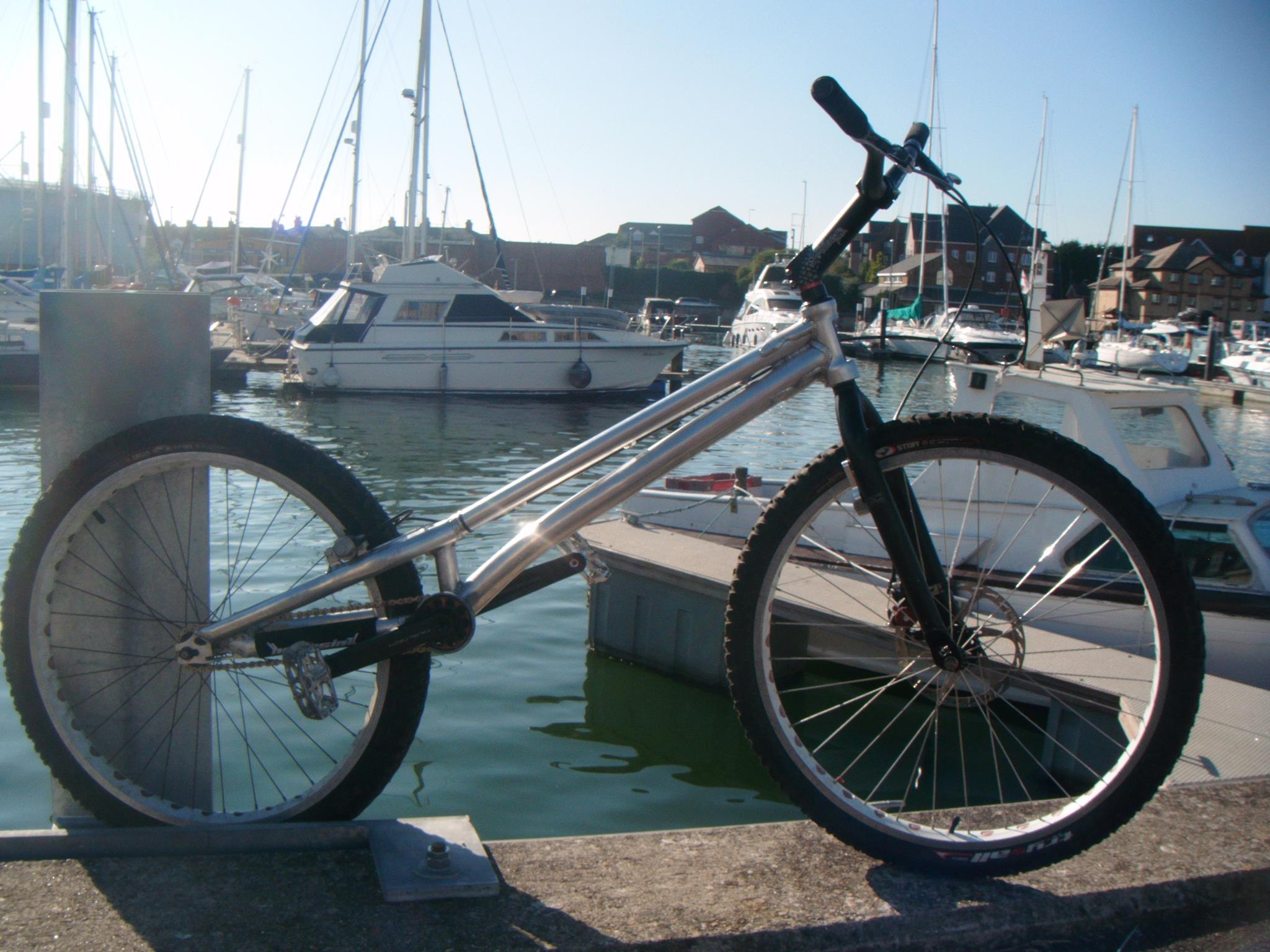

  3. First bike was an Ashton Diamondback Speedrace fans which eventually snapped at the chainstay.... Onza Genesis which later got rawed then cracked... I miss riding the Limey 3 I think i was definitely at my peak of riding on this. Even though it was heavy it just easily chuckable across gaps I later experimented with 20" and also built up what i thought would have been my dream build but weirdly didnt get on with it and kept getting faulty brakes - _ - Sold the 20" which i regretted as i surprisingly got on quite well with it so i thought id get another but it didnt feel the same... and then another echo... And now back onto an Ashton for nostalgia reasons and quite enjoying it even though its on the heavy side. Definitely been very indecisive over the years and should have just stuck to one bike... although i am contemplating one last bike then stopping there... hopefully...

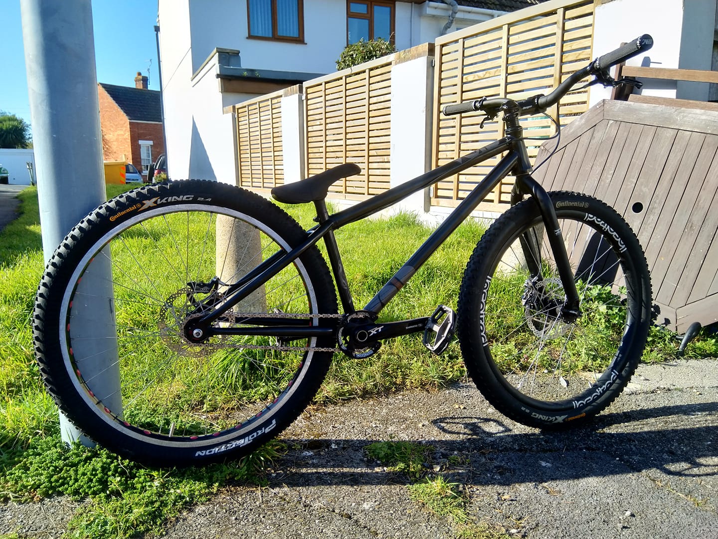

  4. Slight update on the Ashton. New bars and stem

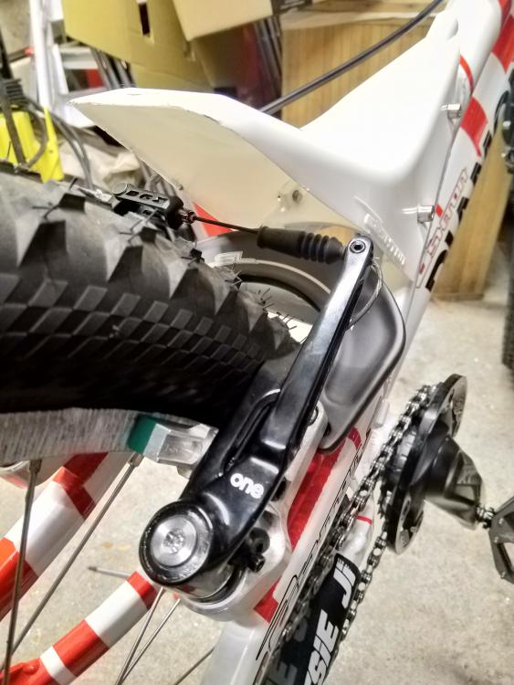

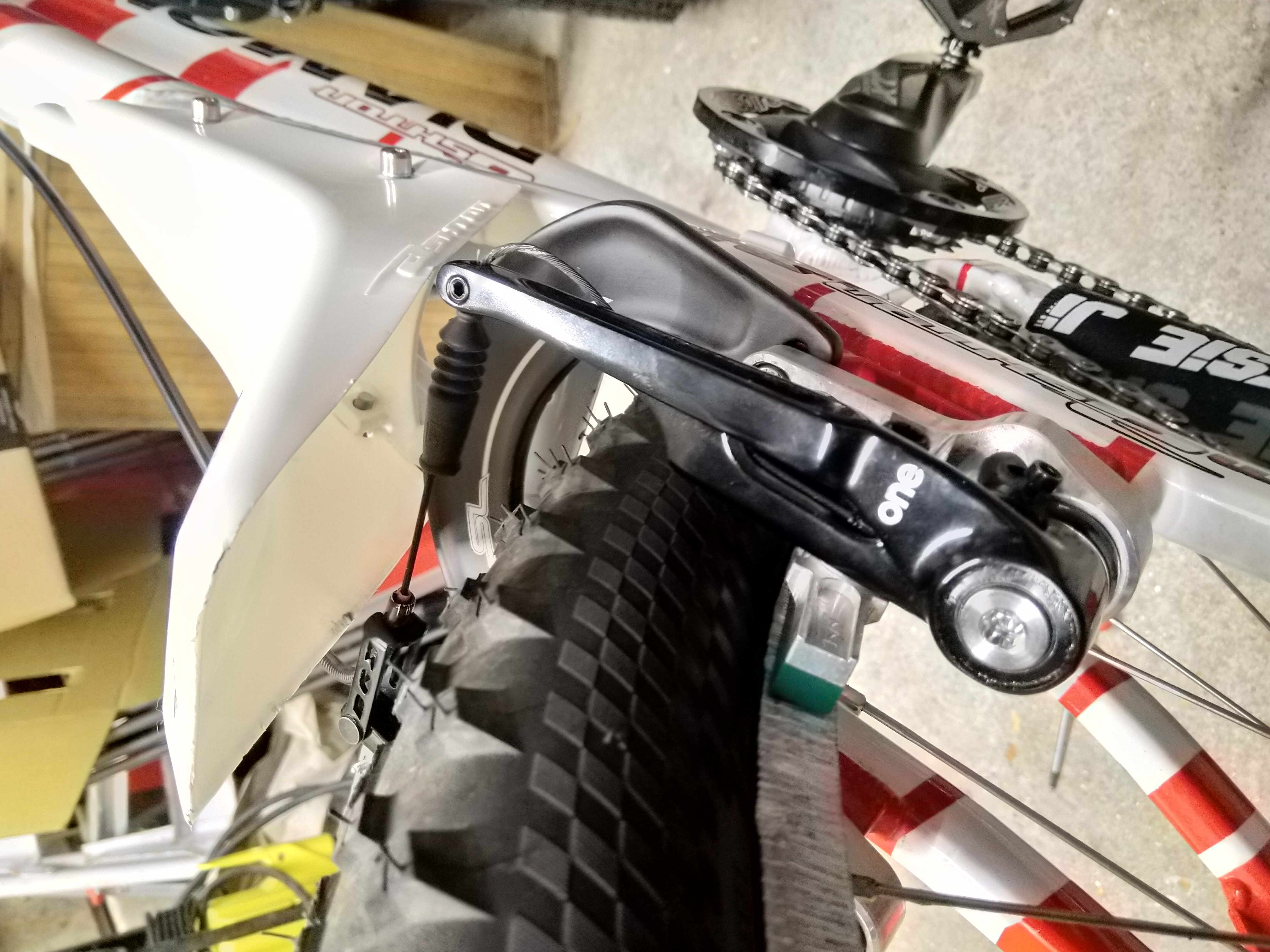

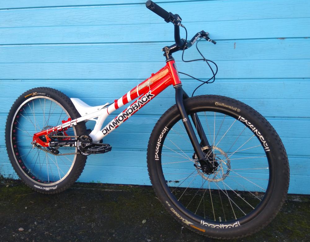

  6. Not really what i expected in the end. It did work pretty well but i thought it may eliminate flex but i've ended up going full hope now due to too much flex in the rear brake aswell. Was an interesting experiment but they just dont work well with v levers, they seem stiffer with road levers weirdly
  7. Got some little wheels a couple of weeks back pretty good fun so far just need more time to ride D:

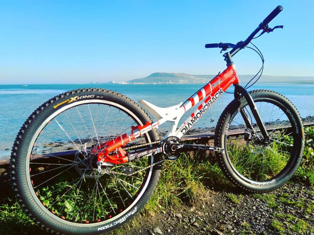

  9. Pretty much finished got a booster coming for the rear brake and still need to bed in the front brake but other than that it's pretty good fun so far!

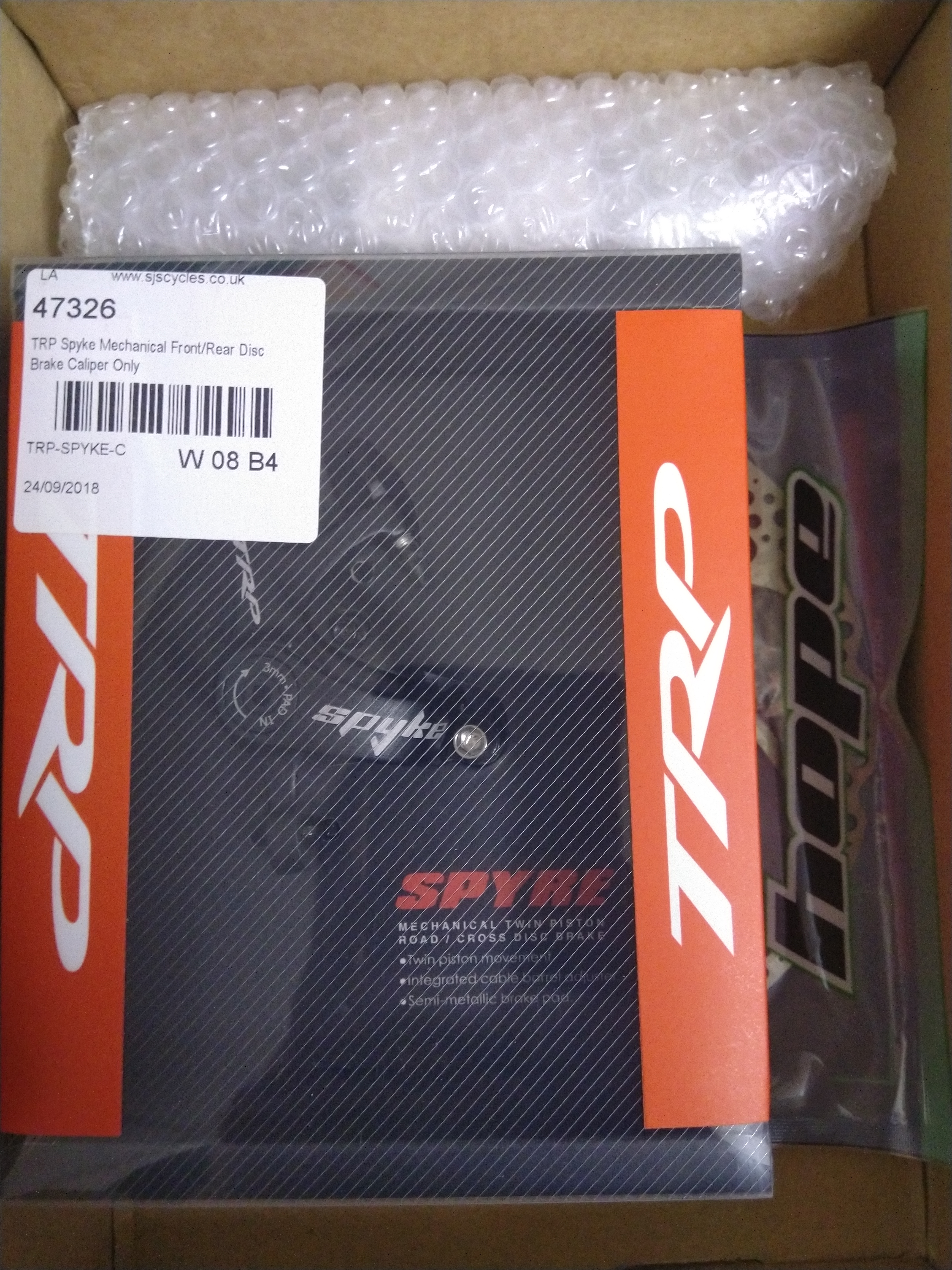

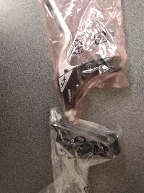

  11. I just think its a good idea having a dual pull system so both pads hit at the same time rather than having a fixed side so you end up flexing the rotor. BB7s are great I must say but I suppose it could be a bit of trial and error. The trps come with organic pads so I should get a reasonable braking force (hopefully...)
  12. I've had a few bikes come through work with them on and they seem to work great. If they can also make a sti levers feel nice they should do the job. They seem to have better pad adjustment than the BB7 so always worth a go. I've got a Box Components v caliper coming through aswell, I've always used xt in the past but heard good things about the box calipers

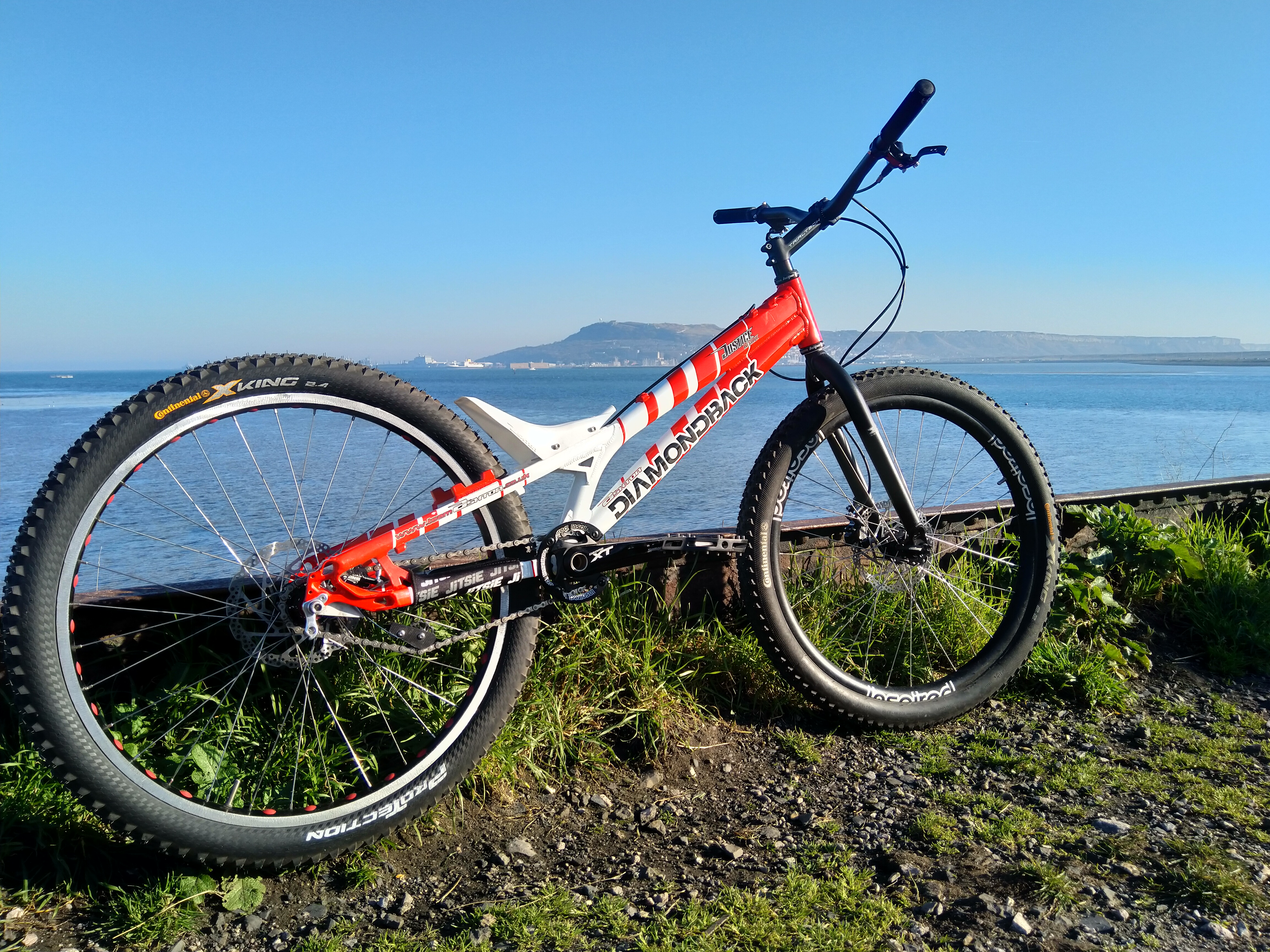

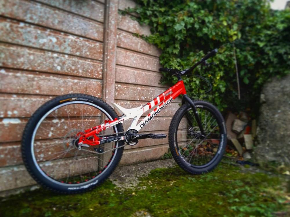

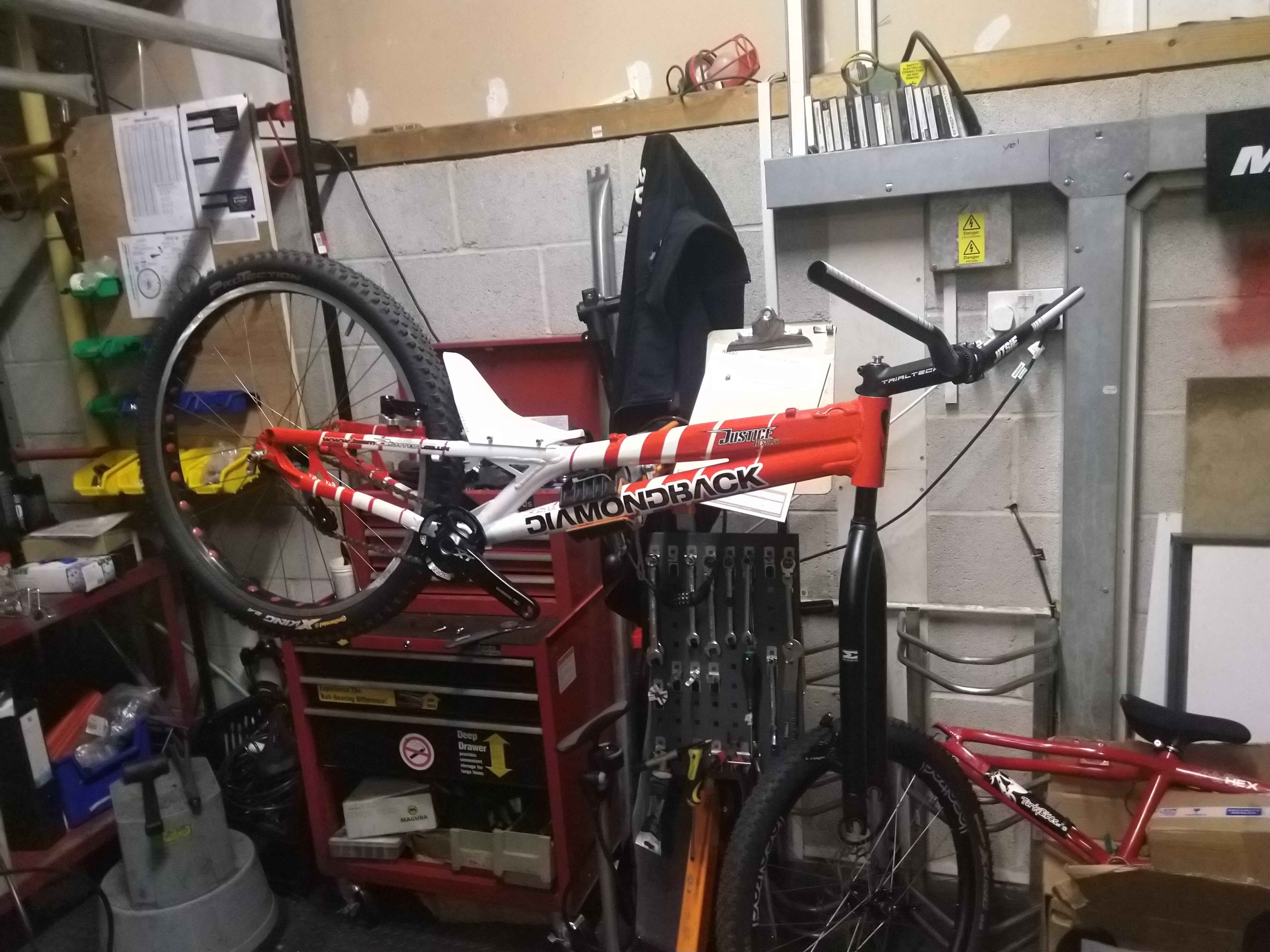

  14. I was scrolling on Facebook and noticed someone put an ashton frame up for sale and I thought it would be good to get one built up as it was the first bike I started on 7 years ago (Here it is 7 years ago.) I'm hoping to get it built up next week so stay tuned...
