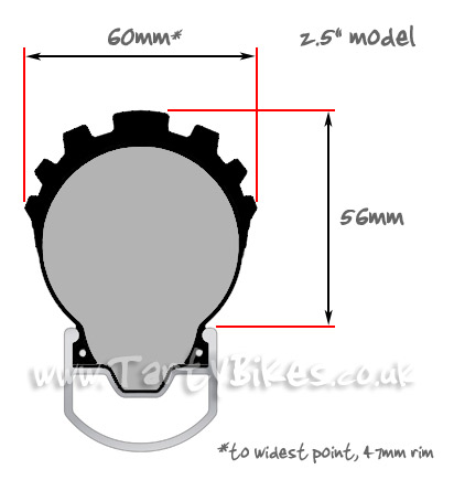

Right I need a new back tyre and could do with a bit of lard cutting as well, so I could play it safe and buy a Dual-ply hi-roller which saves a touch over my DP minion, or I could save a pile of weight by putting a SP version on.
I have seen the paper queen and mountain king used as a back tyre before as thought they were pretty crap puncture wise so will it be the same story with the hi roller?
Also does anyone know if the 2.5 version fits in a t-rex?
http://www.tartybikes.co.uk/images/custom/tyres/large_roller25size.jpg
^ suggests it might not... (if it don't I'll bang on a 2.35 instead)

You point is informative but them conti's (RQ, DK and RK) won't fit in my frame or at least i would struggle without a stanley knife (I think).
I am wanting a hi-roller because it is what I can afford, with £35ish to spend.
Would it be okay with a DH maxxis and mabye a sleeve? I don't want to compromise my riding style much either.

Having read your thoughts I think I'm going for the 2.35 DP.
Does anyone know the weight cos I don't think it says on tarty (sub 1kg I hope)
Weight weenies lists the 2.35 dual ply super tacky high roller as 1242g.

Also I need reliable measurements as my t-rex has pretty poor clearance.
EDIT: Is this it? http://www.tredz.co.uk/.Schwalbe-Big-Betty-MTB-Off-Road-Tyres_18286.htm

This is the one you want. The freeride 2.4 version, with the folding sidewalls, in the gooey gluey compound.
The details and chart can be seen on their website here. It fits in a t-rex no problem as i used to ride that frame.
