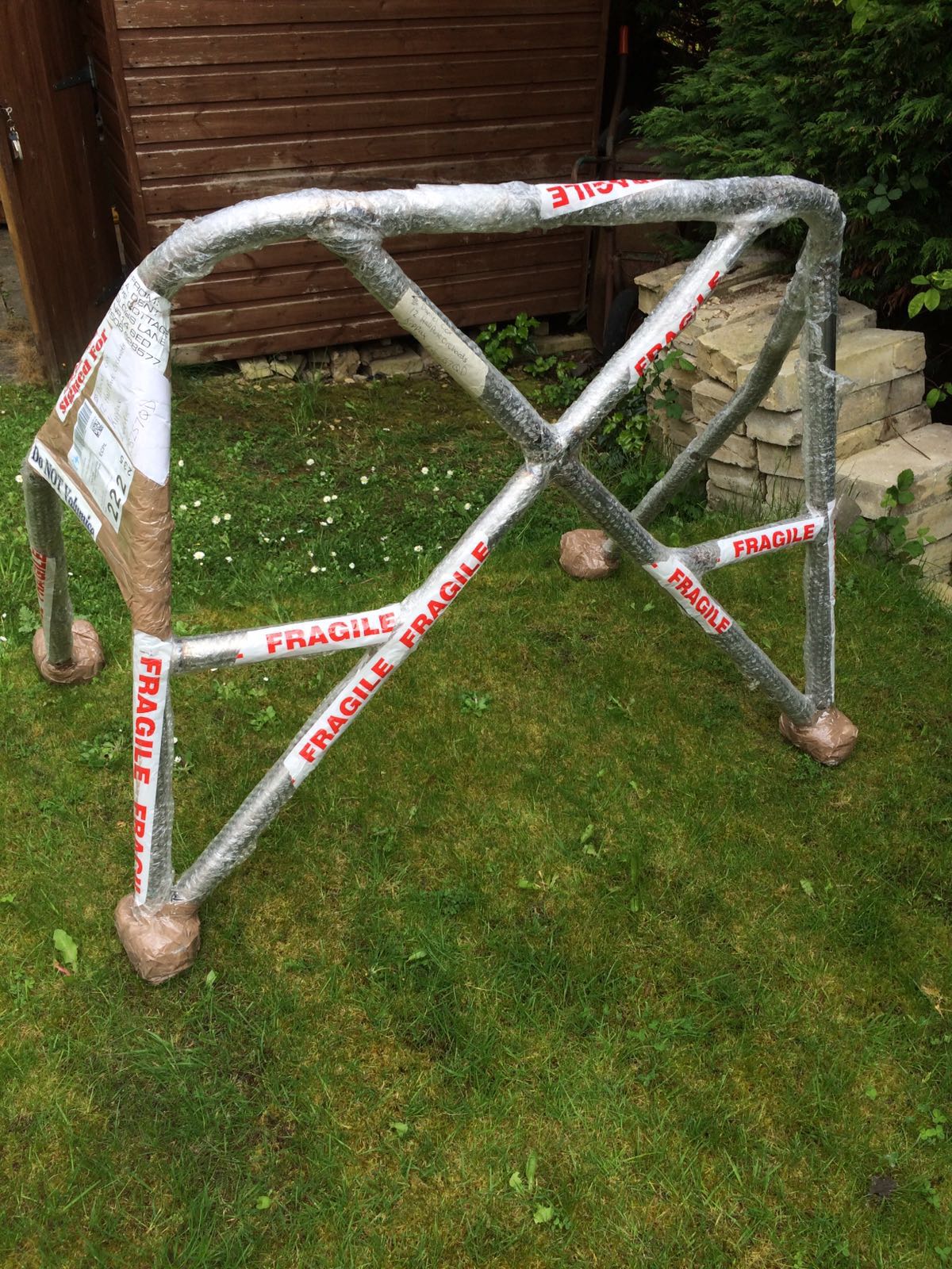

I'll finally do my write up for the cage and other things this weekend.
This is how the eBay cage comes after unwrapping it. Obviously it needs painting as the raw look doesn't do it justice.
My initial impressions are that it looks well built, the welds are fairly shoddy in places but it's mig and it will never look as beautiful as tig.

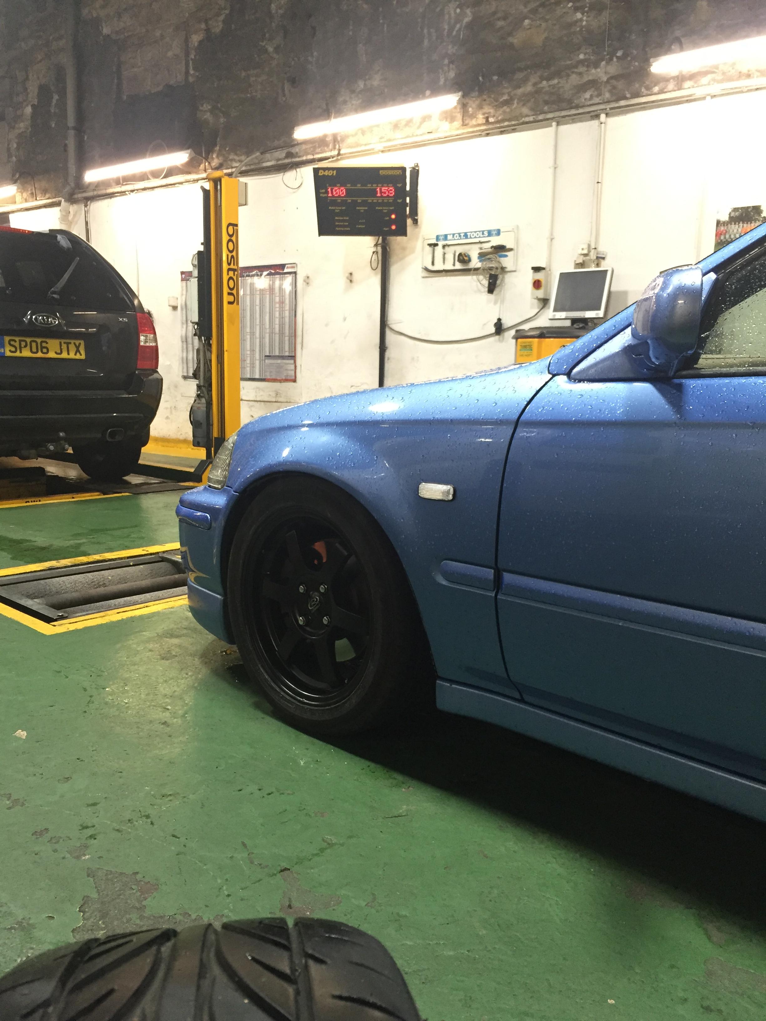

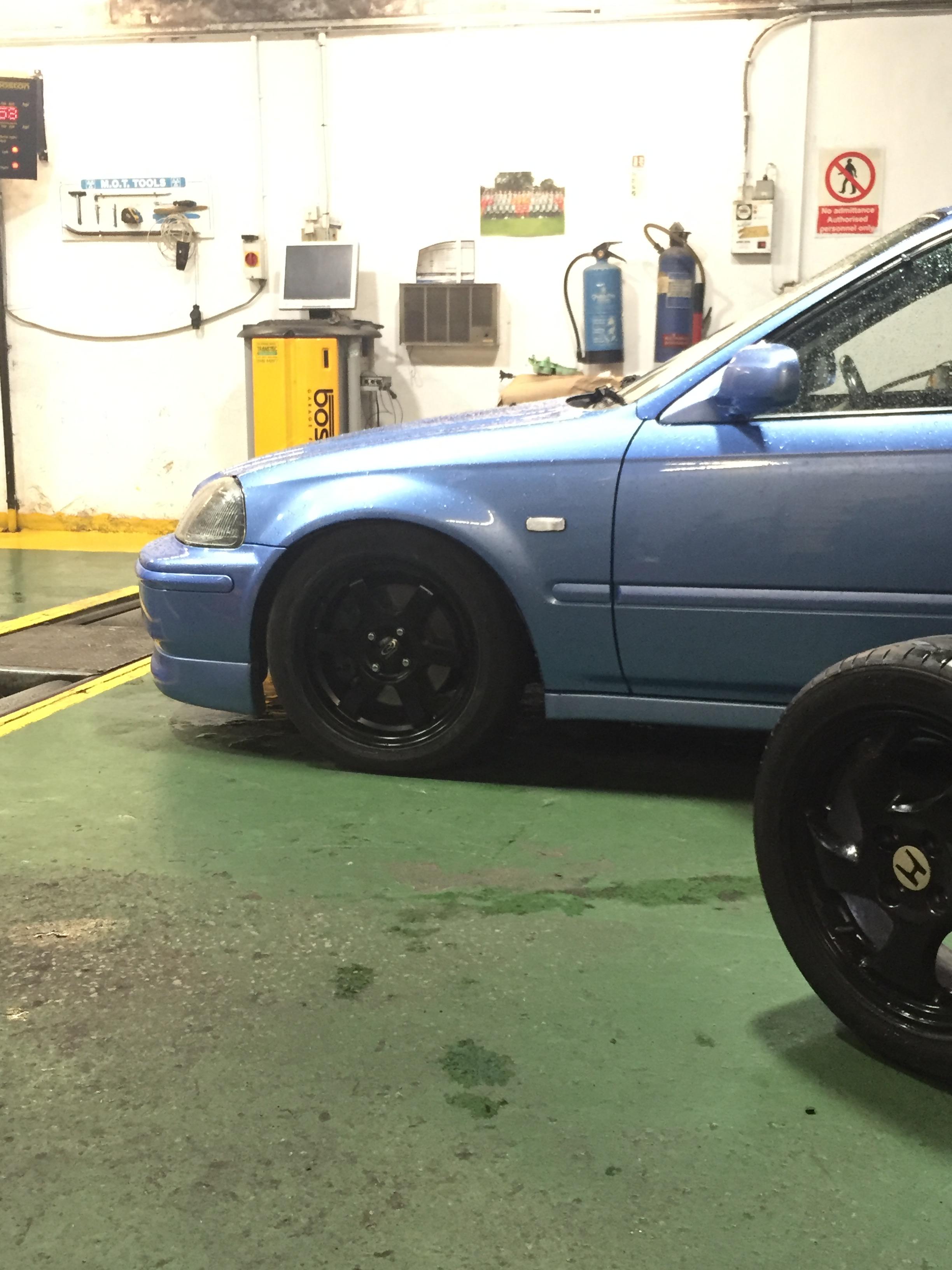

Got my car tracked by BRAM racing, thoroughly recommend them as always.
Went for -2neg camber up front with 15 mins out.
Also the rear doesn't look great, wonder if that's due to the arb?
