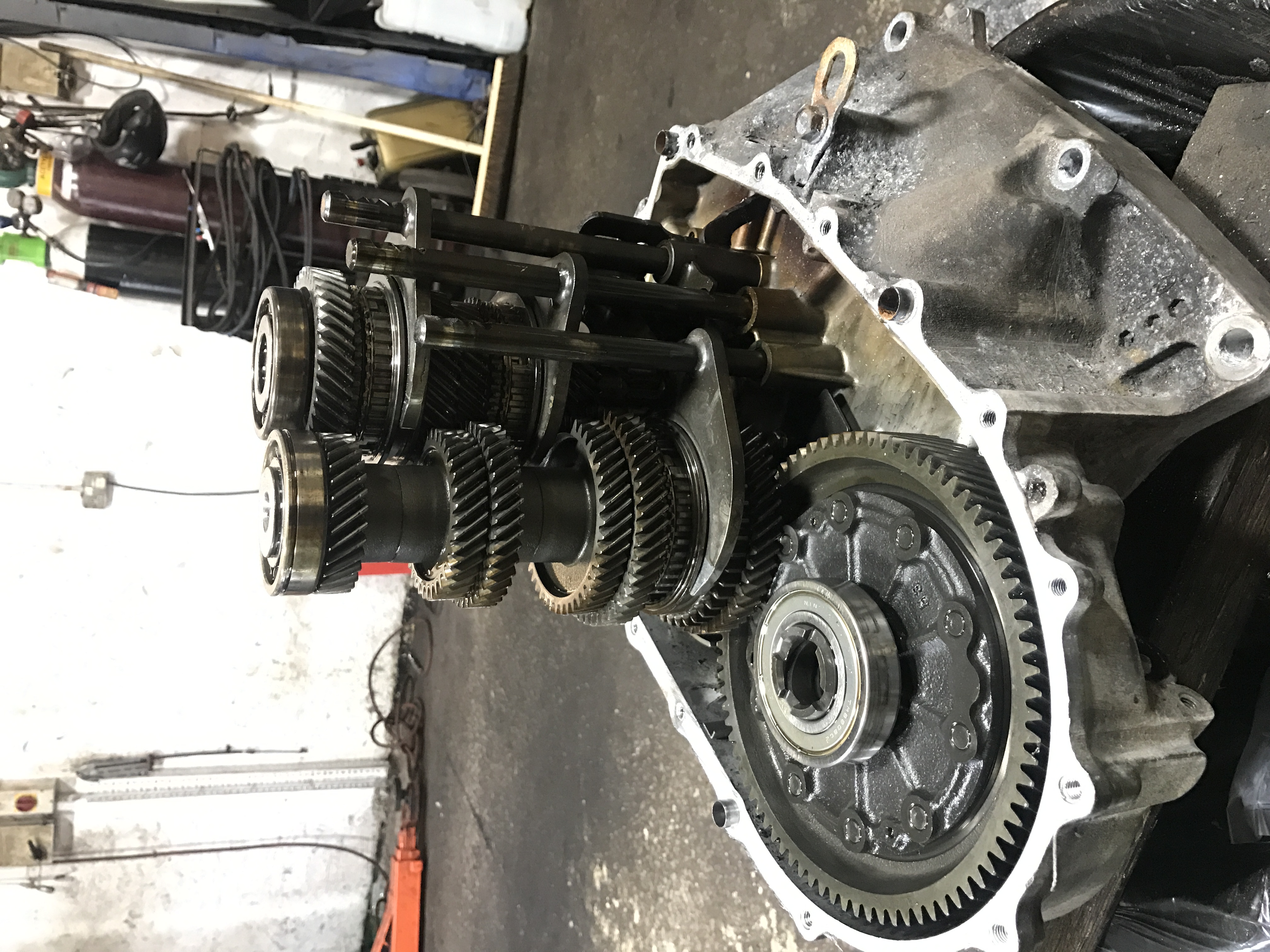

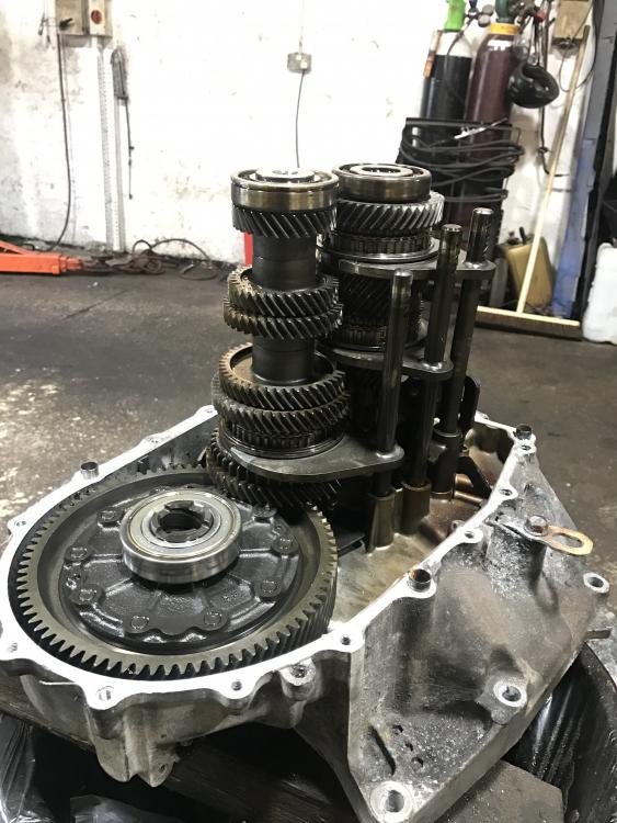

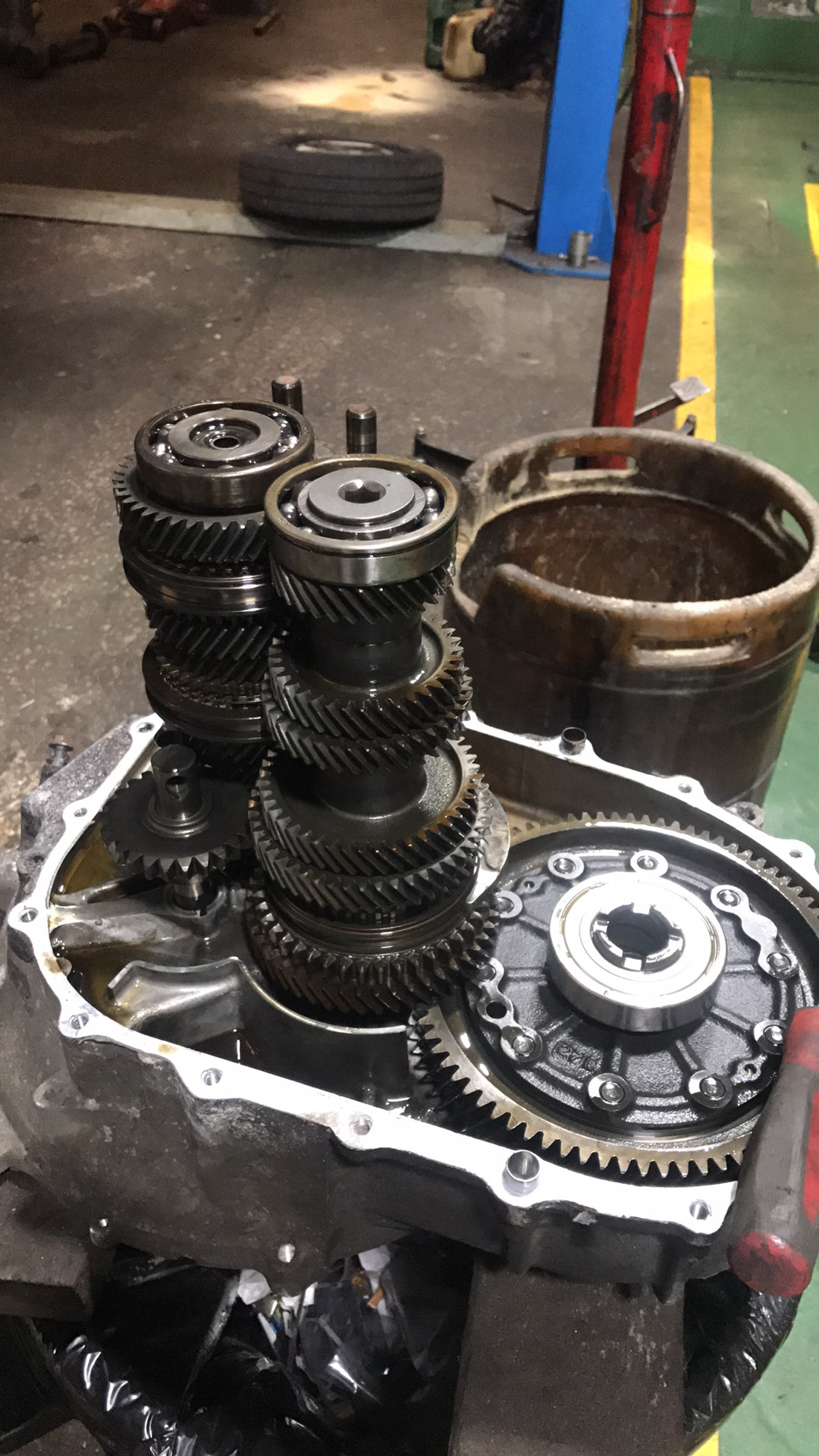

Got the box in bits this afternoon.
50:50 about it really. The gearsets and syncros/hubs look really good and the forks are barely worn which is a huge bonus for these boxes. The end bearing on the input shaft has been hot at some stage though and doesn't feel great, and the plastic "windage" ( if you could call it that ) tray that aids distribution of oil around the box has suffered as a result of the fire damage.
Recasing it into my old gearbox looks like the best solution. On the hunt for a diff now!
