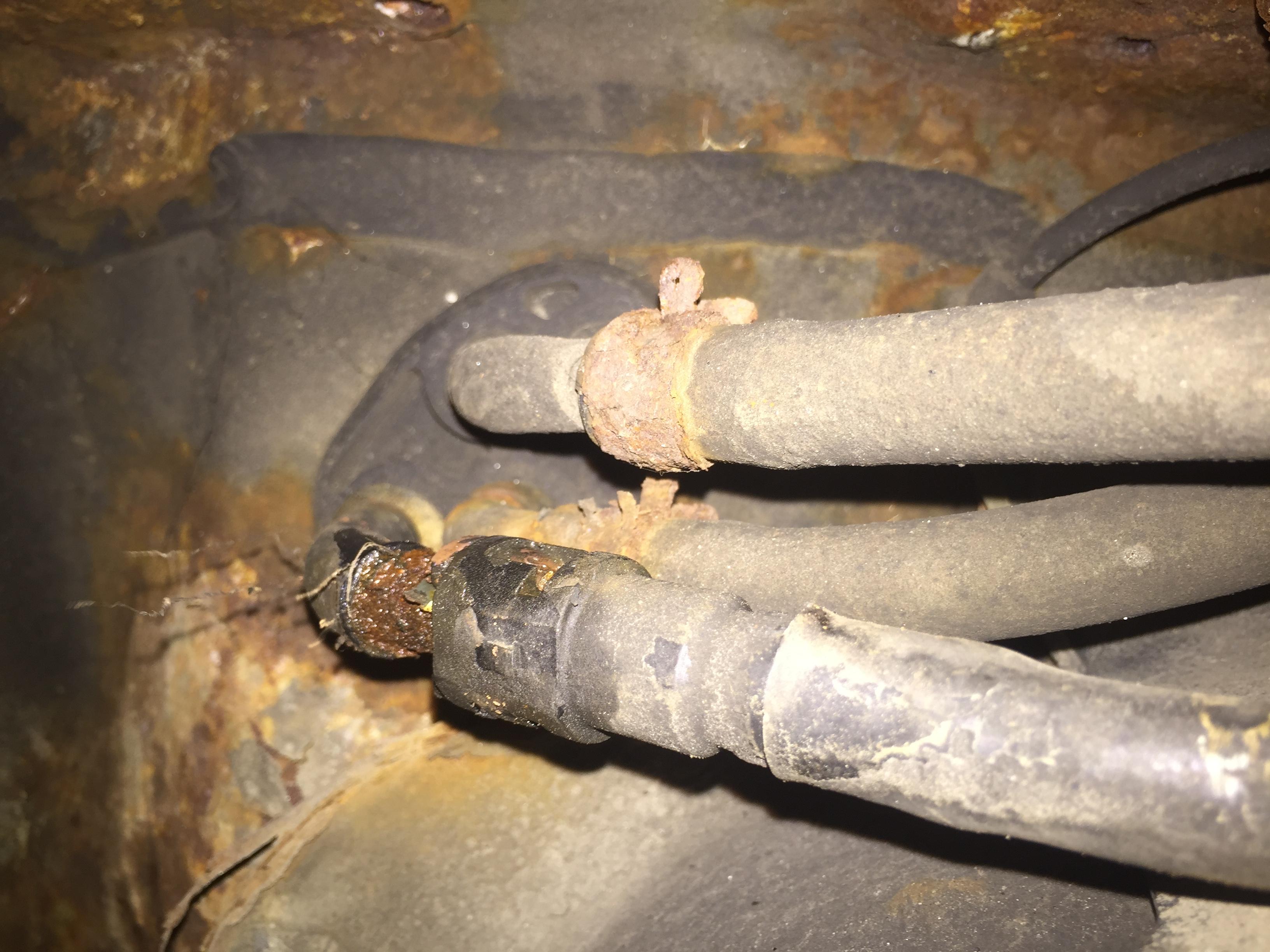

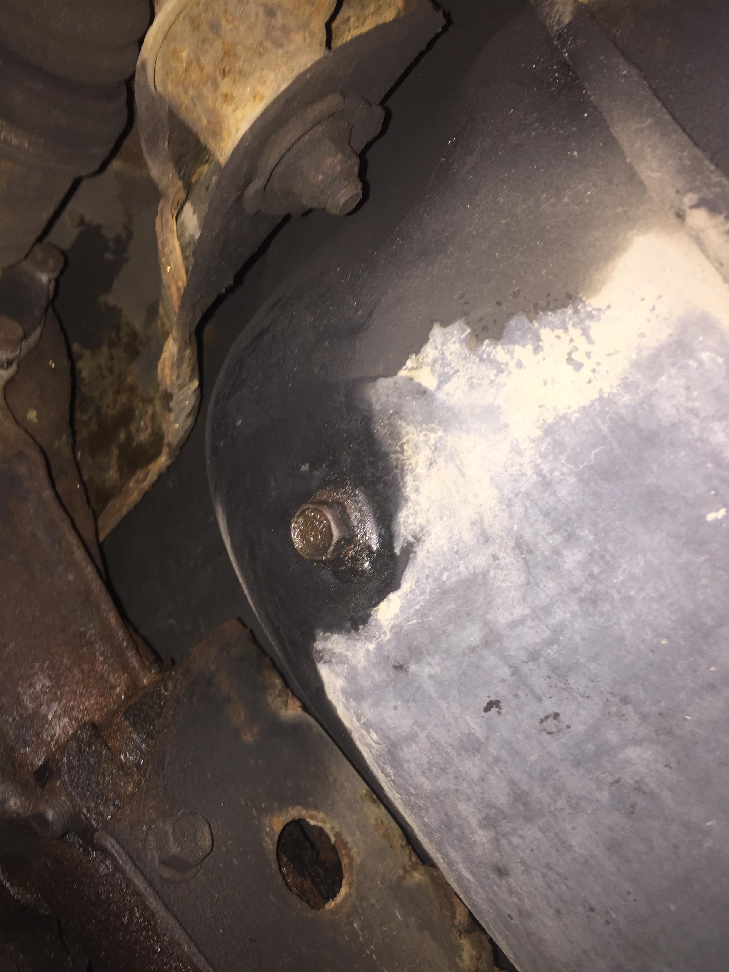

Right I fixed one fuel leak by changing the fuel delivery line but I put a bunch of fuel in and parked pointing downhill and the main leak has shown itself.
It's fairly accessible but it is leaking from the seam of the tank where it has corroded. Now I'd much prefer to not have to drop the tank and replace it as it is a big job on a forester and there's lots of rusty bolts under there while I'm also on a budget. Is there anything that I could use to seal it that anyone knows of from the outside? It doesn't have to look pretty I'm just looking for a cheap quick fix for my beater of a car.
We sell a fuel tank repair putty type product at work, the name of which escapes me but it does exist. Basically a fuel resistant 2 part epoxy clay type thing same as Knead It (probably exactly the same in fact but marketed as a fuel tank specific kit) that you squash into any holes and sets like metal (Y)
  • Like 1
Will that also do chassis rails. (i can only wish)
I got a load of Knead It for free, at present it's holding at least 2 exhausts together, the wing mirror on my van, rebuilt a coolant flange after I snapped it removing it, it's awesome shit I love it :lol: you can even drill and tap it once it's set!
