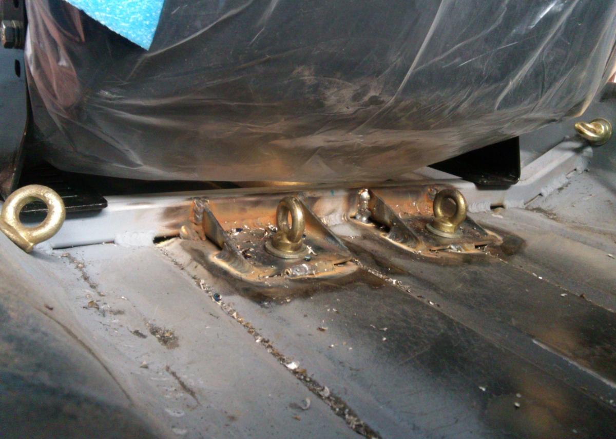

I made up and welded in some mounts for the crotch strap on the 6 point harnesses in the Mini I've been doing today, along with a little more cleaning up and contouring, then got half way through fitting the battery box and chased up some parts for it. Slow but steady progress.

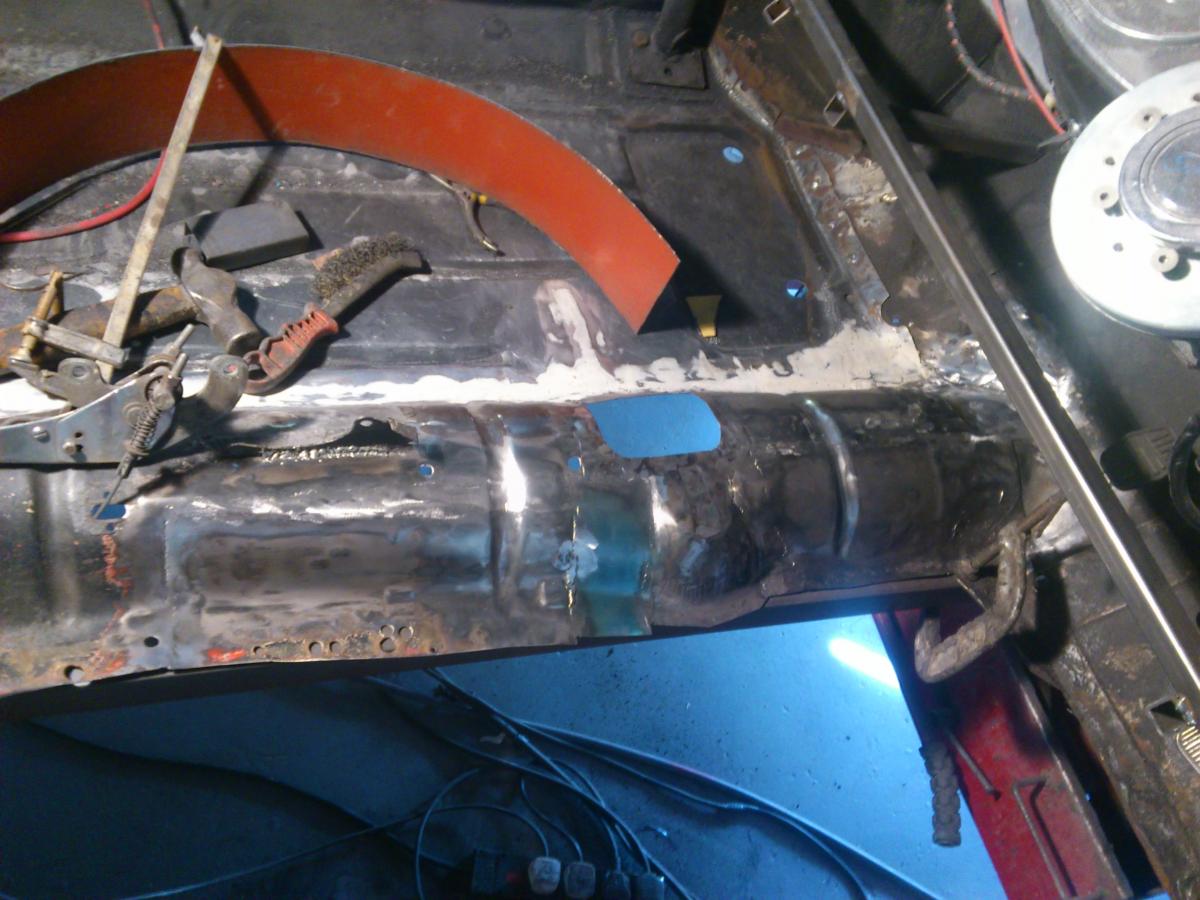

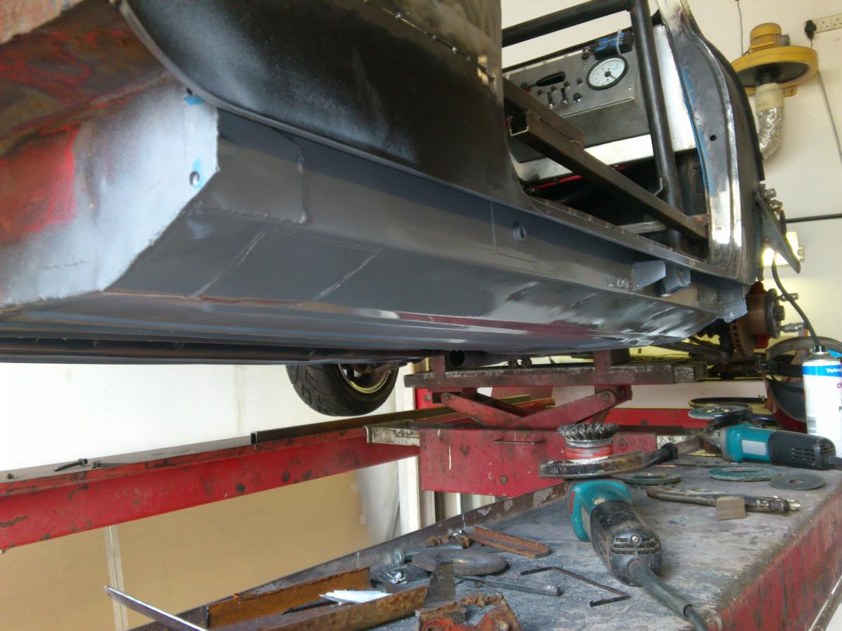

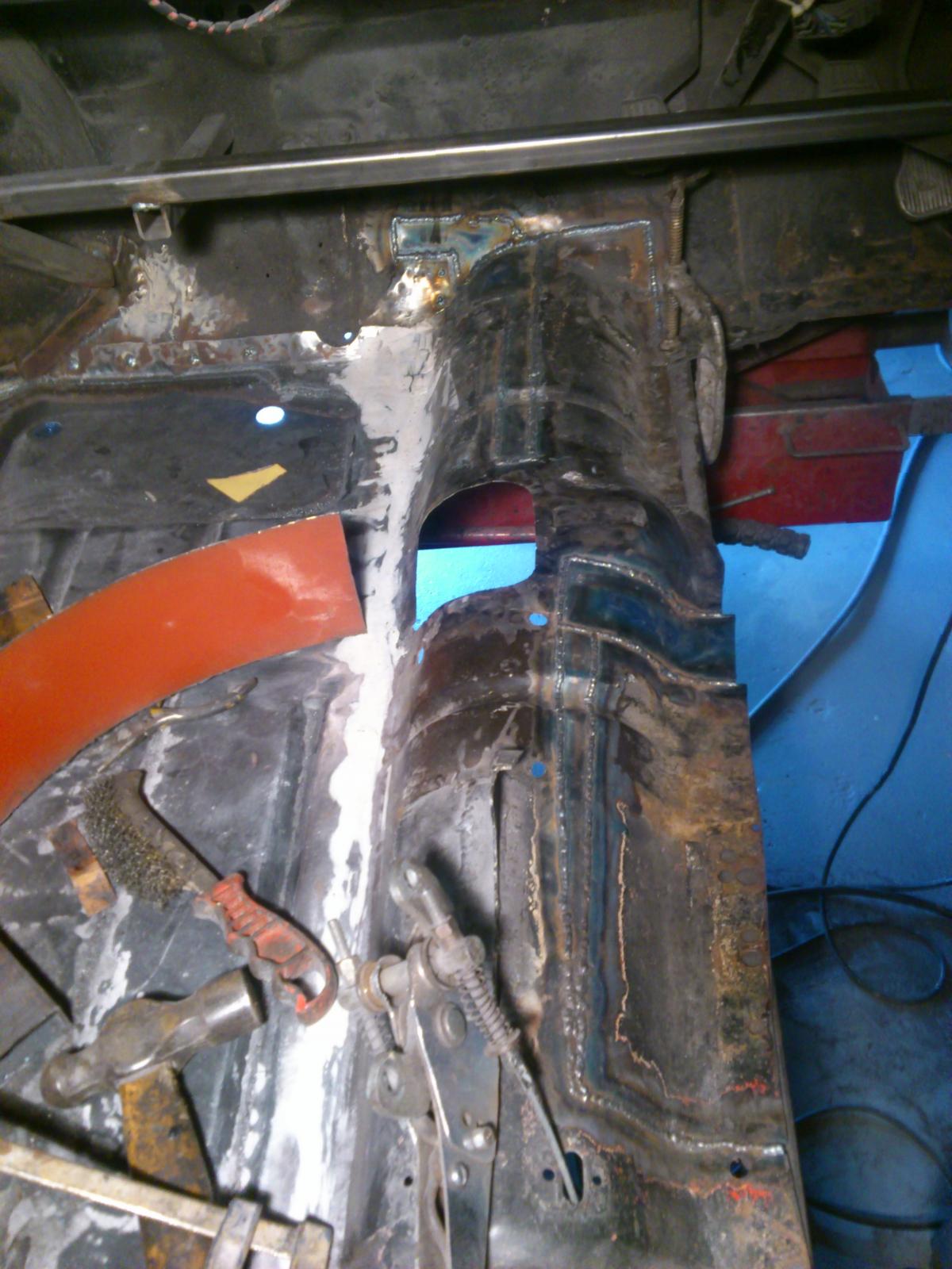

I keep saying I'll stick up some more photos of the mini I've been doing, so here they finally are:
Drives side metal starting to go back in, new doorstep, new floor/inner sill, fabricated jacking-point, rebuilt subframe mount:
post-4312-0-12607900-1346791581_thumb.jp

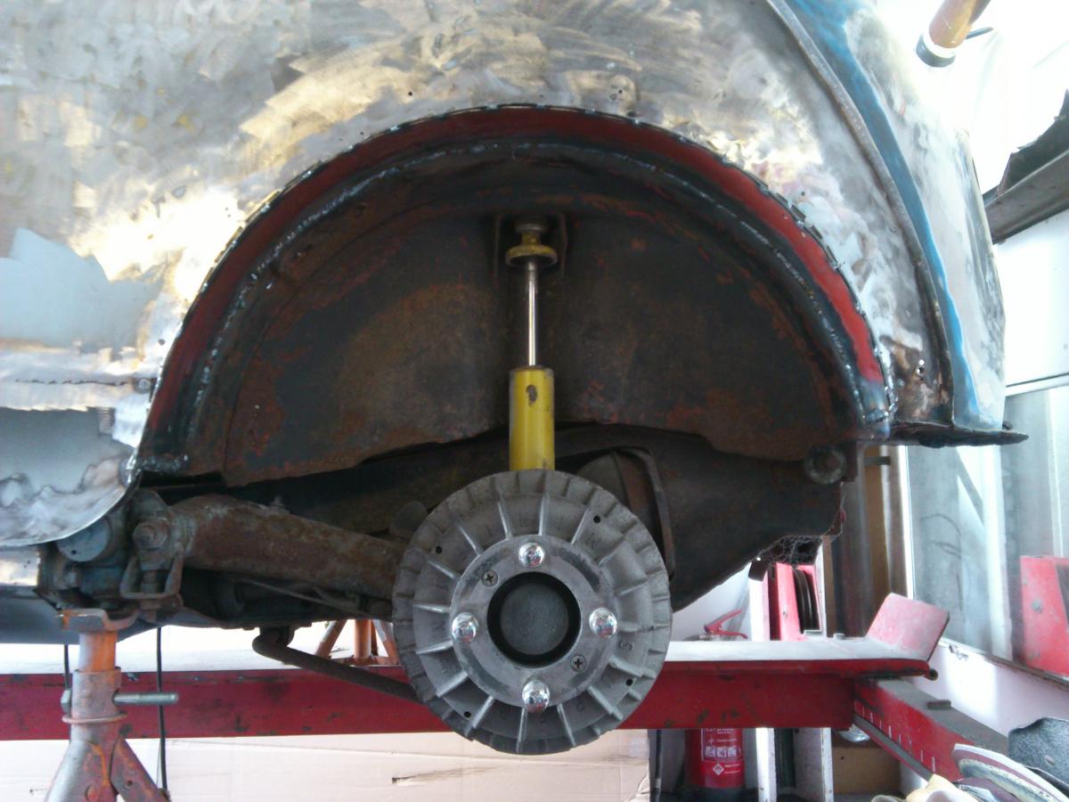

Rear arches tubbed:
post-4312-0-98710200-1346791331_thumb.jp
Tunnel widened to gain exhaust clearance around the remote shifter (you can see where about 1" extra's been added in the middle infront of the shifter, then tapering back to standard width after it):
post-4312-0-11259400-1346791168_thumb.jp
And all ground back:
post-4312-0-38856900-1346791247_thumb.jp

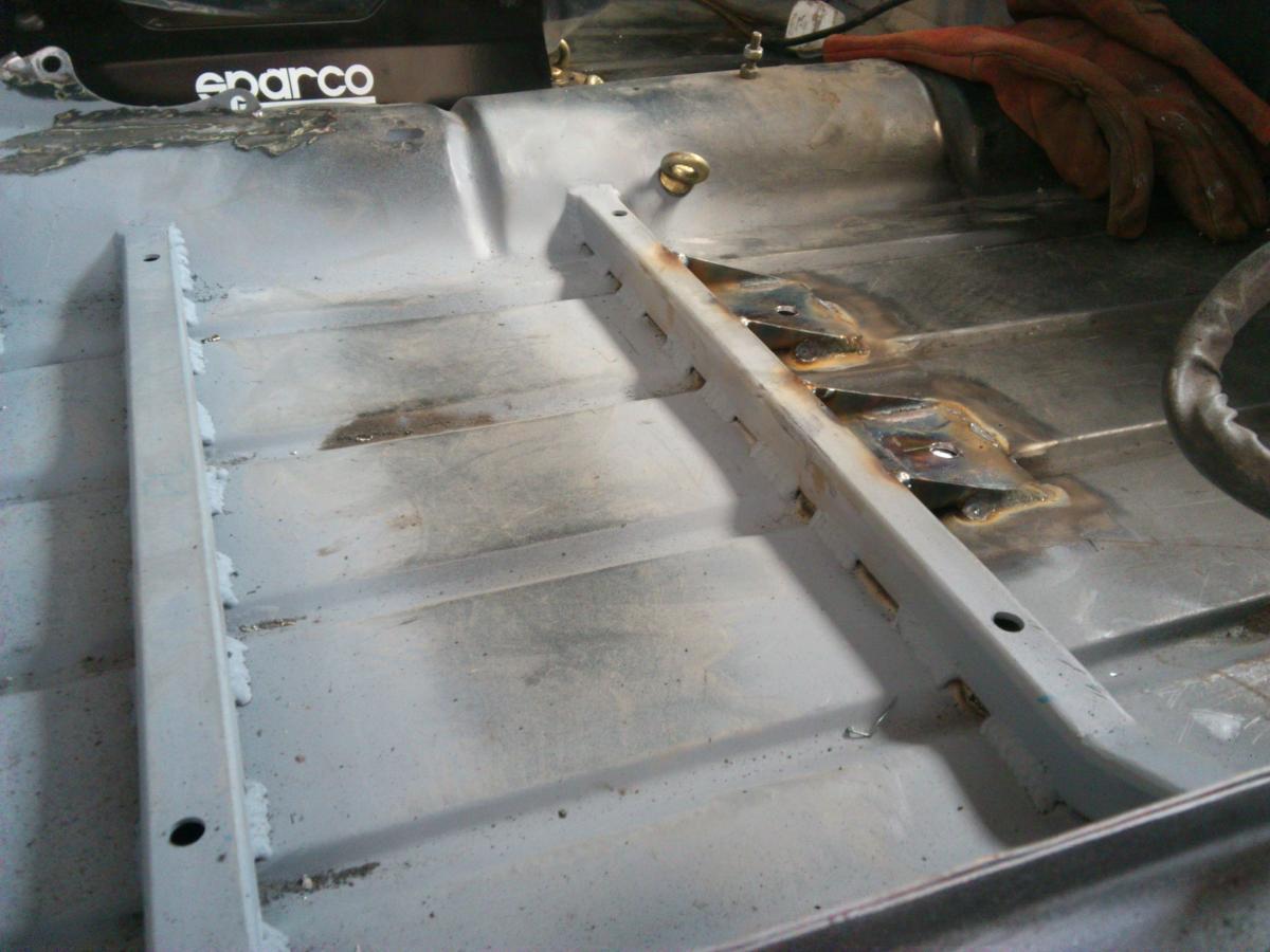

Seat mounts fabricated and welded in, including 6 point harness crotch strap mounting points:
post-4312-0-69748200-1346791641_thumb.jppost-4312-0-37136200-1346791733_thumb.jp

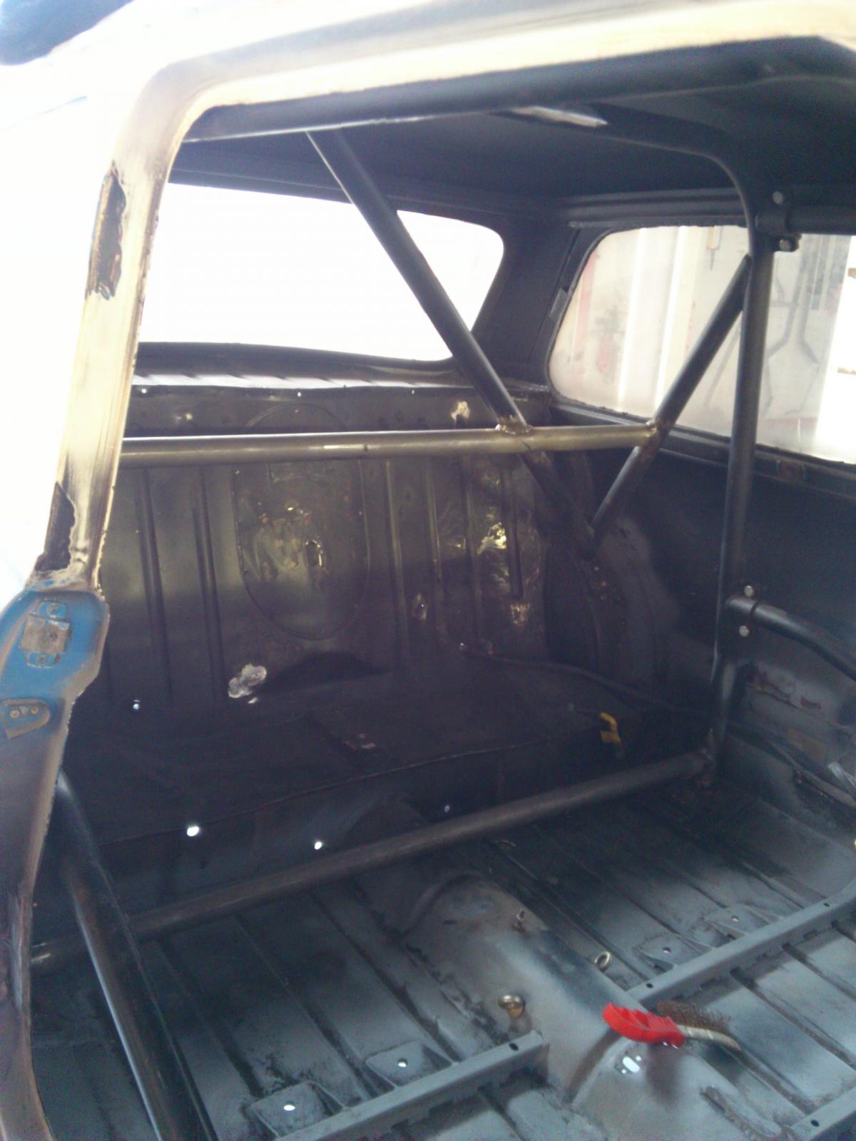

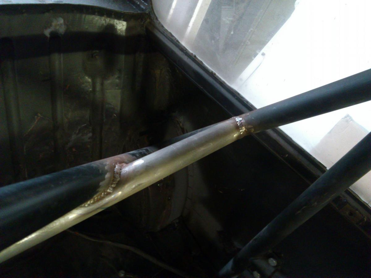

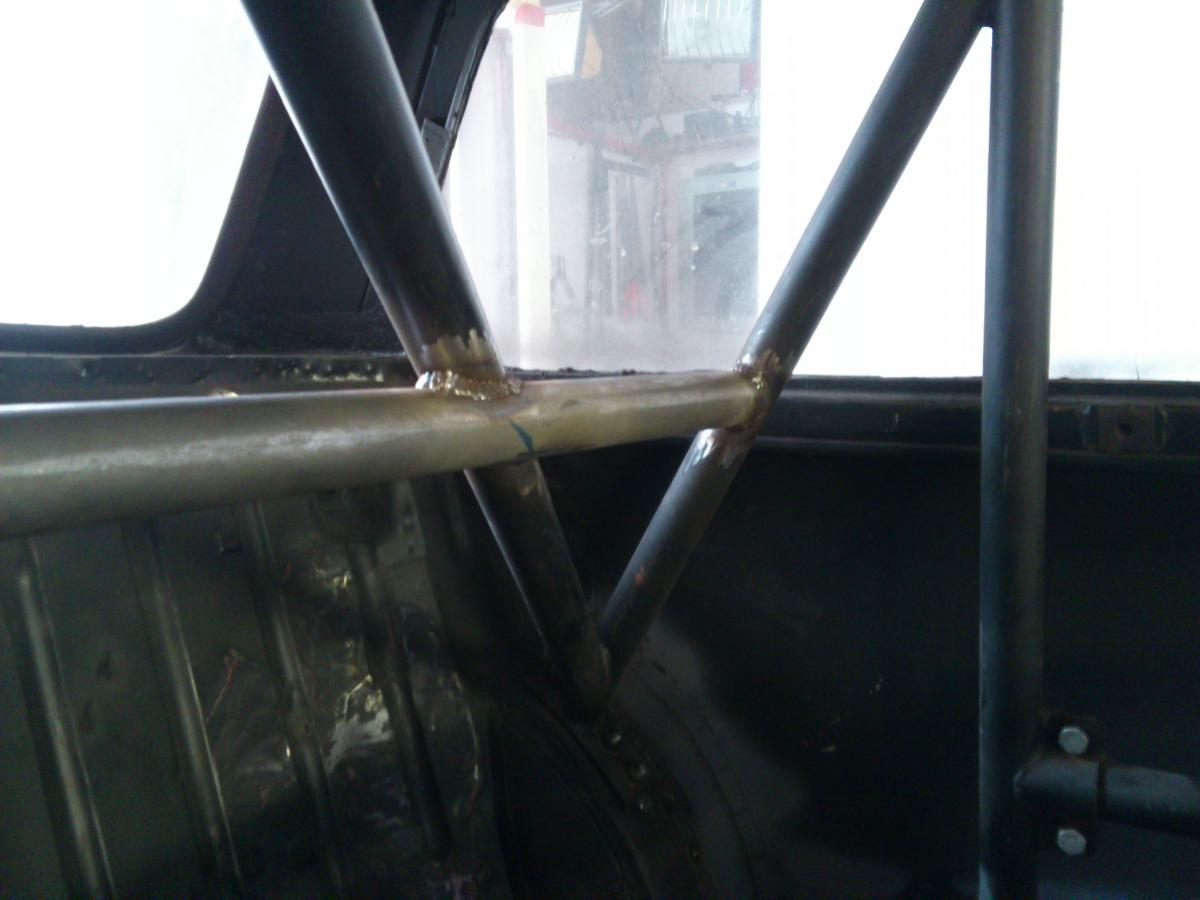

Brace across the base of the main roll-hoop and a harness bar added to the cage:
post-4312-0-47220000-1346791881_thumb.jppost-4312-0-06017700-1346791938_thumb.jppost-4312-0-16542700-1346791957_thumb.jp

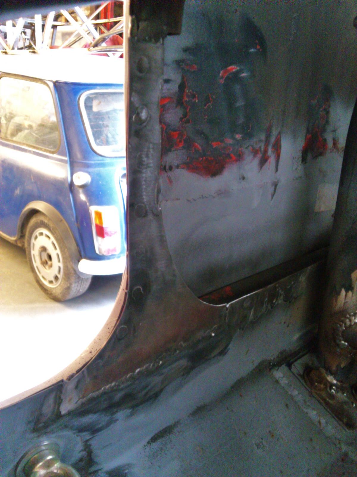

B-pillars reinforced where the door bins had been removed:
post-4312-0-48544600-1346791981_thumb.jp

Edit, Thanks Nick, yeah, the seats and harnesses bolt straight through the floor and box/plate, with a penny washer on the outside just for good measure, although it's not really needed it keeps things neat. It gets the seats pretty damn low, but the side mounts give a decent amount of adjustment to get it back up to a good height for smaller people.
