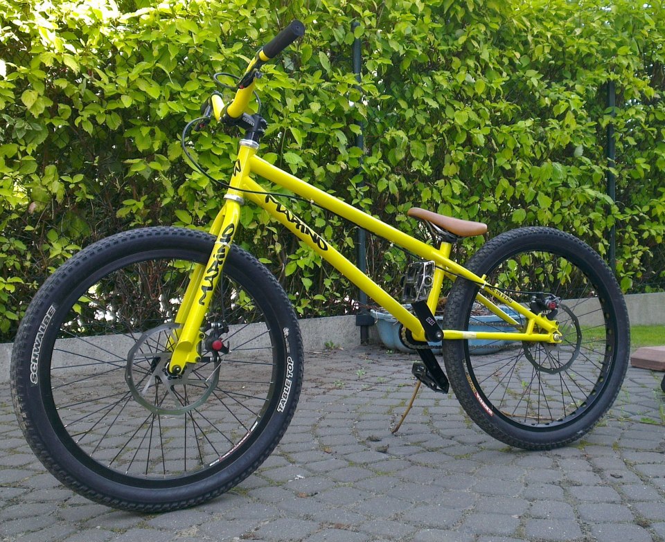

i couldnt stand all this new stuff aswell and sent my new order to my friend mr.alegre this minute.couldnt wait for that since i got my first one :dance:
44mm offset?? Noooooo, that's Pashley rake!
410 x 25 would be spot on.
with a ha of 73° 44 is spot on(edit:for me,made me think it over about months),going trialsier this time...
Edited by FamilyBiker
tell me what you mean ali...
everyones different,i wanna go the way the old fourplays were(plus 15 bb more),if i switch forks to my 30mm rake ones,i´d go streetie(1020 wb),but my 990/+25/365 frame i got now is way too untrialsy for me.
the bar angle and components are not taken from real life though...
heard of someone whos going for 980 wb(we all know him,from here at least)
thats strange for me,without offence :wink2:
