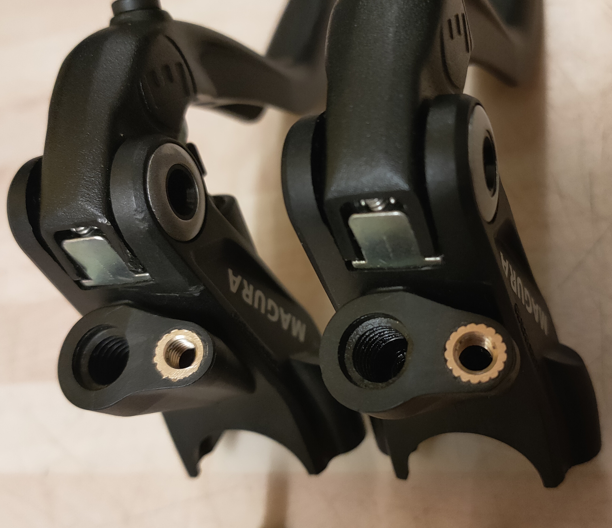

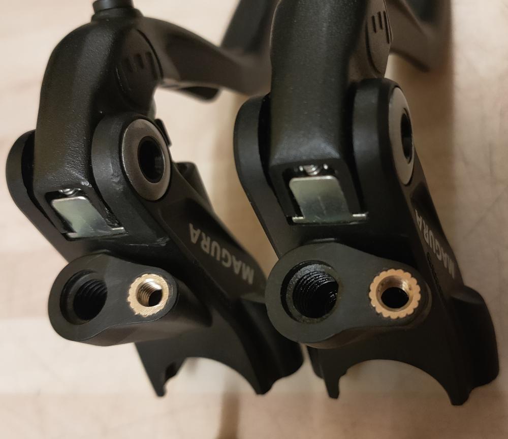

Ok, the fu**ing plastic bleedbolt on my magura hs33 just got broken. Brake was abit sloppy, so i decided to get a quick bleed but the plastic bolt was stuck as hell. the head went of but i managed to loose it with a screwdriver.
I am still able to get it in and out, so the brake is fine for now, but next bleed im afraid i have a problem.
I cant find this bolt in tartybikes brake spare range. I cant even find a picture of this bolt online.
What to do?
They're horrible, really bad choice to make it from plastic!
The T25 torx cammed out of mine and chewed up the head, managed to bodge a T27 in there and that seems to work, as long as you put ZERO torque onto it you should get away with it.
