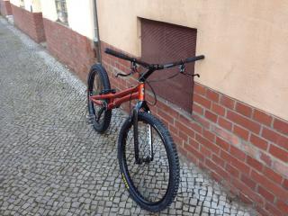

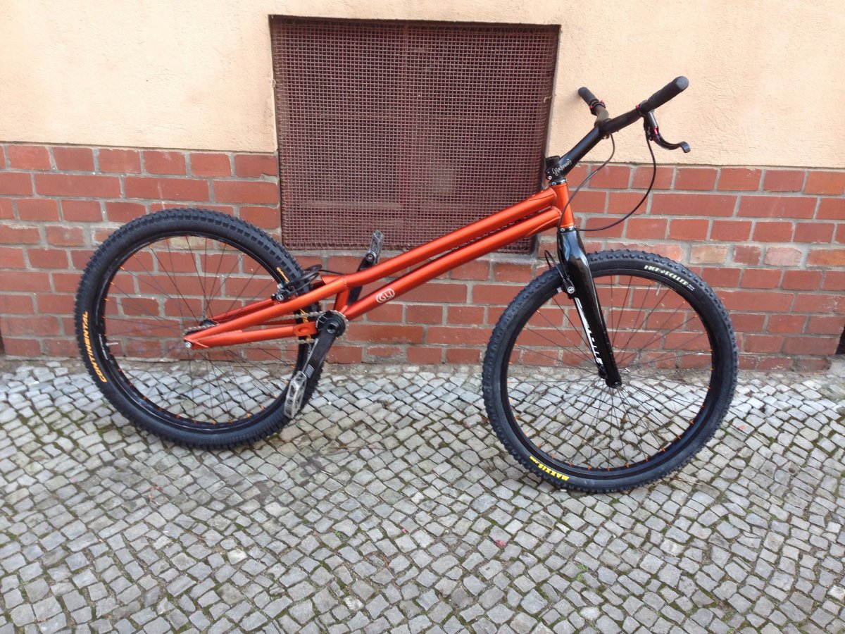

Even though it's not ready to ride yet, I thought I might share it with you. Things I still have to fix:
- trimm down the pads on the front brake (or use offset mounts) as the rim is too wide for these forks
- Put Echo TR cranks on as they have more offset as the Try All and won't hit my Magura slaves
- grind these rims
- put some ptfe tape on the bleed bolt on the (new!!!) Racing Line Nano lever to stop it from leaking
- fix the brake lever angle
post-36046-0-20958700-1423430322_thumb.j
post-36046-0-29535200-1423430332_thumb.j
Edited by niconj
  • Like 1

Almost done. Just have to get some 175mm cranks and will have to change them old wellgos. Trialtech rims had to go as for the front it was too wide and on the rear the Echo just performs better brake wise with the Trialtech pads. It's actually 100% better than with the Trialtech Rim-TNN ADM pad combo.
Weight penalty on the rear with the Der Kaiser Project tire. I could actually save 250gr. just by changing to a Try All Sticky Light tire but who actually cares...
8.8kg
