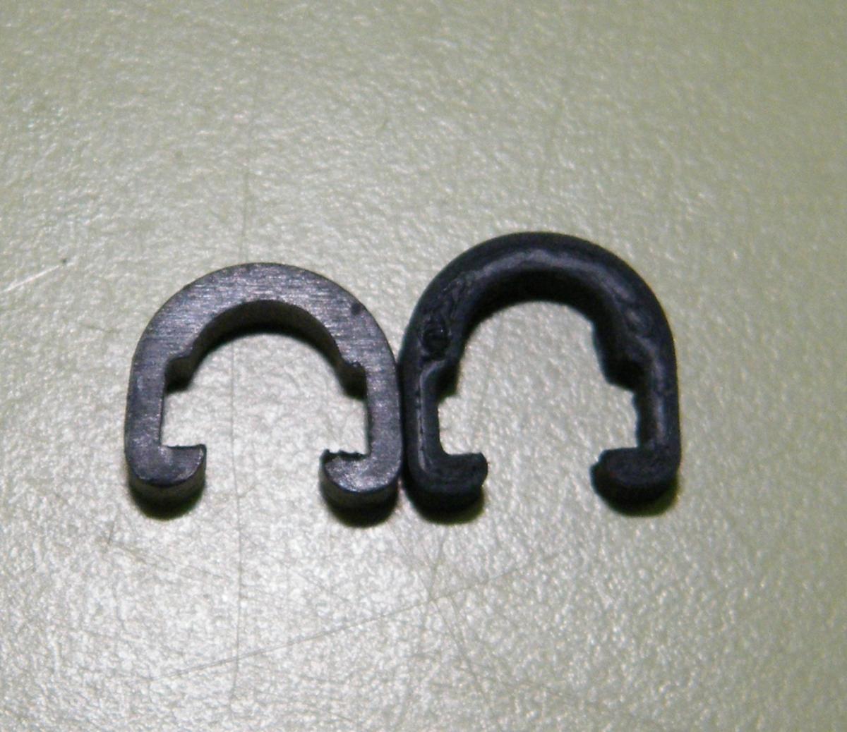

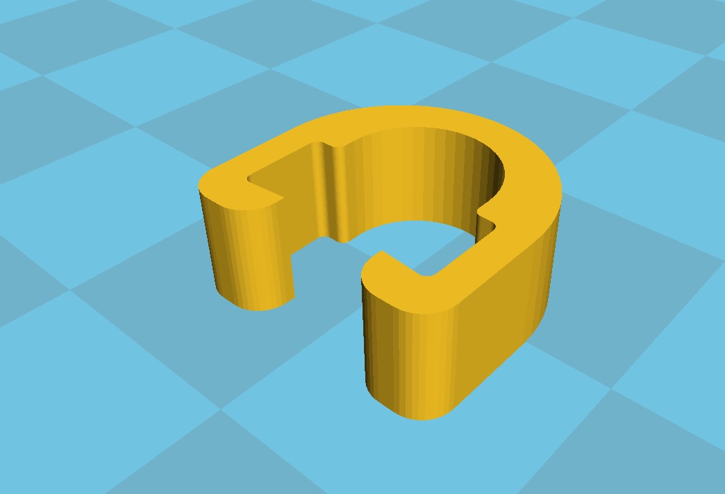

Besides the usual printing test pieces and robots my first 'useful' print has been some U-clips for the Arcade because for some weird reason the cable guides on the frames don't seem to work with standard clips so I've been using zip ties for the past 18 months...
post-1823-0-76995600-1441183290_thumb.jp
post-1823-0-14442700-1441183420_thumb.jp
And next to the original one.
post-1823-0-22939500-1441183429_thumb.jp

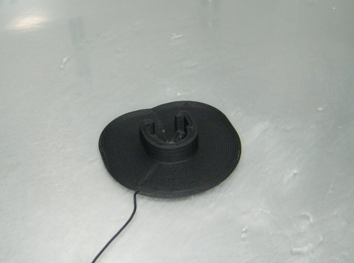

No haven't really played with that side of things yet. The PLA seems to give a pretty good surface finish from the machine but the ABS gives very visible lines and a somewhat rough finish so need to mess around a bit. One other thing I'm struggling with when using the ABS is the edges of the build 'rolling up' as it cools and lifting away from the build surface and then becoming detached and screwing everything up...
Isn't the rolling up why the build surface is heated? Plungers look slick. What's the difference in strength between pla and abs?
That's what you'd think! For ABS the build surface is at 88 degrees I think but it still curls up. The default settings are to have the head cooling fans at 50% for ABS and there are some people online who say to reduce that as much as possible for ABS which might be worth a try.
In theory ABS is a bit stronger and less brittle but to be honest I've been fairly impressed with the PLA so far anyway so may end up just sacking the ABS off if it's going to be a pain.
