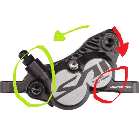

Brake calipers aren't designed to withstand rearwards forces, let alone shock impacts from landing backwards with the wheel locked :)
Pretty much although I guess some calipers will be stronger than others though.  Essentially if you're using the caliper backwards it's putting forces through it that it was never really designed to withstand.
Look at the attached artistic impression, the green arrow is the normal direction of forces through the caliper, note the large amount of the body in compression (inside the green circle), the red arrow is the backwards direction of forces.  Now consider the relative amount of material in the red circle compared to the green.  I'm betting the caliper snapped on the rear most mount in the red circle :)
Yup that would figure, the fixing is holding the bolt slot in compression (how castings like to be), the flex (what castings don't like) would then be introduced in the span between the post mount and the main body, failing at the stress raiser which is thinnest section at the bolt hole.
