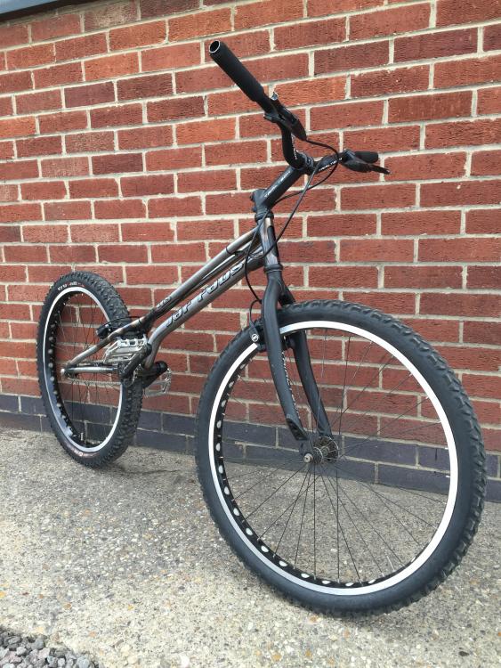

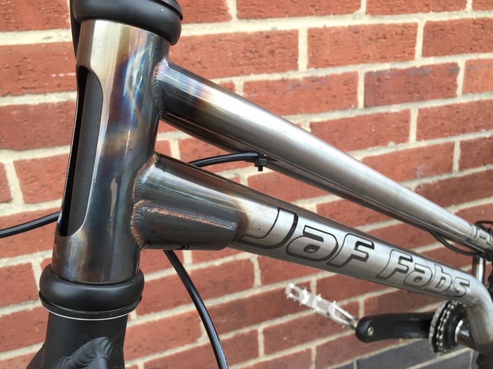

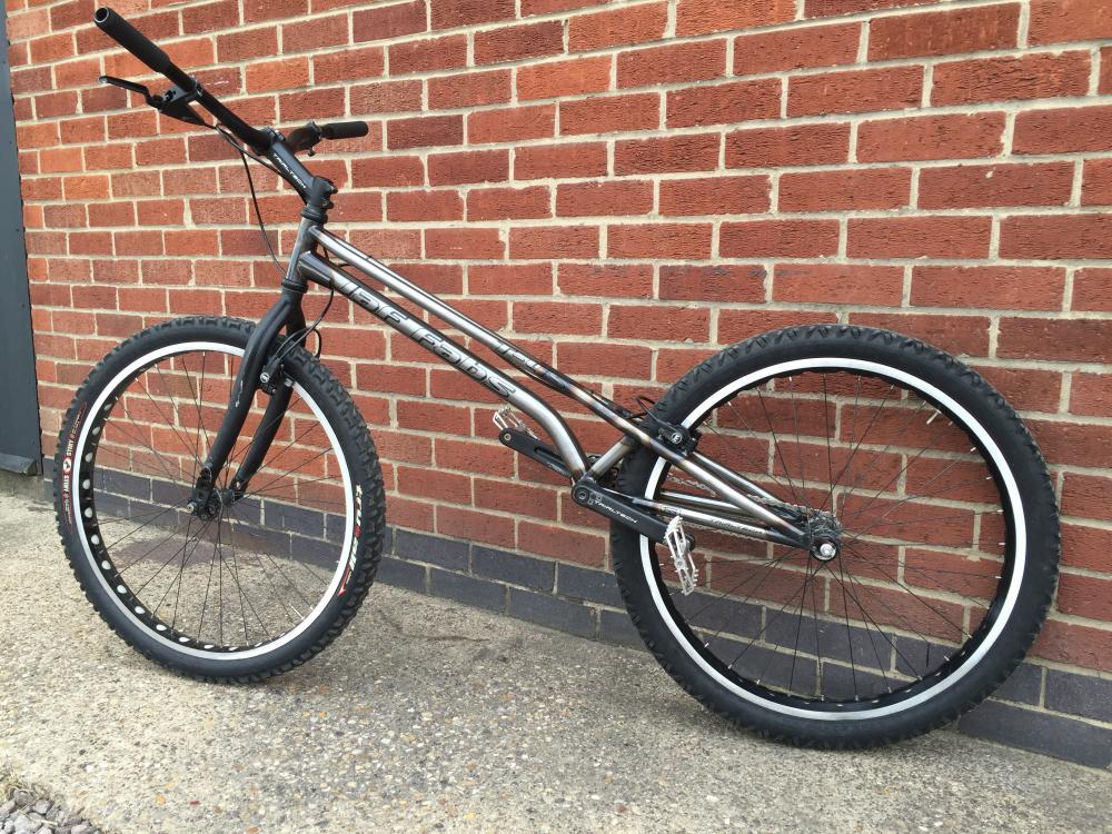

New frame time again.
JoshLeech
12 hours ago, Stanners said:
Can I ask where you get your tubing from? What thickness('s) do you go for?
Yeah, sure. I used Aerocom metals - http://aerocommetals.co.uk/pacesetting-alloys/
They were easily the lowest cost compared to other suppliers of T45.
In terms of thickness, I over-did the downtube (38.1 x 1.6) to ensure my tube bender could handle it, but looking back, I think I could of gone down to 1.2 with no issue.
The top tube/chainstays were 1.2 (22.2 dia) and bent with no hassle.

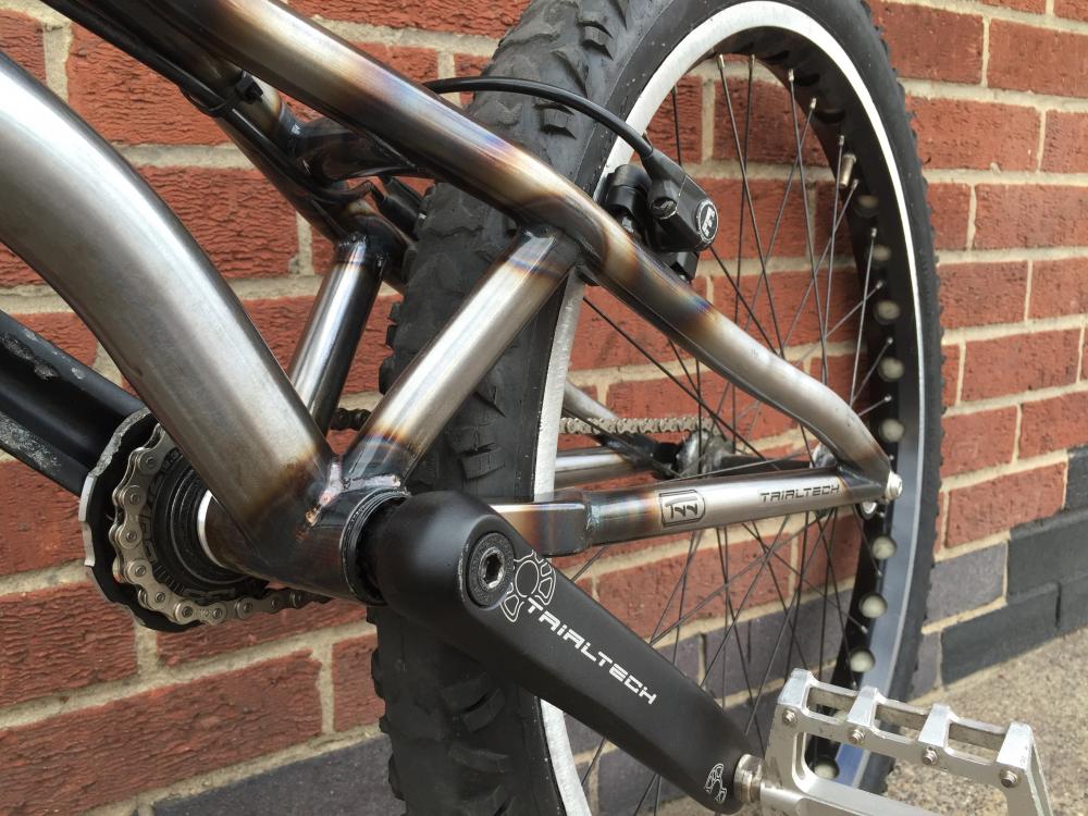

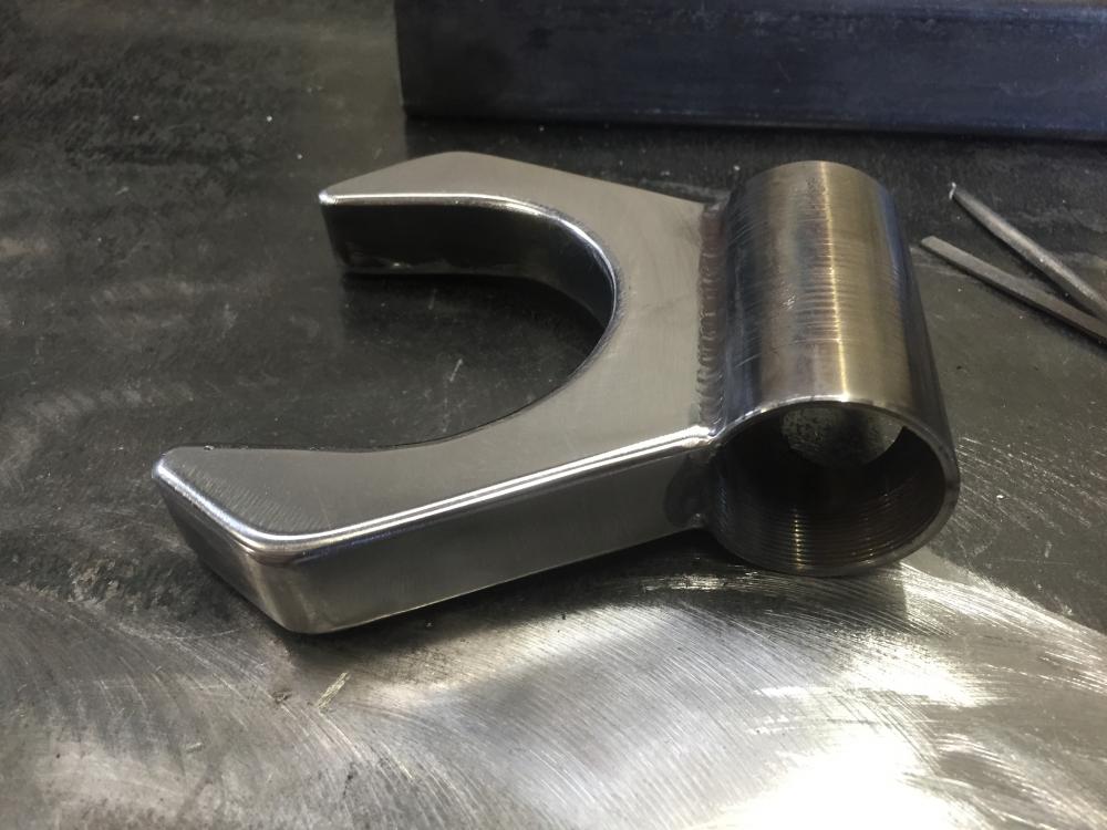

2 hours ago, Paperclip said:
Looking real good. Love the top tubes following the whole frame down to the dropouts. What design did you go for around the bb yoke?
I went for a pretty simple 3 piece. Worked out quite nicely and seems quite stiff at the moment.
  • Like 7
9 hours ago, Rusevelt said:
So clean looking. What's the weight, geometry, and cost?
Heavy, just over 3kg.
1065, 73 deg, +67, 377 stays (at the moment, will open up once the chains sorted itself).
A lot. Mostly spent on tooling up for the job, but the T45 came to just under £300 to start with.
The old mark up was between £120-180 if I remember rightly. Not great for 2-3 days work plus the design stages when your a self employed fabricator unfortunately.
