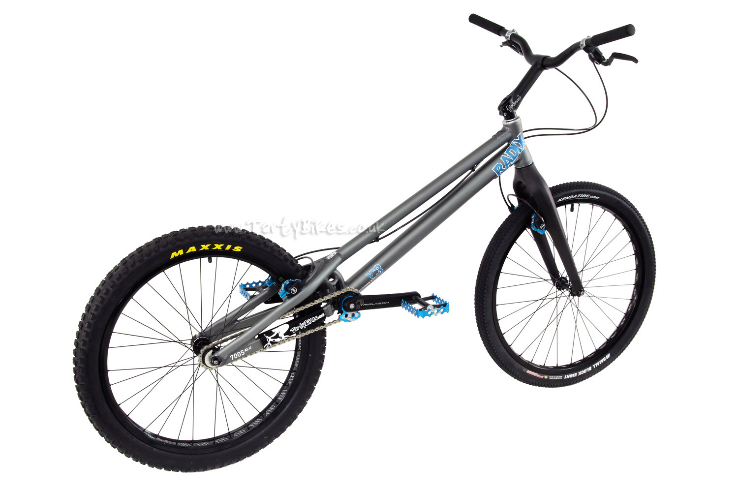

On 4/11/2017 at 7:16 AM, Mark W said:
We just threw one on this bike:
I gave it a check with our durometer tester and it appears to be Super Tacky compound across the full width of the tread with the sidewall casing/carcass seemingly being harder.
That's a pretty looking bike!
Good to hear about the durometer. :)
