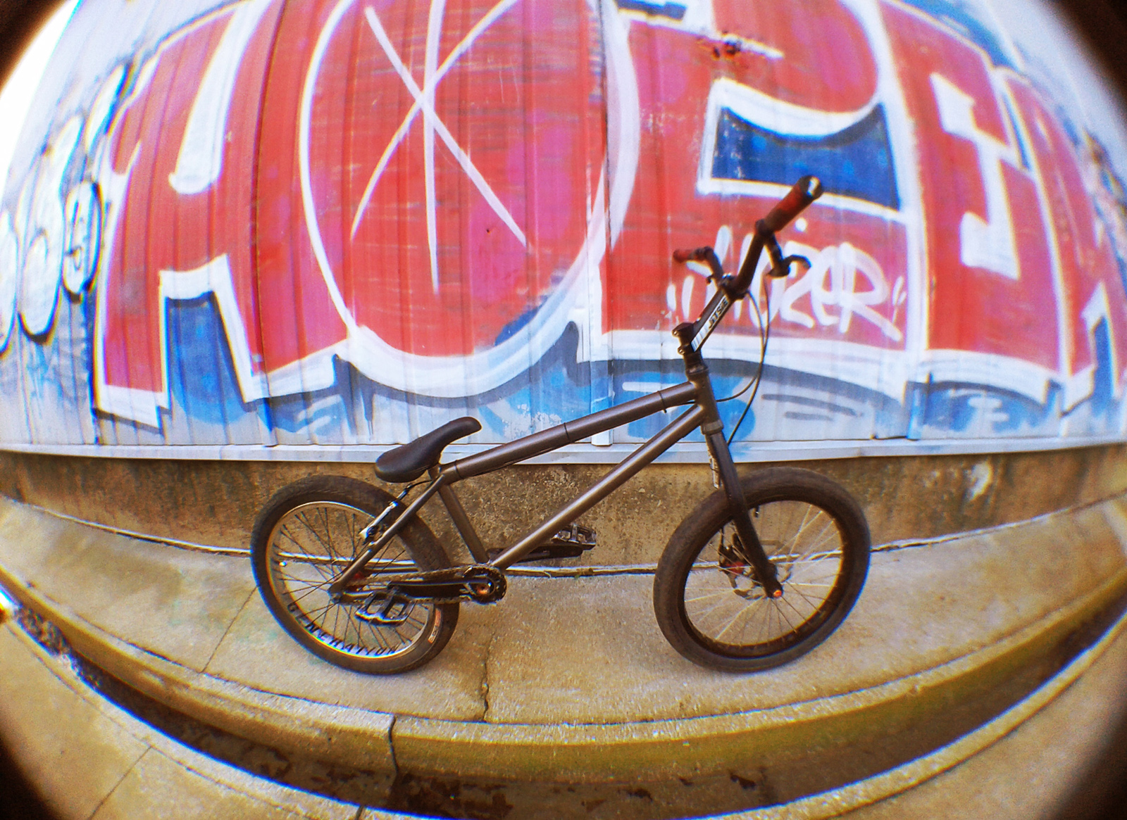

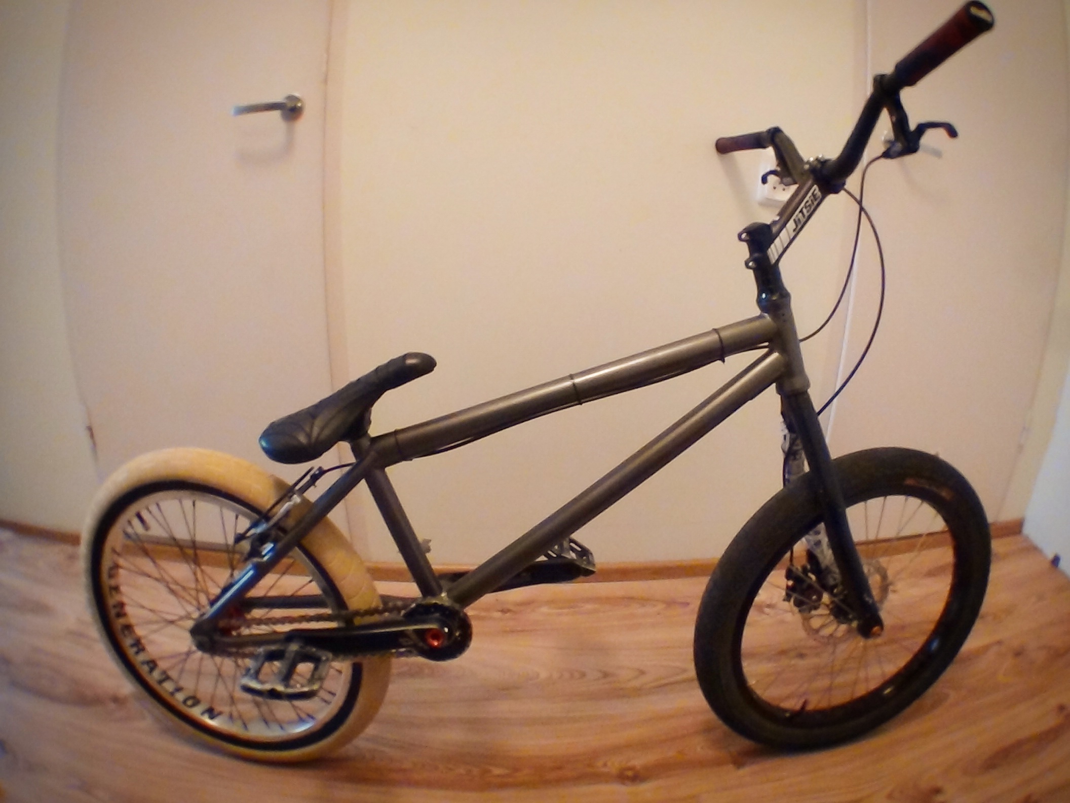

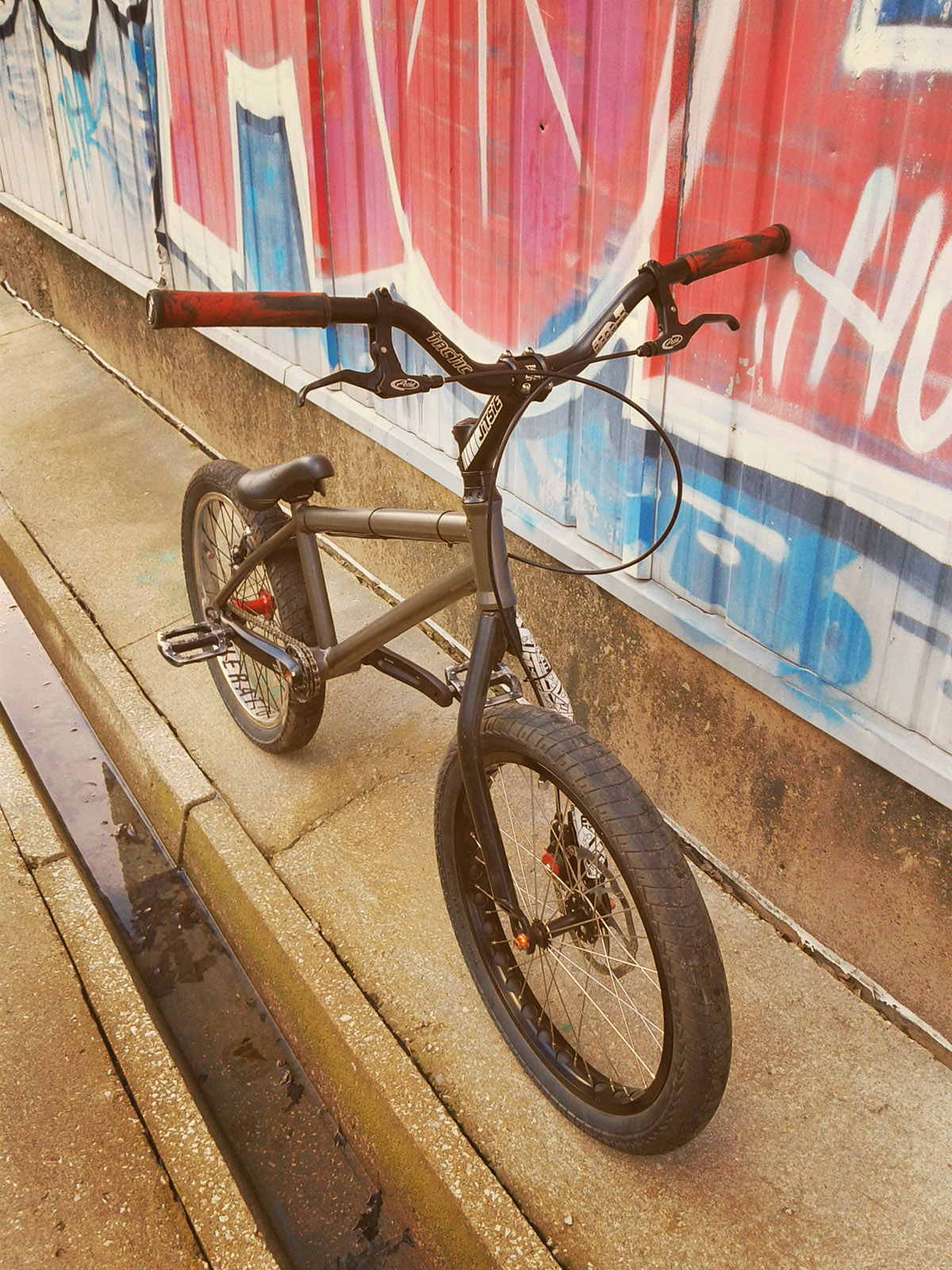

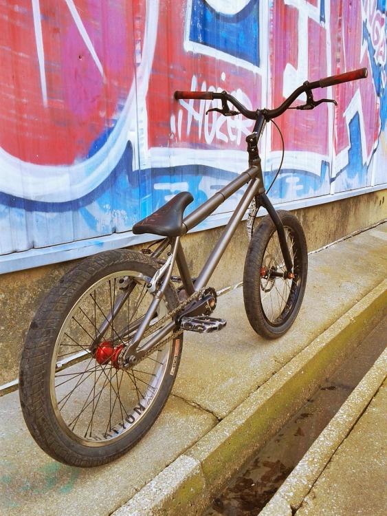

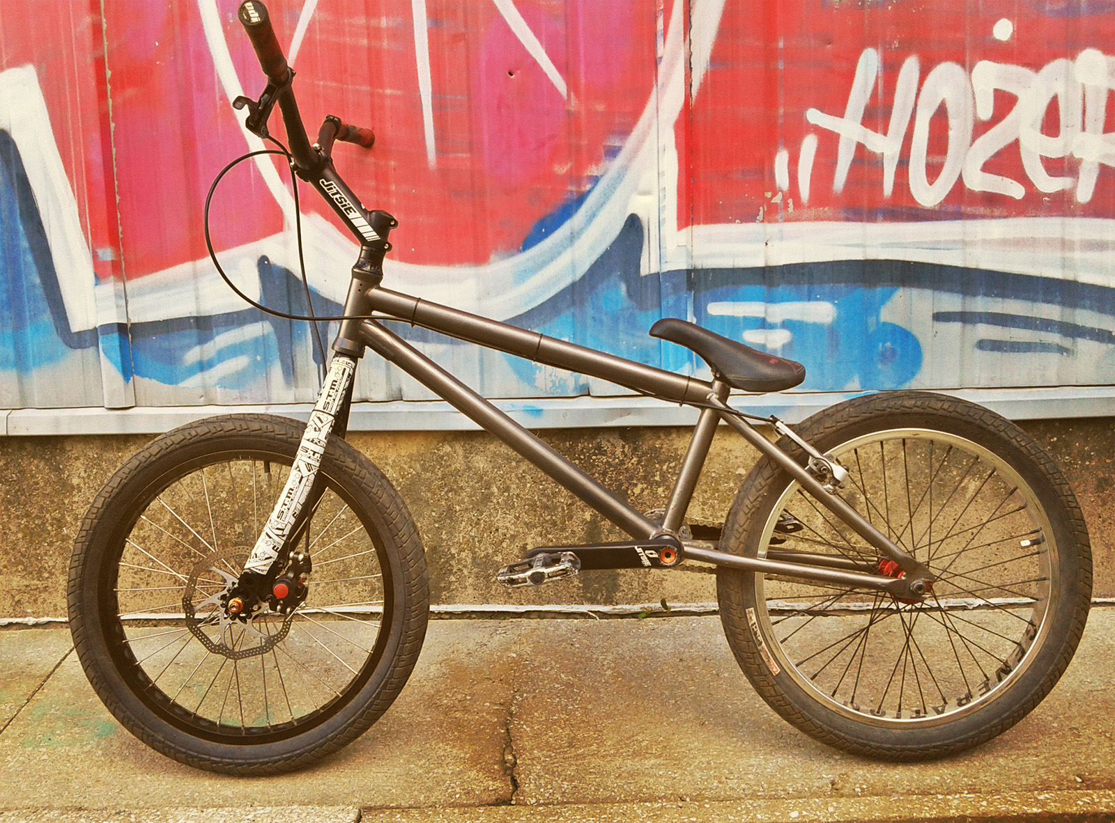

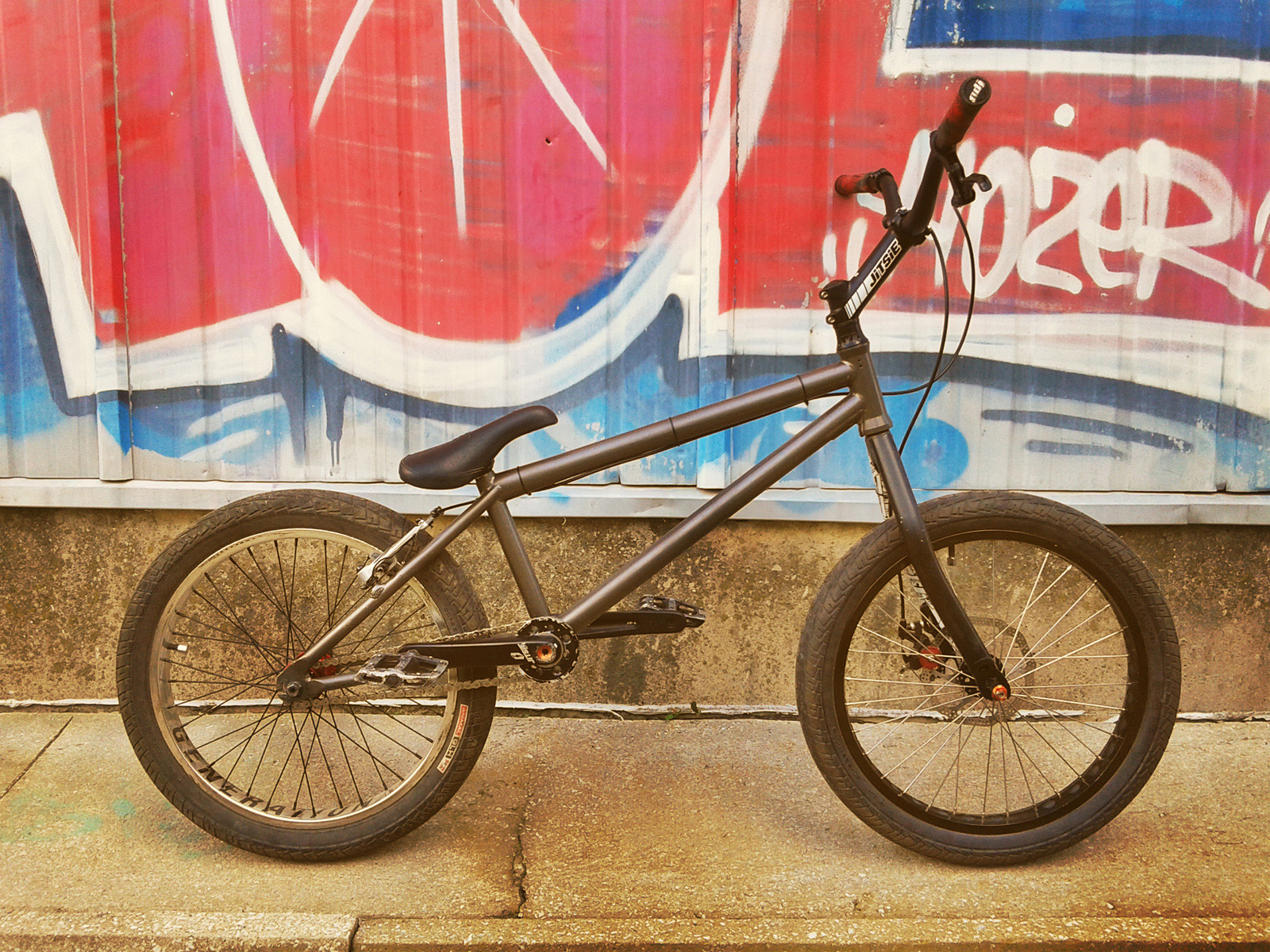

Back in the days when I rode trials I used to f*ck up my bike in by beginning of a new season.
This year I am glad to start with a "brand new". For a long time I had an idea building a mod that
would have advantages of a bmx bike on the streets, but was still suitable for some trials jibs.
I was not sure what geo and parts it should have, so build it as an experimental bike.  After testing it
for a month I can say that I reached my goal. I can do things (on same level) that I did on a my mod bike
9 years ago, plus I got a bike with pretty close geo to my bmx. B)
Frame: Haro (wb 940mm, cs 340mm, bb +65mm, 580mm)
Fork: Echo Lite
Bars: DaBomb Tactic 690mm
Grips: BoneDeth Burning Rubber
Levers: Avid
Cables:Odyssey
Barends: Odi
Stem: Jitsie 135x35
Headset: Integrated
Seat: Mongoose pivotal
Seatpost: Macneil nub
Cranks: Jitsie 170 mm
Cog: Trialtech 18t
Bashring: Handmade, Alu
Chain: KMC 710
BB: Echo ISIS
Pedals: Eclat Alu
Front wheel
Hub: Echo
Rim: Echo, Single wall
Tyre: Animal GLH 2.25
Noname tube, Eclat rimtape
Brake: Avid BB5, 160mm
Rear wheel
Hub: DK Megawatt, 12t (120 engagement points)
Rim: Blank, Double wall
Nonename tube folded in another tube.
Rimtape: Blank.
Brake: Shimano
Pads: Salt Propeller
Edited by zhenya

On 27.4.2017 at 6:07 PM, Ross McArthur said:
Think it would look better without the graphics on everything. Cranks, stem bars, levers etc......and that news paper wrapper on the fork, what's that about?
I am not sure about those black and white stickers on fork, but I like graphics on the other parts.
On 27.4.2017 at 8:23 PM, Yorkshire Dale said:
really like that just wish it had and hydraulic front brake cos those bb5s are poop :( x
After smashing a rotor today I had same thoughts about all disc brakes :D
I would glad to ride with a v-brakes on front but ain't gonna buy a new fork -_-
