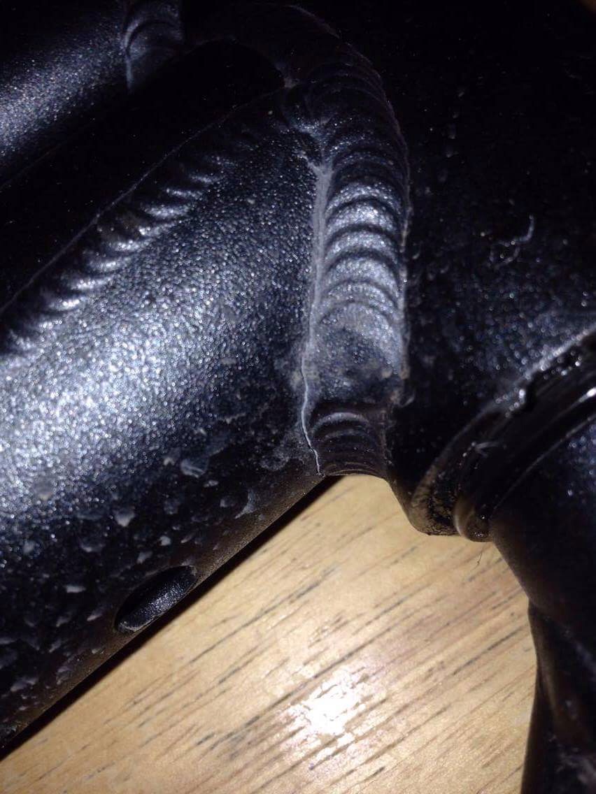

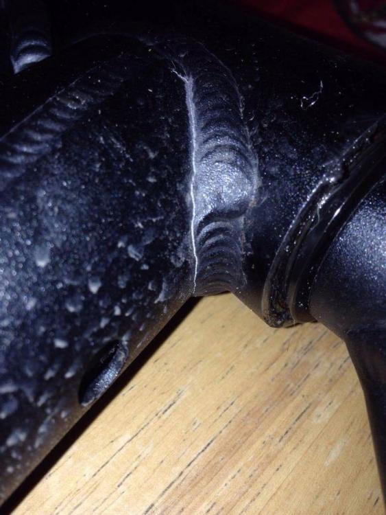

So the crack is showing around the gusset behind the head tube, which is unusual for echo as they usually go at the bottom of the gusset.
Would the crack be under the gusset too, on the frame? Who knows.
Would you still ride it?
Edited by Ross McArthur
Aaron just snapped/cracked a third frame within nearly a year? In my experience getting it welded causes heat around the new weld to weaken that area and it will not last. Even trying to put in a strengthening piece in will not work as the loads are just transferred to an area weakened by the welding.  It can also twist the frame if not jigged when welding a major area. I am no welding expert but in the early years when we tried to get welding done it never worked. Big thanks to Tarty for sorting us out a new frame so quickly.
