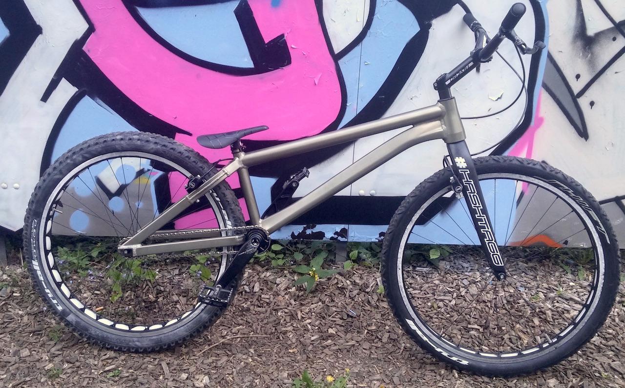

I Made a Comp Frame With a Seat
stirlingpowers
To avoid this, I made this:
large.trialsMtb.jpg.d5503941d5126cdd9283
72, 1080, +60, 1,5", many ideas of David Hoffmann in this frame, the usual painfully branded comp trials parts

The way the top tube and forks are at almost a perfect 90 degree angle to eachother looks f**king mint. It feels like I'm looking at an alternative future of trials if the seats stayed. Awesome!
Thanks! I'd reckon that I live in this alternative future now. We might also be working on some other kinds of alternative futures...

28 minutes ago, Ali C said:
digging it, however I'm not into that curve in the downtube, I like how it still looks more like a bike now :)  Had a similar idea to do a seated comp style frame myself at some point
The hex with a 90x10 stem and rolled forward highrisers does it well. Early 2000s era.
9 minutes ago, Ali C said:
I did enter a comp on my hex and it coped pretty well but the short wheelbase does have it's limitations on bigger comp moves
I was there mate. Bracken rocks a couple of years ago. Watching yourself, Carthy and Andrei Burton trying to get up that big slab when the comp had finished
I used the Hex as a test mule with comp parts last autumn. However, the wheelbase and the low BB made it a bit sluggish on the backwheel. That's why this thing in the photos above exists.
Also, I wanted to advance on some construction features. The curved Kloud-style down tube is for my individual style preferences only.
