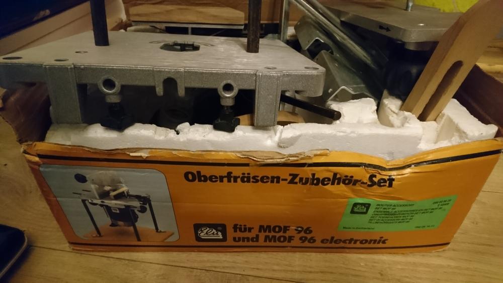

Talking of router tables, I forgot I bought this for a tenner a couple of years back, obviously designed for a 1/4" router but I reckon I can probably rig mine up to fit.
There's the same kit (albeit in slightly better nick and more complete) on ebay for 120 quid! Think I did ok with it, it's got the table, fence, sprung wood holding pushing guide thingy and a bunch of other bits I have no idea how they fit :D

Picked up a smaller router, a black and decker kw779 of ebay for 20 quid, it should fit the elu table I have and will be a bit more handleable than the big erbauer. It's only 1/4" but should be fine for the smaller jobs.
Will make a table to fit the erbauer, been offered a 1200 square oak worktop for nowt that I'll use part of to make into the table and use the rest for shelving. With a bit of imagination I can use the fence and accessories from the elu table.
Glad you are making a proper router table, the Elu one has such a tiny surface to work on! I would use a bearing guided rebate bit, that way a fence isn't entirely necessary and you can save time. The KW779 is a great little 1/4" router, I had one for years in frequent use and it just would not die (I sold it recently as I realised I had 11 routers an only used 3 of them1), whereas my Trend T3 was and still is a total shit that I can't sell as I just couldn't be so cruel to anybody so it sits in the cupboard of shame.

Yes it is a tiny table, I figured it would be only for small jobs, not running a 6 ft rebate.

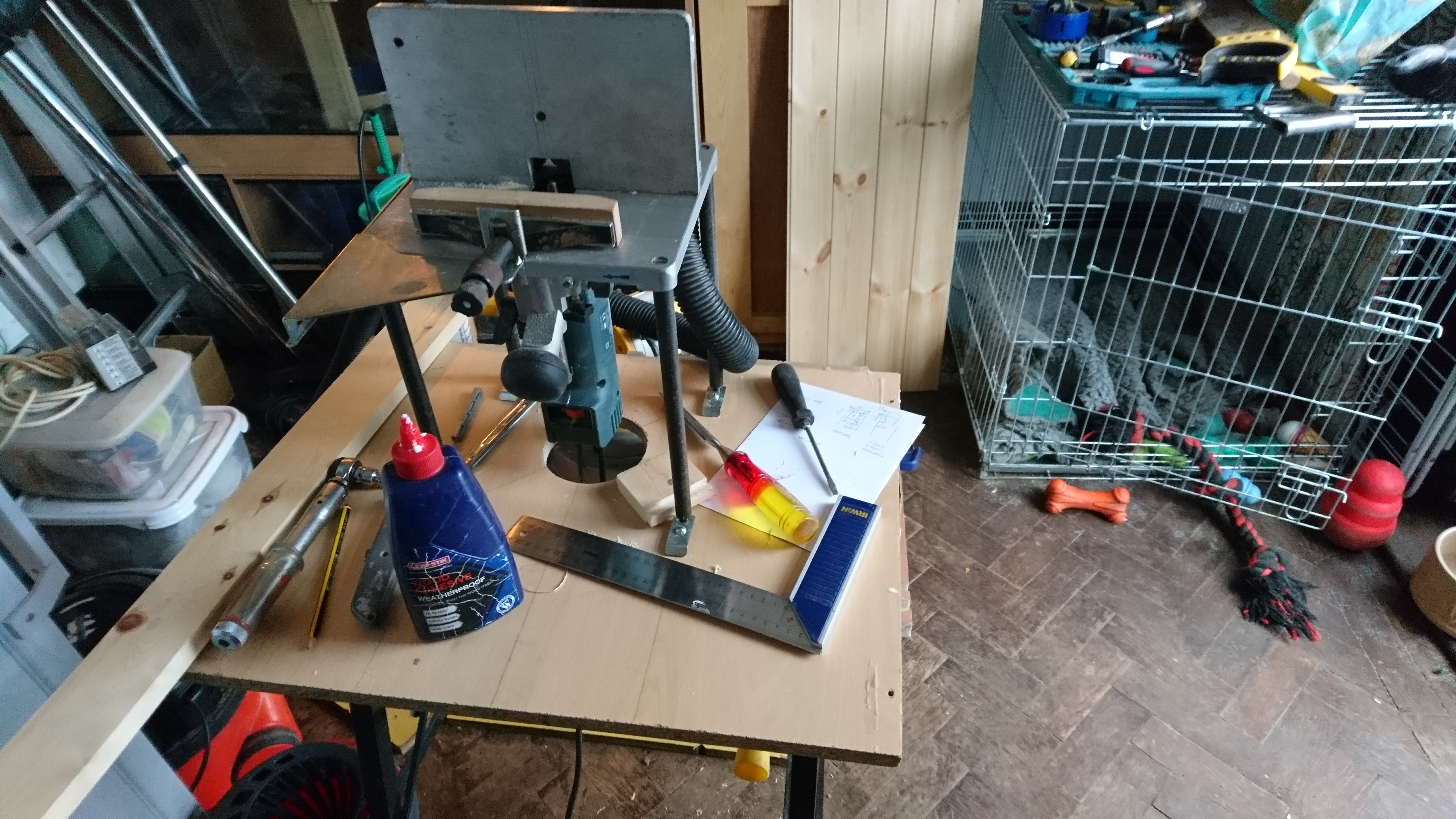

I done gone made a thing!
Set up the elu table with the kw779, mounted it onto some 3/4" mfc I had left over from an old vivarium build. Replaced the shonky jaws on my workmate thingy with the mfc sheet and now have a good height, stable router set up. Gives me a reasonable size flat area to build on and clamp to. Got a record underslung vice and marples mitre jig that I'll attach later for added utility. The whole lot will fold up to take less space in storage.
Bought a 1/4" dovetail cutter (only a 10 quid screwfix job but all I could instantly buy) and with a bit of trial and error made a door frame with dovetail corner joints :)
Rebated the inside to take the t&g planks to infill the panel and glued the frame together. Unfortunately I cut a couple of the dovetails a bit loose and the back split out of them but have been thoroughly glued and clamped. By the time the panel is glued and pinned in it should be a very solid assembly.
Will sand and plane it to fit the slightly out of square frame (which is built on an out of square floor :D) before slinging some hinges on there. I initially left 1mm clearance on all sides when taking the measurements, squaring up the outside should open some of the gaps up but should I be aiming for a little looser?
