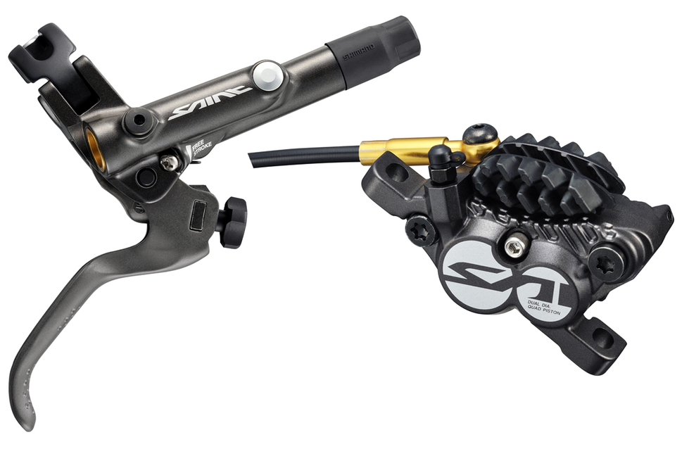

the new model saints are a fair chunk weaker than the old m810s, if you put them side by side the calliper mounts on the new ones are thinner and also weaker, seen a few go. if you can find a pair of m810s in good condition (which is difficult) theyre still great by todays standards.

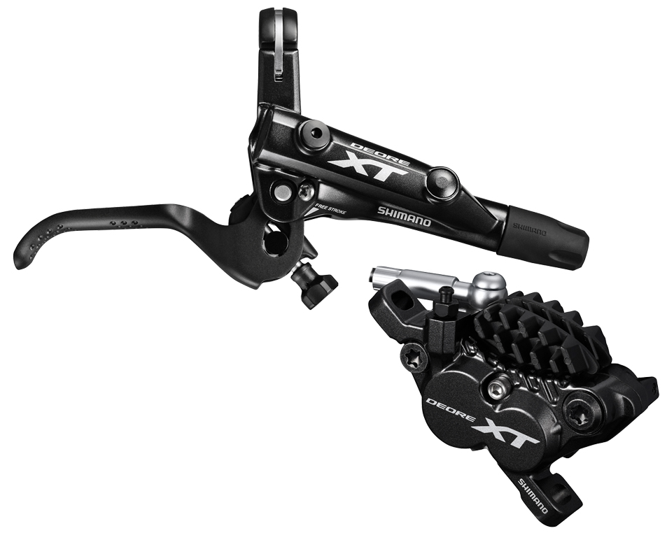

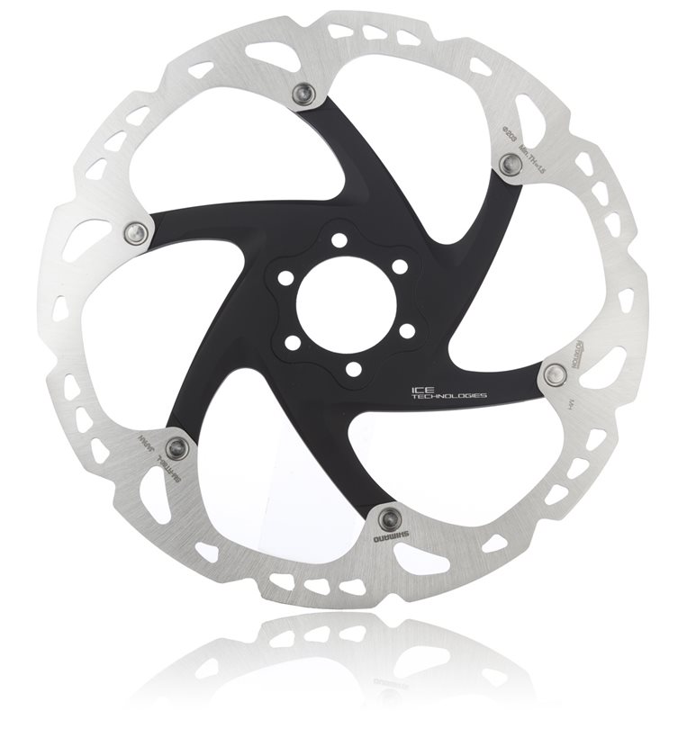

Shimano 4 pot zee’s, saints or the new XT M8020 are brilliant.  Fit a pair of Red EBC pads front and rear and you won’t want to run anything else. Also with matching ICE TECH or slx/zee rotors.  Magura’s are good at first but so many people have snapped and cracked levers there not worth the cost, other people will differ as they haven’t had the problem yet. Shimano brakes are good for price, even the low spec deore’s, slx and XT 2 pots are good as long as you fit a good set of pads.  Also the only problem why people think calipers break so easy is because you need a fat brake adapter to mount it to, not a weak fin Shimano one. Try Hayes or avid if you search for one.

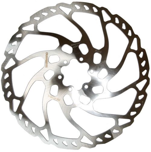

I've got those new MT Trails. For the money, I don't think the braking power can be matched. I'm using 203 shimano ICE rotors front and rear and Jitse/Trial tech pads. Once they bedded in, the power and been consistent and very hard. I trust them 100%.

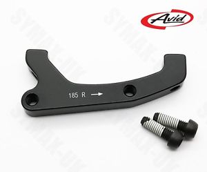

All capliers snap, only reason is because of the brake adapter being so weak. If you run a big fat one as I showed in my previous post you won’t have a problem. The fin weak ones like shimano and hope adaptors don’t take the force. A lot more people these days have transferred to disc brakes which has made the numbers of brakes breaking or snapping. Only some people are lucky to not have the problem yet but I can admit I’ve had my fair share and noticed what’s strong and what lasts. But at the end of the day it’s your choice.
I agree that a strong adaptor helps but there's no doubting Shimano calipers aren't as strong as others. I've snapped some adaptors while running Magura brakes and the calipers have survived with no issues.
I'd rather be safe than sorry and for that reason I just couldn't trust (newer) Shimano calipers.
  • Like 1
Make it a rule that regardless of what brake you get, get a Hope adaptor. You'll probably never snap one, thank me later ;) I'd personally avoid the newer style Shimano calipers like the plague. Myself and friends have snapped a few and the plastic "lighter weight" pistons are so light weight, that as you can guess, also snap/explode fairly soon.

Broke Saint m820 caliper on a fakie gap.(After 2 years bashing them).  Though I don't go BIG, so I can understand why pros would avoid them.
Broke Magura levers aswell (few rides) learning nose stuff. Yes, good customer service. Got it replaced. But I would prefer a stronger lever. I can't trust them anymore.
As a basher, I can tell those saint m820 levers are very strong and I still have mines since almost 4 years. (One lost spring pretty early)
So I tried Shimagura. Saint M820 lever on mt4 caliper. It's been 7 months without any issue. It has great power and sweet modulation. No leaks. No air bubbles. Works perfect to me.
  • Like 4

Hello, I bit the bullet and brought MT trails for £150 new, also got ice tech 203 rotor. Which adaptor would you recommend. The bike is 180mm IS as standard. I looked at avid adaptors but it wasn't as simple as +20mm so if someone could tell me what would work I'd be very grateful, cheers!
Edited by Archie H
On 16/05/2018 at 4:32 PM, Julius Czar said:
 +1 on the hope adaptor, don’t mess round with anything else!
