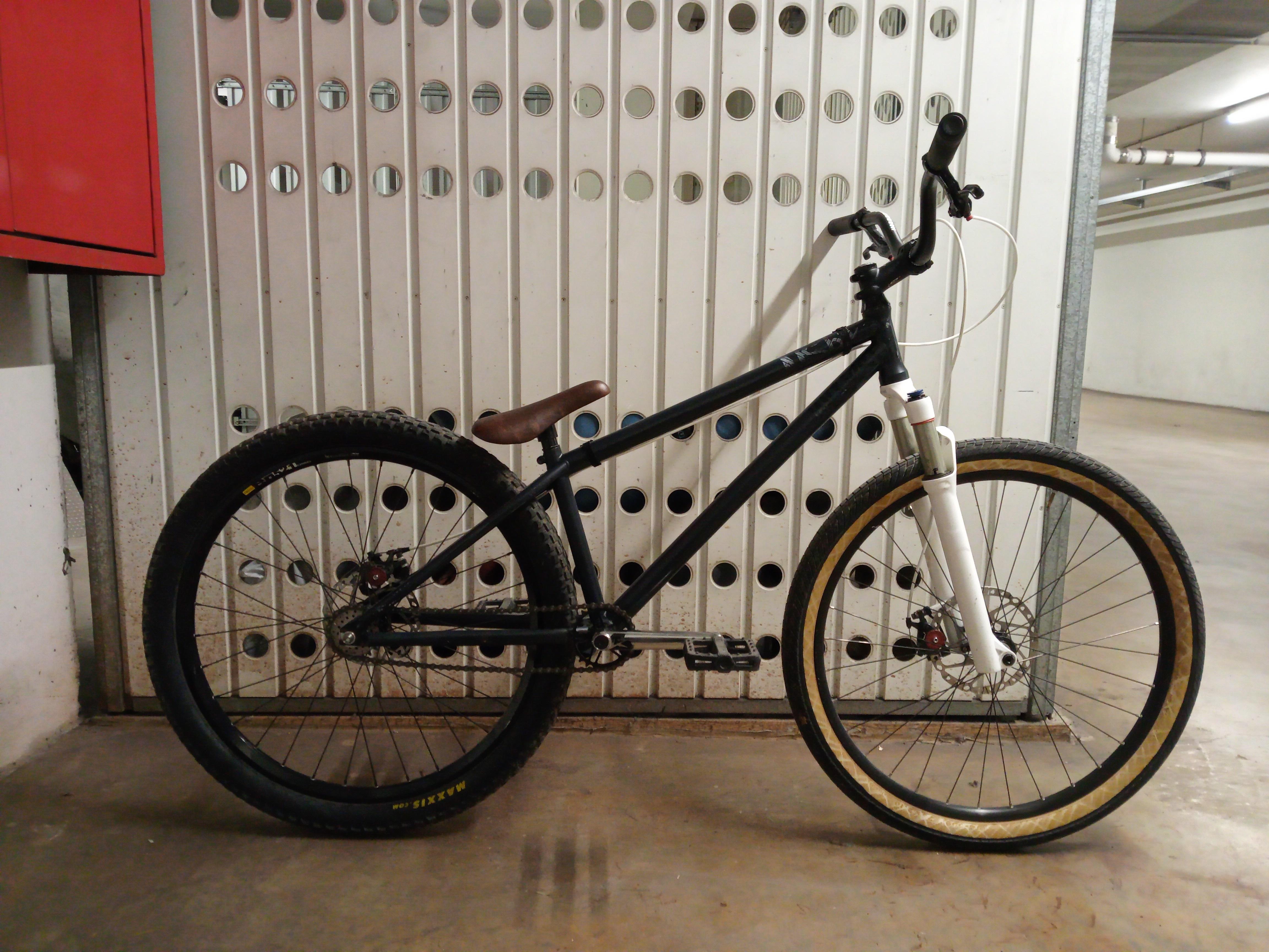

  22. Get well soon! Loose also one tooth and broke another one in a crash at the pumptrack But still love to ride it! The bike looks sweet. The bottom bracket seems to be quite high too me (for this kind of bikes), which could be great for some trial moves.
  23. You eventually changed the rear tire? How is the new spot?
  24. I like the look too, especially with a rigid fork, but my wrists don't like the idea of riding a rigid fork again on this kind of bikes. The current sprocket is made of steel and I think it is strong enough, it weights more than 100g. It is no longer true though I had one made of aluminum and it lasts maybe 6 months. I am light and I don't do big moves. But you are right, I have also my concerns regarding the fork. I check regularly for cracks. That is why I wanted to save some weight on the frame ... to put a Manitou Circus in 80mm without weight penalty. But I can't find a white one for a good price currently The stiffness will be higher and the lockout will be more efficient too, the one on the Reba is somehow weak.

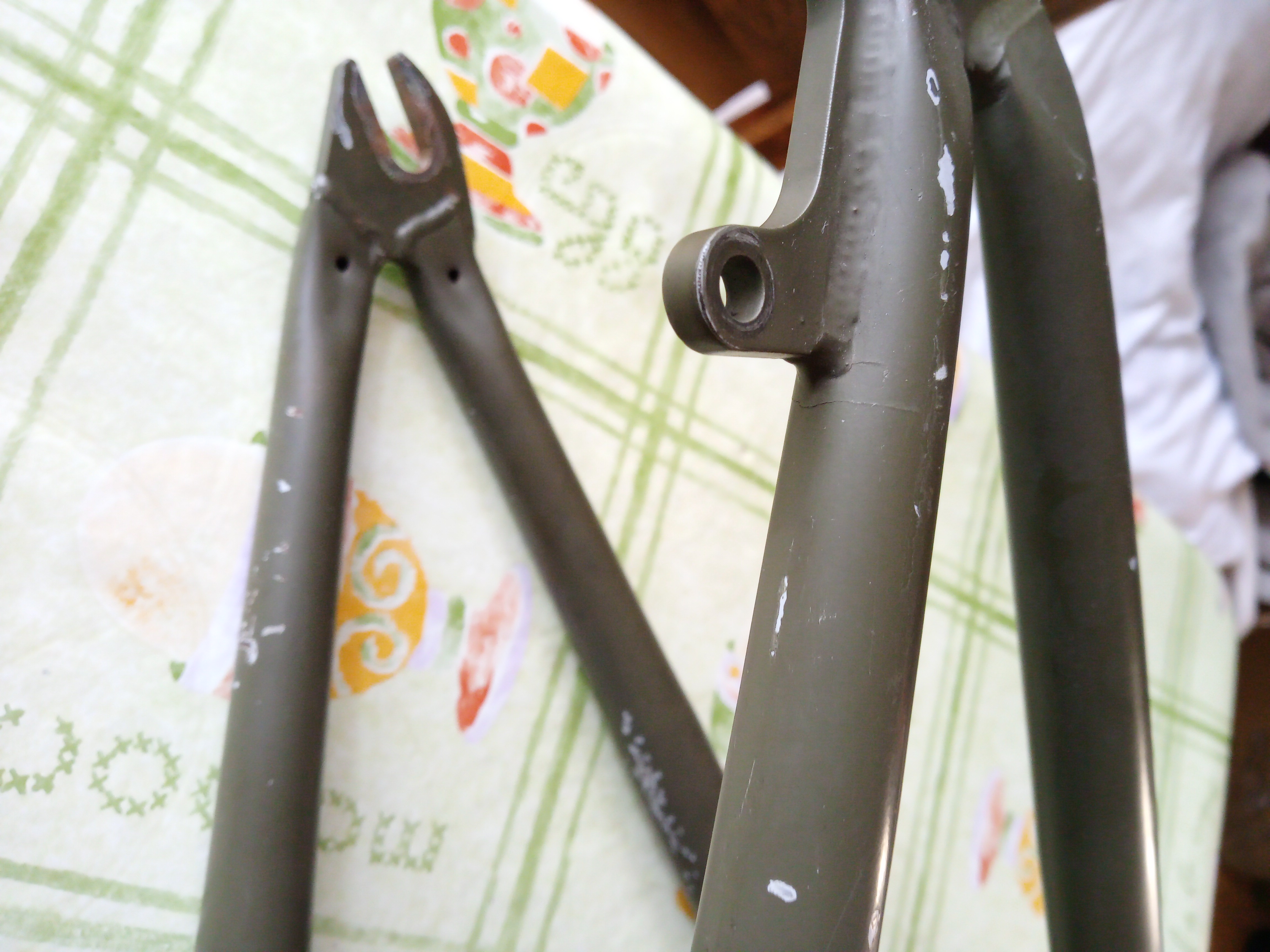

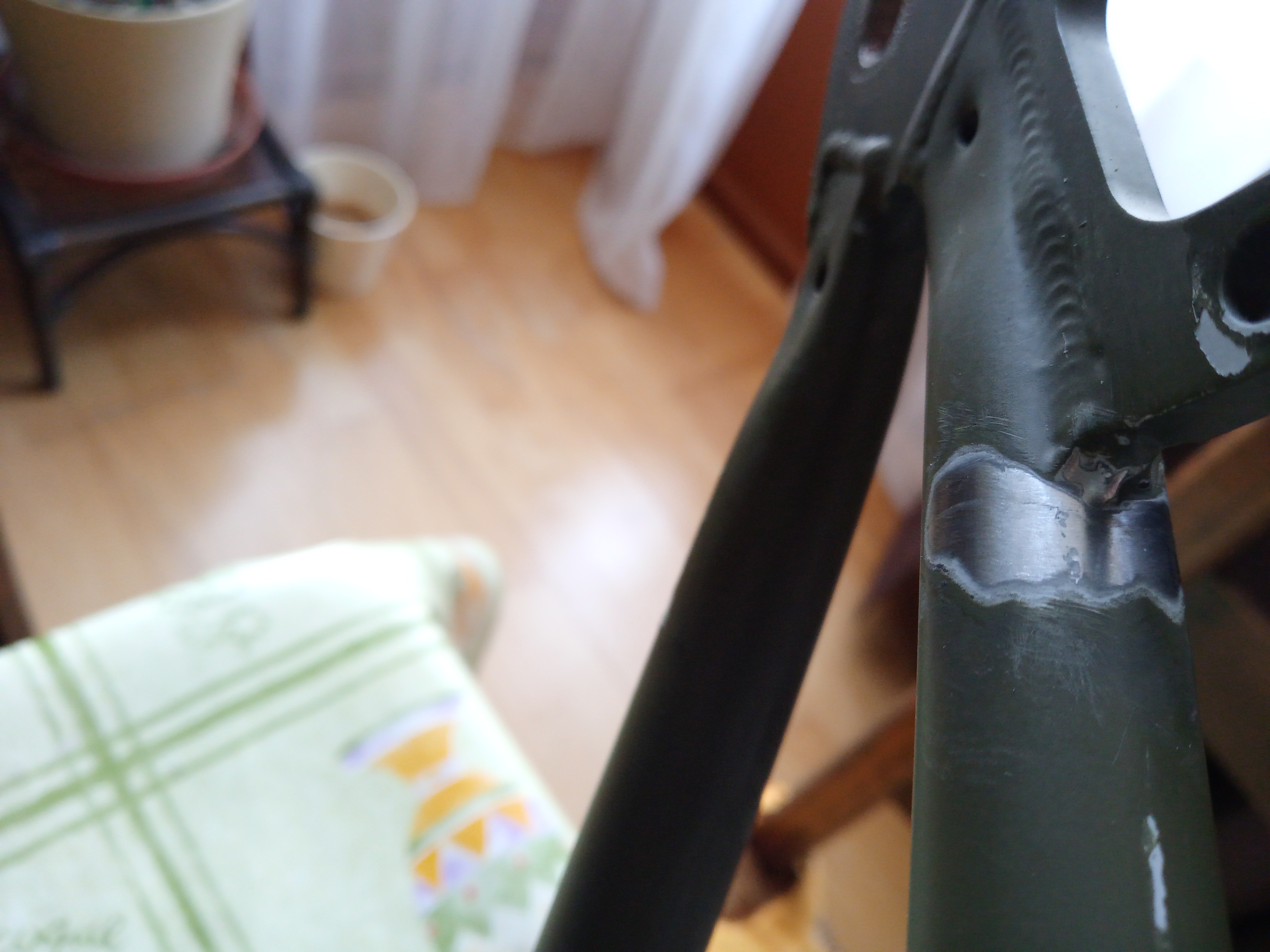

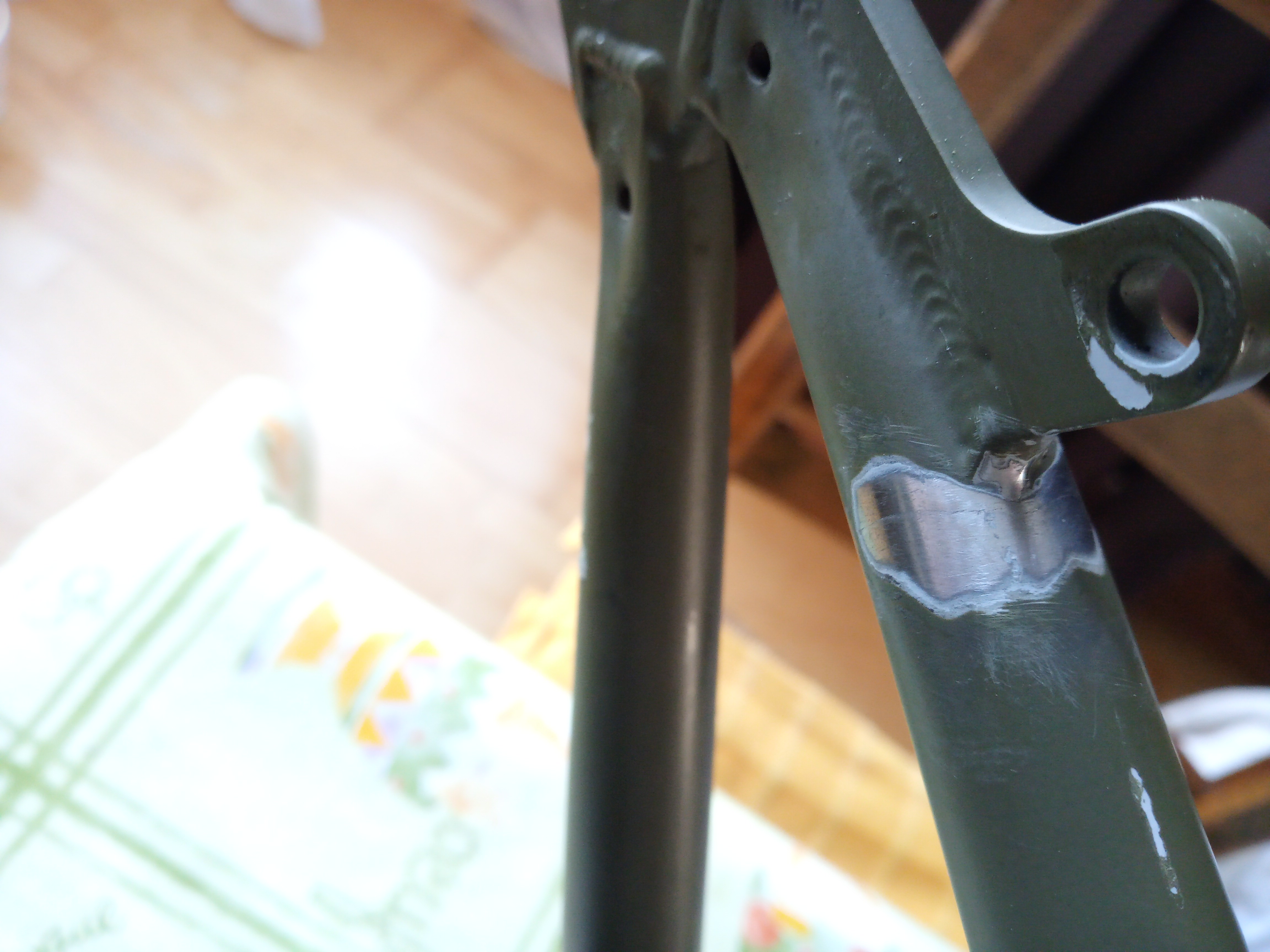

  25. This week I decided to sell the Octane01 Spark frame. Unfortunately I noticed a small crack close to the brake mount. So it seems trials was to harsh for this frame. Rest in peace, spark! Hope the Majesty will be stronger...
