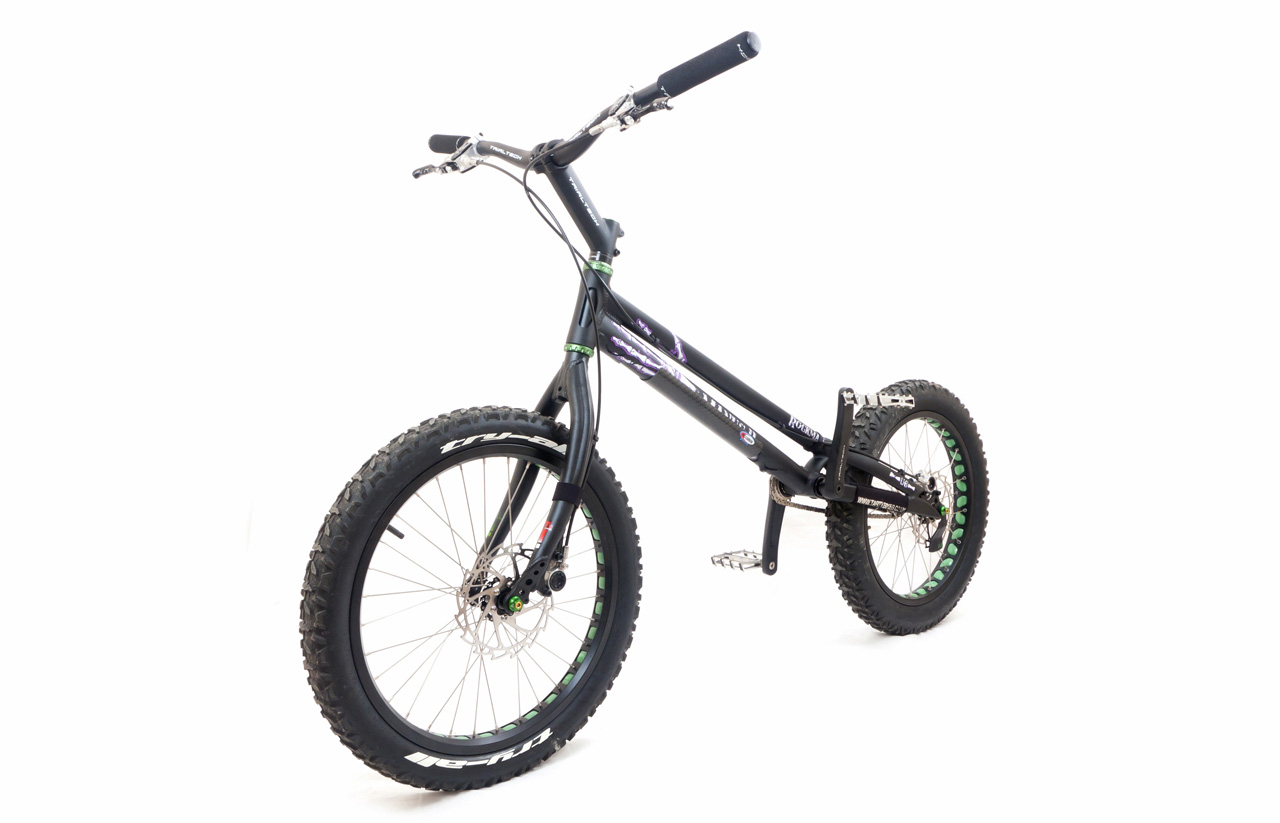

  3. Got the official weight today using digital scales in a bike shop... 8.41Kg

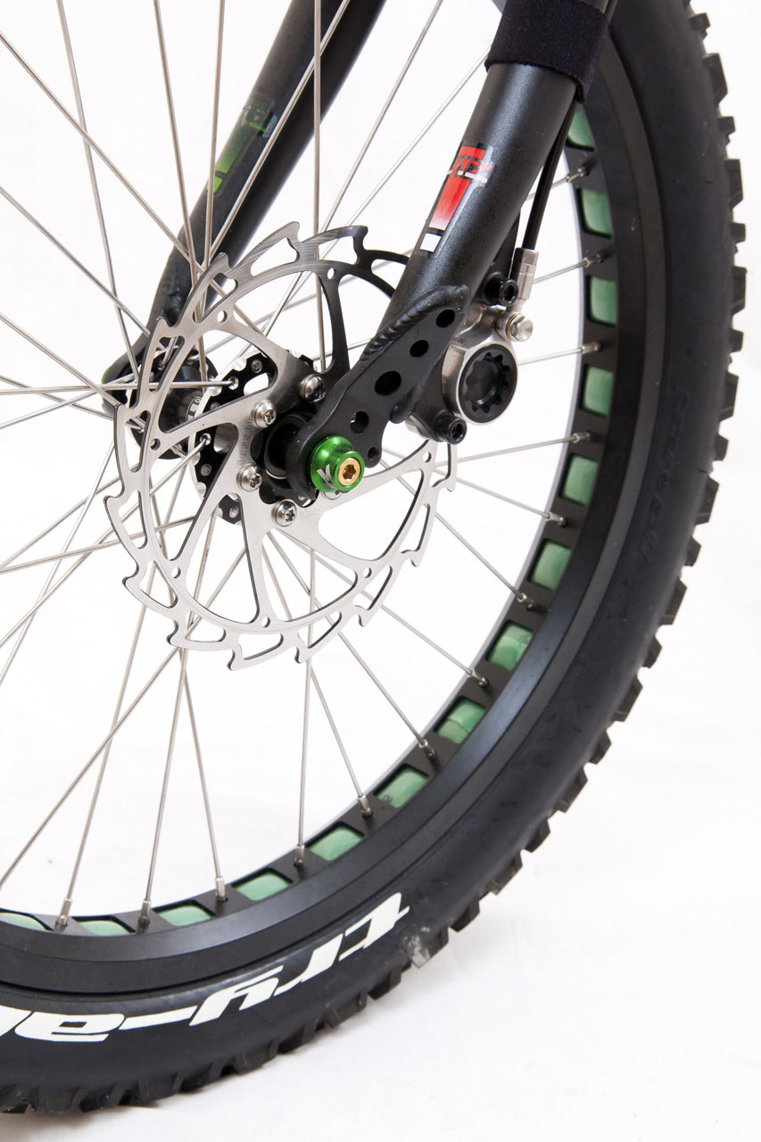

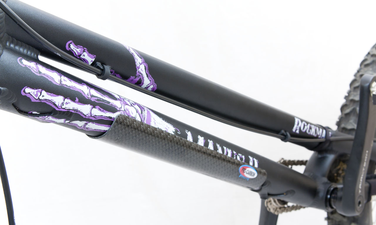

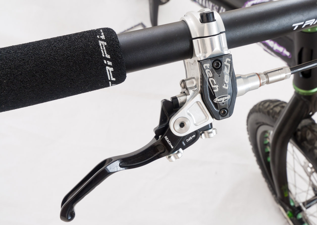

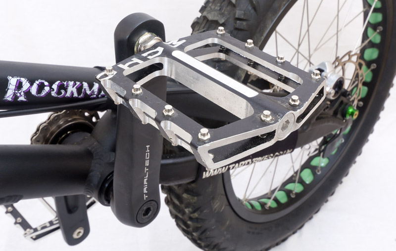

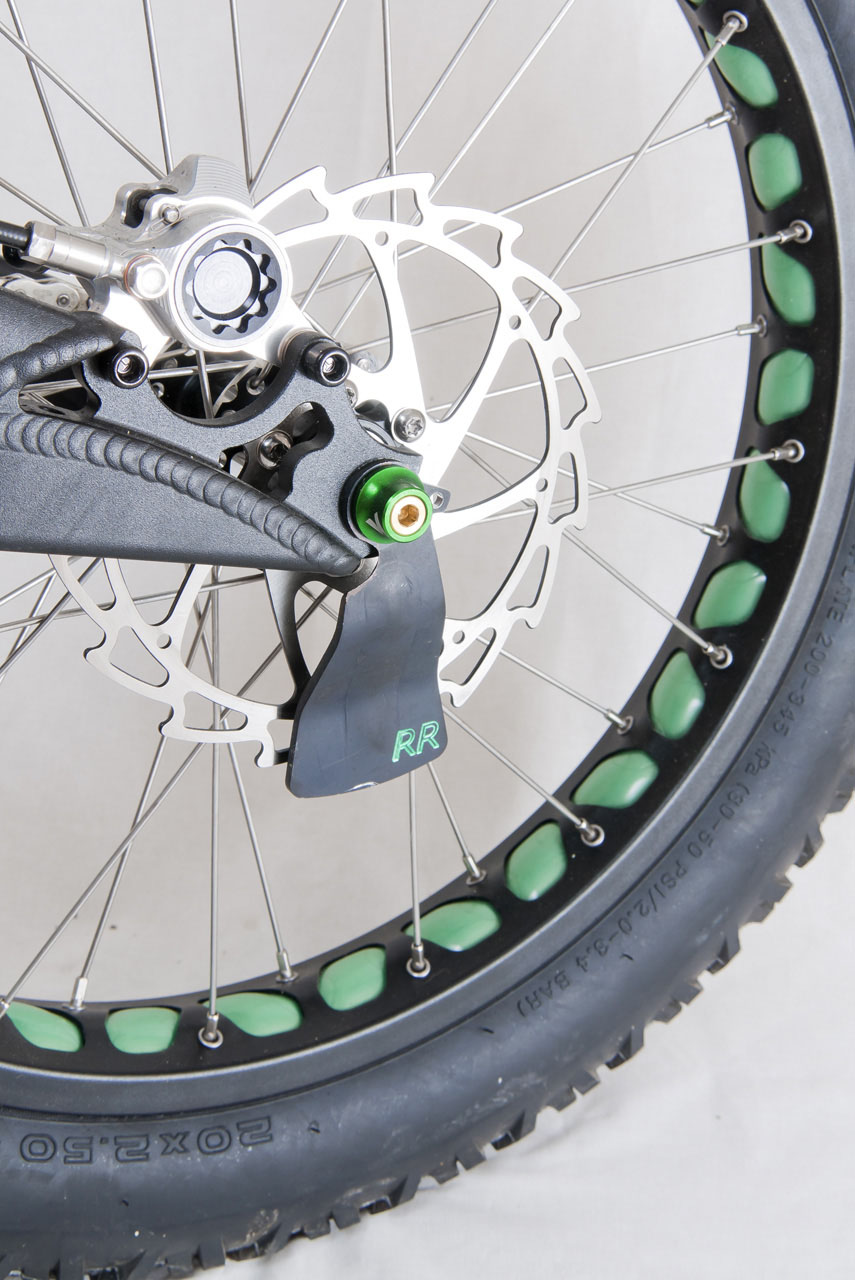

  6. Here's the specs guys.. MAIN Frame: Rockman Manus II Forks: V!Z Light Stem: Trialtech Race Forged 165mm x 35° (Sport forged in photo, changed after photo taken) Bars: Trialtech High Rise (Sport Riser's in photo, changed after photo taken) Headset: V!Z Sealed Headset Grips: Trialtech Foam Frame Protector: Pro-Carbon Racing Carbon Fibre Downtube Protector DRIVE Chain: Trialtech K810 Koll 3/32" Freewheel: Tensile 60 Click 18T Pedals: Echo TR Platform 2011 Cranks: Trialtech Sport Forged (160mm ISIS) BB: Trialtech Sport Lite ISIS Bashring: Trialtech Titanium Halfring BRAKES Front: Hope Tech Trial (Caliper #5) Rear: Hope Tech Trial (Caliper #3) Rotors: Gusset R-Series 160mm Rotor Protector: Chorrillas Disc Protector (Coloured Their RR logo with a green CD pen. RR also happens to be my initials, which was cool) WHEELS Tyres: Try-all Stiky Lite Rims: Front Trialtech SL / Rear Atomz/UN Elitis Spokes: Mutiny Plain Gauge in Silver Hubs: Both Echo SL Disc (with Green axel bolt washers) Sprocket: Echo Splined 12T Rim Tape: V!Z Translucent Green Tubes: Front Echo 20" / Rear Monty 19" Wheelbase: 1004mm Chainstay: 350mm BB Rise: +85mm Head Angle: 71° BB to top of headtube: 595mm Weight: 8.41Kg
  7. Need to pop into town to a bike shop to find out the official real-world weight. But I made an Excel sheet that had all the parts, prices and weights listed. That said it'll weigh 8.53kg approx. So will see tomorrow.. Off to work now, parts list later.
  8. Hey Guys, Finally finished building my new bike up. What do you think? Spec below.. MAIN Frame: Rockman Manus II Forks: V!Z Light Stem: Trialtech Race Forged 165mm x 35° (Sport forged in photo, changed after photo taken) Bars: Trialtech High Rise (Sport Riser's in photo, changed after photo taken) Headset: V!Z Sealed Headset Grips: Trialtech Foam Frame Protector: Pro-Carbon Racing Carbon Fibre Downtube Protector DRIVE Chain: Trialtech K810 Koll 3/32" Freewheel: Tensile 60 Click 18T Pedals: Echo TR Platform 2011 Cranks: Trialtech Sport Forged (160mm ISIS) BB: Trialtech Sport Lite ISIS Bashring: Trialtech Titanium Halfring BRAKES Front: Hope Tech Trial (Caliper #5) Rear: Hope Tech Trial (Caliper #3) Rotors: Gusset R-Series 160m Rotor Protector: Chorrillas Disc Protector (Coloured Their RR logo with a green CD pen. RR also happens to be my initials, which was cool) WHEELS Tyres: Try-all Stiky Lite Rims: Front Trialtech SL / Rear Atomz/UN Elitis Spokes: Mutiny Plain Gauge in Silver Hubs: Both Echo SL Disc (with Green axel bolt washers) Sprocket: Echo Splined 12T Rim Tape: V!Z Translucent Green Tubes: Front Echo 20" / Rear Monty 19" MEASUREMENTS Wheelbase: 1004mm Chainstay: 350mm BB Rise: +85mm Head Angle: 71° BB to top of headtube: 595mm Weight: 8.41Kg
