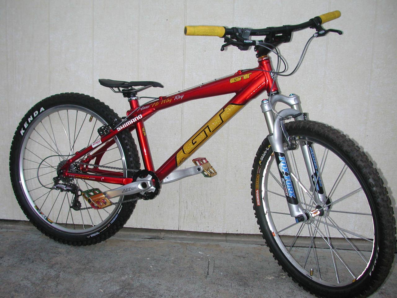

Saw this thread being revived somewhat. Some interesting and quality machines being mentioned here! My pick would be: Danny Mac's Mk1 Inspired Fourplay - early production white one with the Tioga rims and black forks, blue Hope hubs. If i remember rightly he was running Easton carbon bars? The Monkey DH ones? Ali C's prototype Arcade as has been mentioned before with the silver rims from Clean 002. On a similar note, Mark Westlake's stealthy brakeless example from the same video. Also from Ali's bike history - the British Racing Green Hex he rode brakeless. This one (not a very good representation of the colour rightly enough!) Also looks like he drilled an old Mavic rim on this? Next up Hans Rey's GT Zaskar trials - I remember seeing this in an old MBUK feature and aside from the sketchy looking bar and stem set up, I always thought this was one sweet looking bike and I'm not sure it ever appeared all that much. Finally a couple from Mr Ashton - some prototypes that didnt make it to production. A real shame as the Licence frame looks like the perfect all round play bike. These are some scans from old MBUK's not long after I got into riding about '06/'07. This one is some kind of prototype Orange (weren't Orange making the Ashton frames around then?) The all black Justice someone mentioned as ridden by Rowan Johns is a pretty good shout too! Notice a theme here? I like my bikes looking pretty simple yet looking effective at their intended purposes. Nothing fussy or overly designed.
