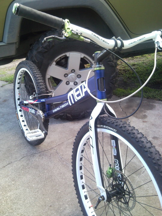

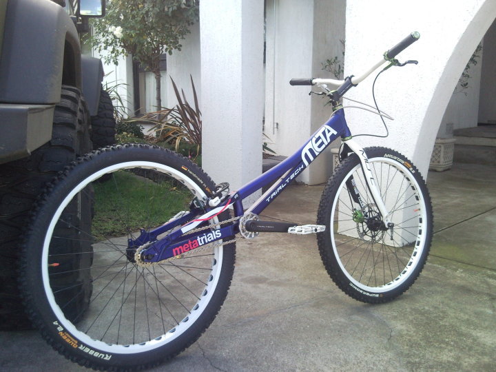

Over Tensioned Meta Vtt2 With Rubber Queen Rear, Cant Ride
Sethgun replied to Sethgun's topic in Trials Chat
Yeh thanks for that guys. As is, its a little past halfway on the dropouts and if i take the chain off, it spins freely so its def the chain but its still rideable. With my weight on the bike and I stop pedalling, it doesnt just stop dead so thats a good thing. Ill set up my brakes now and after a bit of stretch, it should be good (fingers crossed). -
nah rubber queen isnt whit, its my fave but for clearance on this frame ur mounting ur axle pretty far back....dont like the idea of getting too far back, (getting cracked dropout images in my mind) and thats where im gettin probs with chain tension. Its still rideable for now even though the rear wheel doesnt spin freely, just need to spend a few hours to stretch it out then should be right tension. If I stick a halflink on its too loose. Regarding the mist forks, they look the goods I reckon, and the geo is exact same as the tryalls which I think is why they are gonna be popular. Pretty stiff. If anyone is interested in them, hit Wil up at trialsden.com Might be far for some because hes local, but hes a champ
im thinkin bc my cams are maxed out, instead of buying ones with longer adjustments im just gonna stick a bigger washer under the cam bolt so it presses on that (effectively giving more adjustment) running halflink with axle close to the end and hopefully itll stretch enough after a while to ditch the halflink...or somehow bring it closer in the dropouts. Dont wanna be riding every day with an axle mounted 1-2 mm from the end of the dropout! -
hey bud, its a new chain i got from you guys. Its a trialtech lite 3/32" . Rear rim is a trialtech and rubber queen with echo tr cams. Such small clearance with the vtt2 and this tyre. At the point where my tire runs smooth without touching my bb, ive maxed out my cam on the non drive side (drive side looks like its maxed too, sitting about the apex of the bulge on the cam-furthest point out) and axle sits a little more than halfway back of the dropout (this is without a chain) with the chain on at this point, its stupidly tight and stops from spinning. If i put a halflink on, its too much. Do you think i should go for a cam with more play like, the neon or viz! cams? They give about 10mm more adjustment so it should sit better with the halflink im guessing. Then once its stretched, maybe try again without the halflink? How much would a chain like this stretch out? Should i be looking at a different chain that has slightly longer or shorter links, or are all chains same link length? -
Actually yeh crap, ur right....if u put a narrow link together with the sides of a 2nd link, uve got an open end and a closed end (if that makes sense) a single half link gives u an open and closed end on a single link. Might have to play around and use 2 or 3 half links to get the tension spot on true? Its as if all i need is half a single link and ill be spot on, working with a few half links might end result in this somehow, ill play now -
yeh ive got a couple of thos half links on but really, they are still the same overall length as a full link thats what gets me. Spoke tensioner......where did i see that here? u got a link? I think one of the tarty boys did that in a post...... -

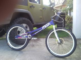

again, looks lush. they ti echo cams? did u get tension sweet or need a half link? Im 9/10ths through finishing my build too, mist forks coming tomorrow and shes done Bring it to melbourne AU buddy, there is a clan of us here who all snapped up the shipment quick Got a mate selling a blue one too if anyone is interested, pm me. Hes gone with a slate II so this has only been touched, nothing mounted to it. Can get u in touch with him if interested
yeh carbon is just stickon.. my vtt2 build is blue frame with everything else black/white so should look the goods im hoping. just gotta use +20mm to use my 180mm rotor which is a shit
hotness......ive 3/4 built mine up just waiting on some bits n pieces, blue too and i reckon the best colour out of the 3. Was gonna ask immediately before iu saw ur specs as to what rear rim that was....is it single wall? front rim looks like a trialtech sq hole! did u have to change to smaller hub spacers to run the cams on the inside? i had to get shorter spacers for my rear trialtech hub for this reason to run cams on the 10mm guts on the inside, which is why i ask. Tyre clearance? how u running... further back than halfway on the horizontal dropouts to clear ur tyre? u should see mine with a rubber queen (and anyone consideringrunning this frame with one) im waiting on the cams but clearance looks like a bitch to the bb, will be running close to the end of my horiz dropouts.....is that a bad things in terms of strengh on these frames? Looks real lush

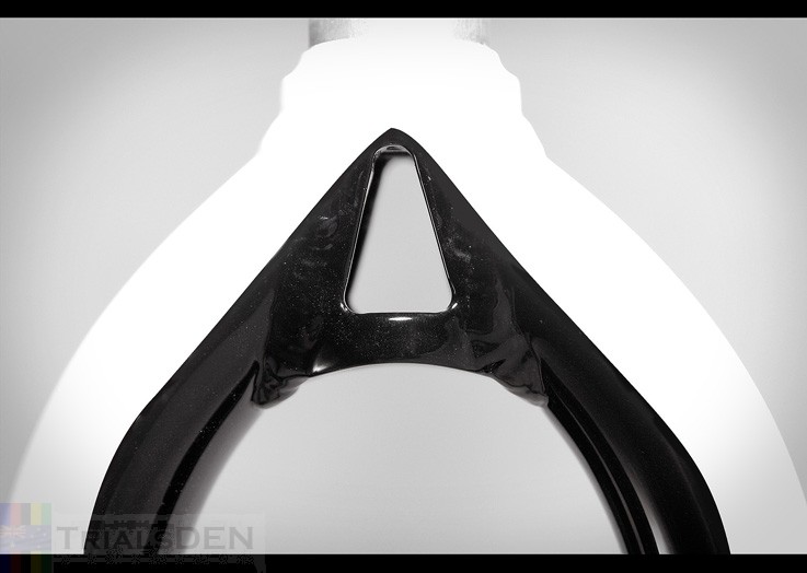

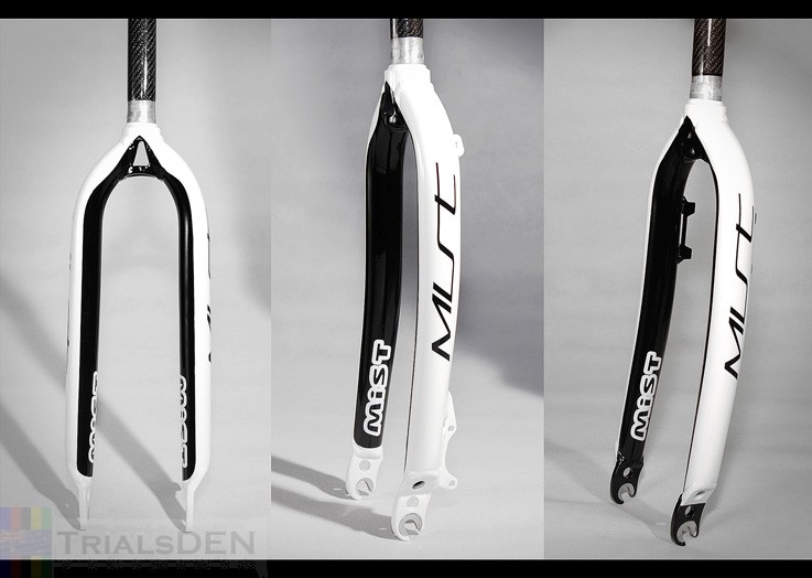

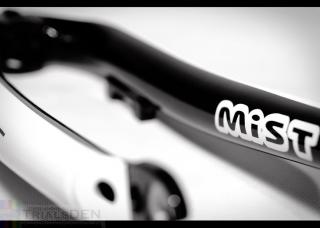

Just wondering if anyone has got them yet or ridden on any proto mist forks. Essentially the same geo as the tryall forks, but mega pimpness (available in is mount disk or 4 bolt). I ordered mine locally in Australia through a mate at TrialsDEN (check out the site, pretty darn good for us Aussie riders and great prices.....just waiting for them to arrive. Gonna run them on my meta vvt2 unfinished build with +20mm adaptors for my 180mm v2 rotor. Any feedback of actual users would be great in terms of stiffness and general feel. Heres a couple of pics.... cheers kids
