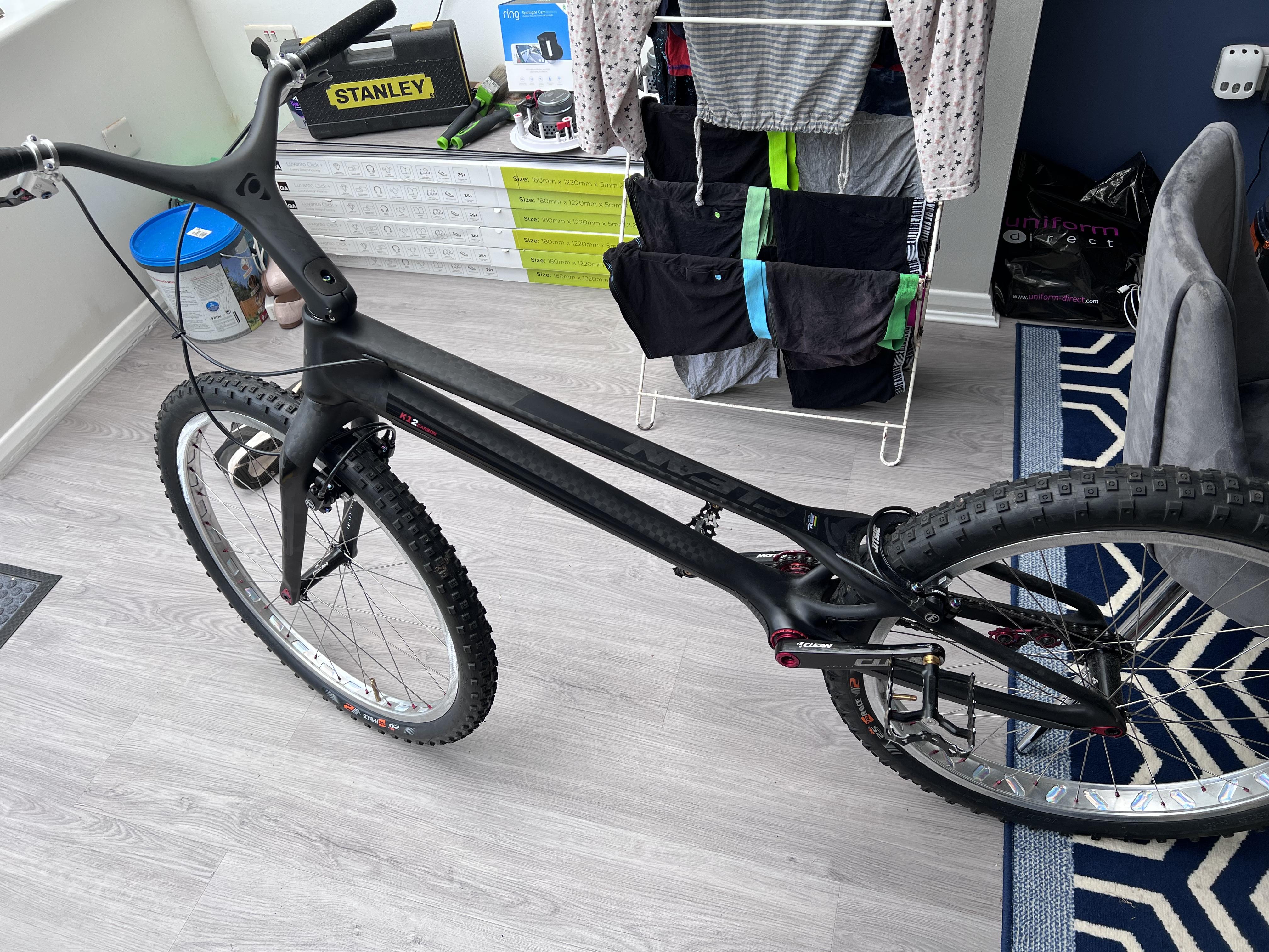

  3. Recently retired, haven’t rode in around 18 months. Just turned 40. But I’ve got the itch again. So went and picked a new bike up to play on. Hopefully won’t break my neck
