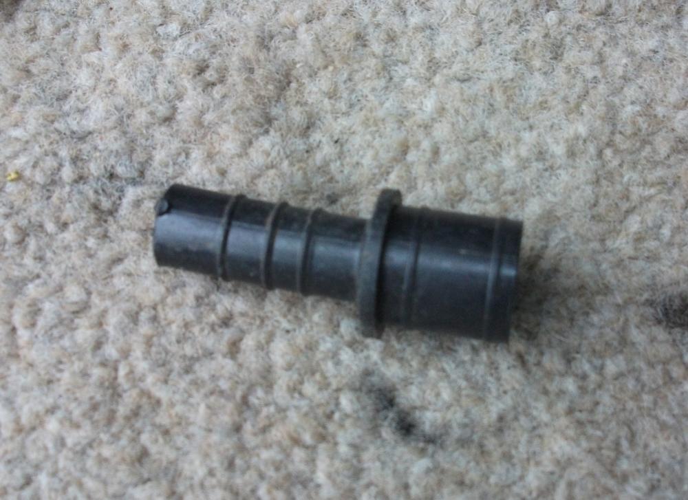

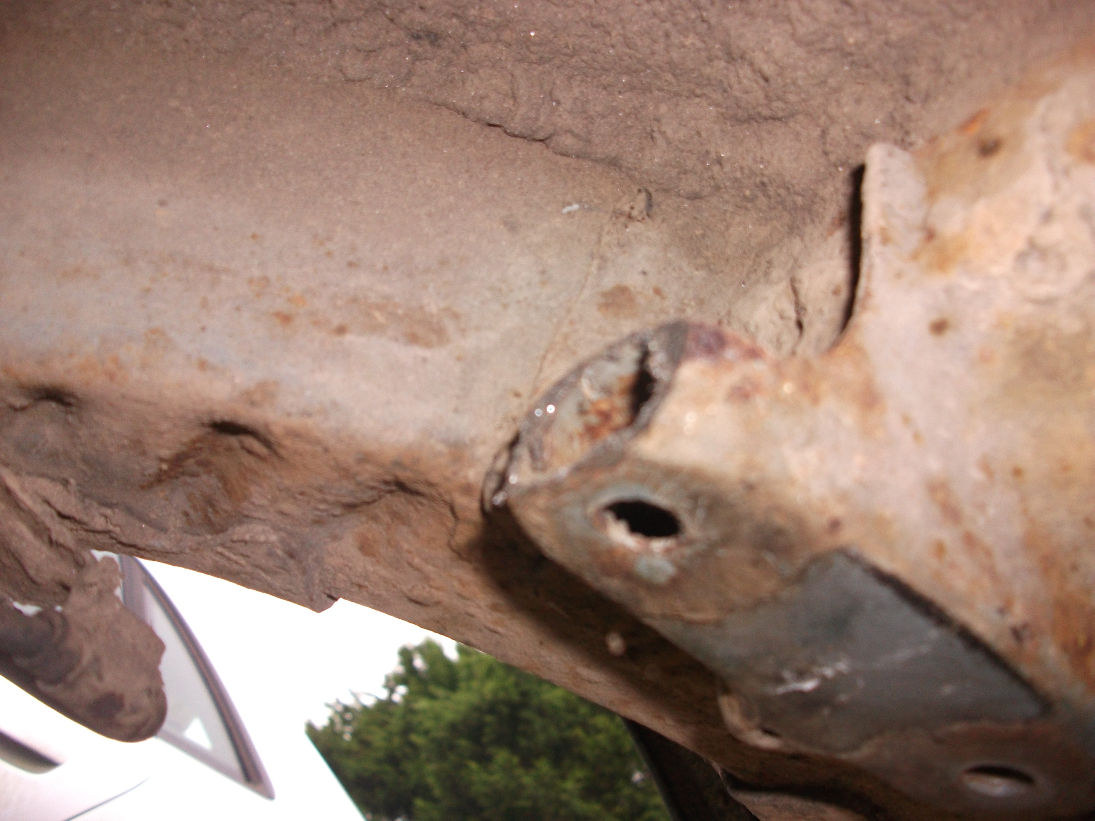

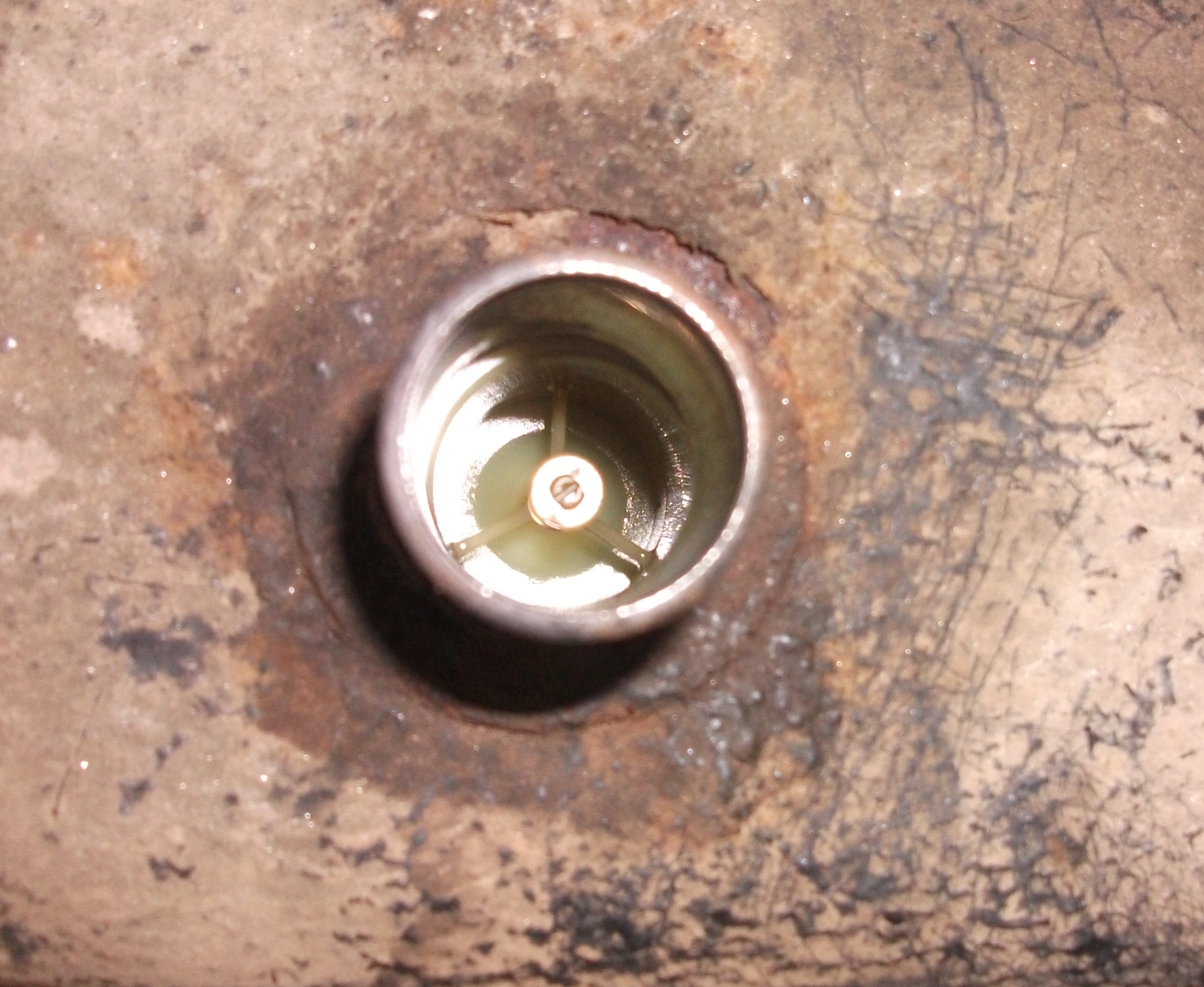

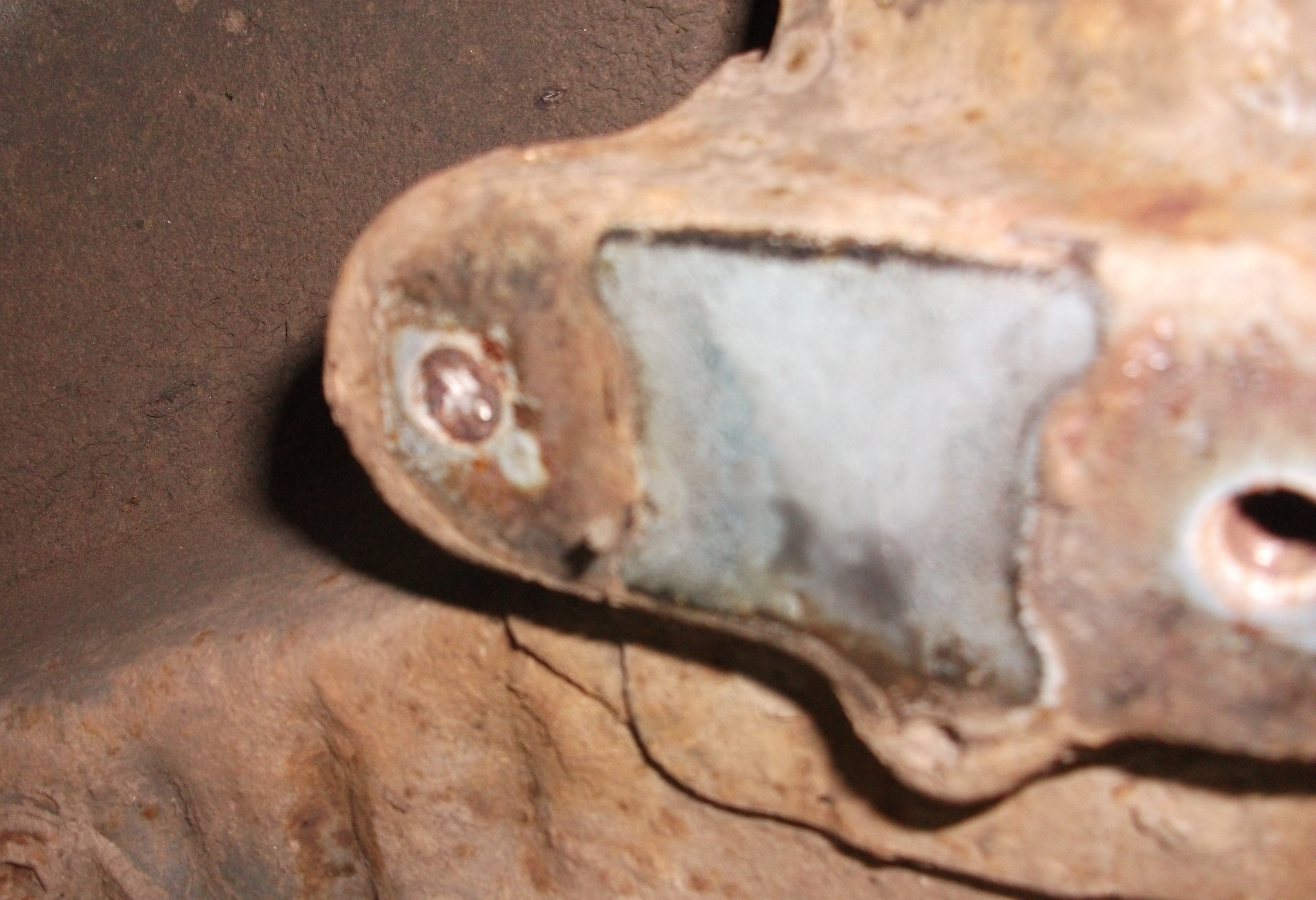

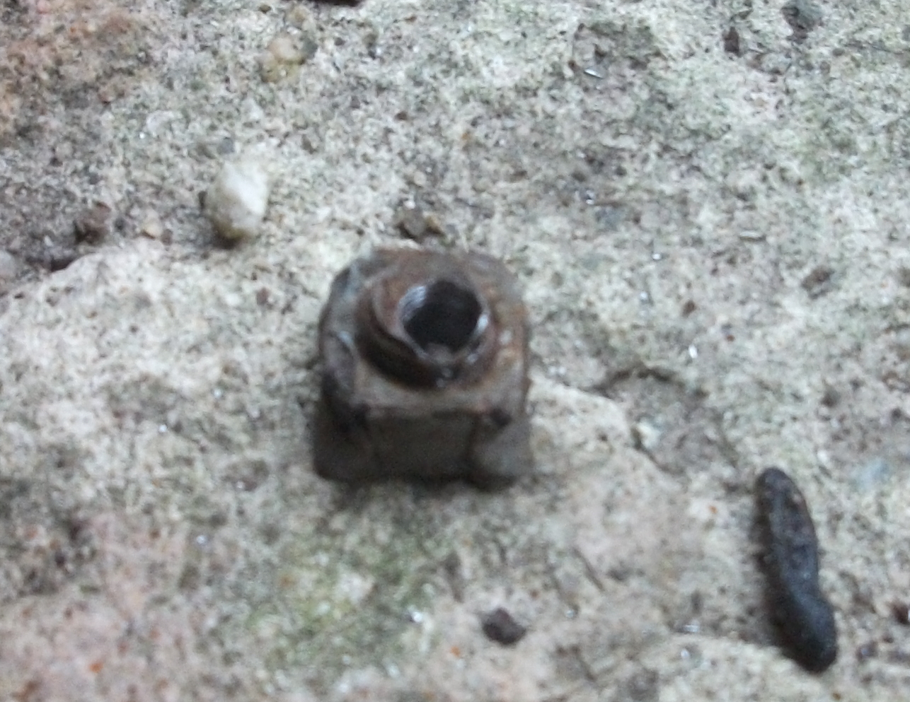

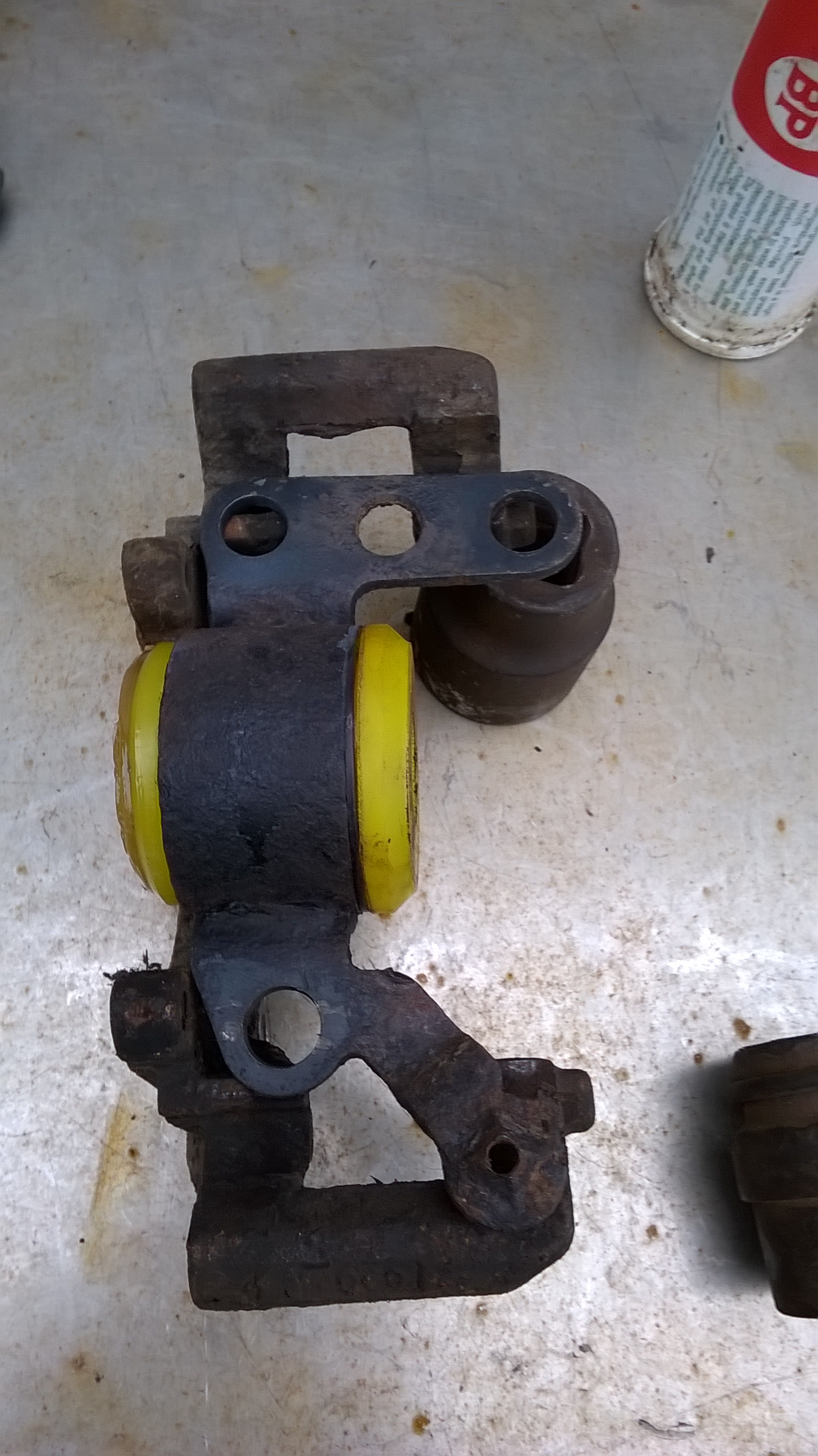

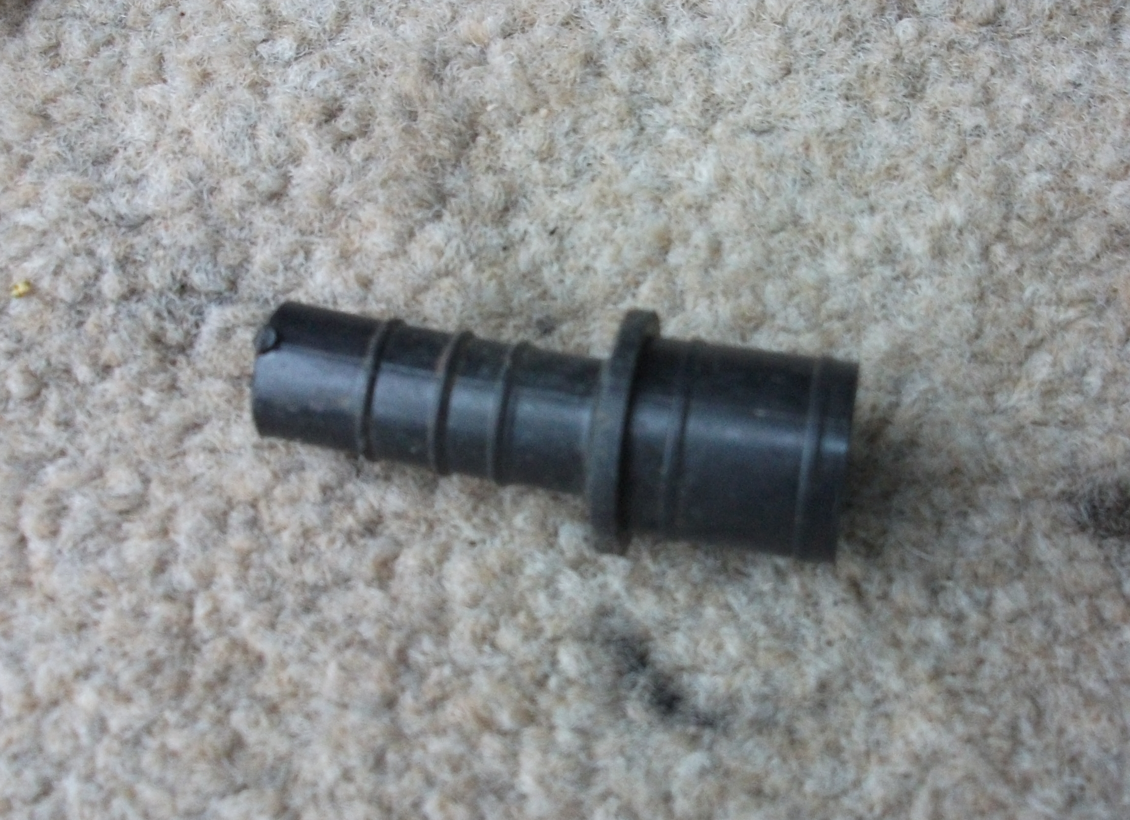

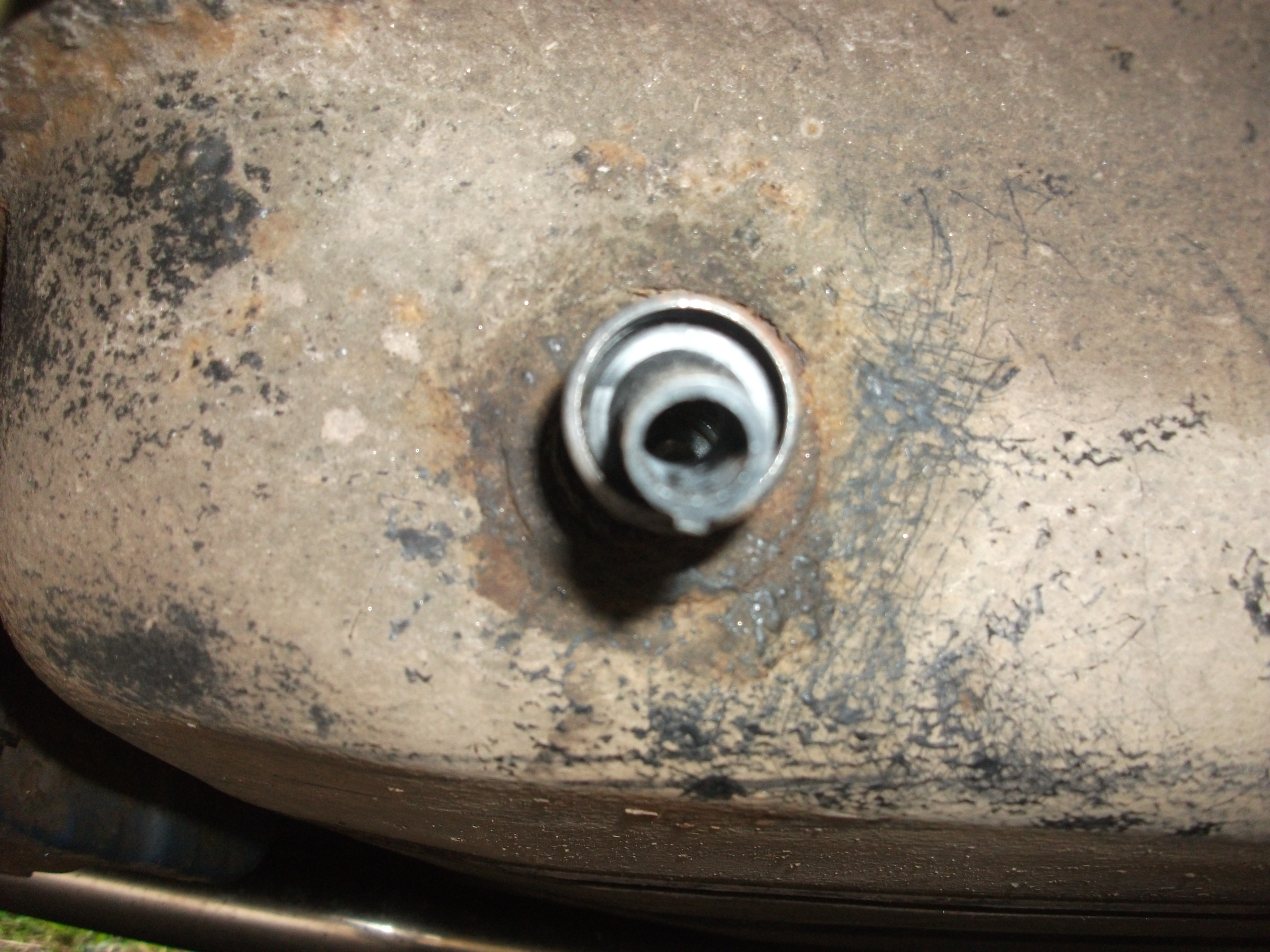

  14. Did some work on the shitcelica today. first job was to drill out the snapped arb mount bolt. Center punched it, then went through larger and larger drill bits. I center punched it slightly off, so when the drill hole got close to the threads, i tried to collapse the remains of the bolt. The first decent hit with a hammer tore all the tack welds off the nut. I ended up cutting the end of the mount off, which is big enough to get a 13mm nut in there. I decided to press the rear lower arm front bushes in. MK4 front caliper carriers were perfect shape as spacers! Things were going well, so i decided to look at why it's always been difficult to fill up the fuel tank. It felt like there was a blockage in the filler neck, so i took the rubber joining hose off from between the tank and the filler neck. That explains a lot! it looks like there was a plastic hose reducer/expander in the fuel line. (f**k knows how it got there!) Behind it is a plastic valve, which as far as i can tell it seems to work as an anti-siphon device and fuel baffle. Dropping off all the suspension bushes to @Alex Dark to get them machined down to work correctly, and picking up the new sub frame Friday. Finally some decent progress
