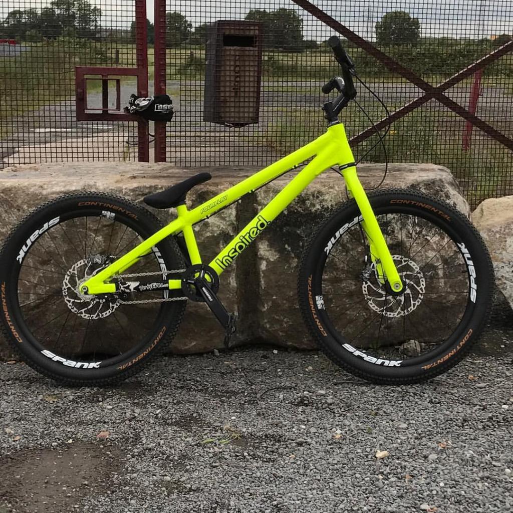

  6. Seen this on Fabio Wibmers facebook, New Fourplay frame im assuming. Definitely looks different on the downtube and seat stays.
