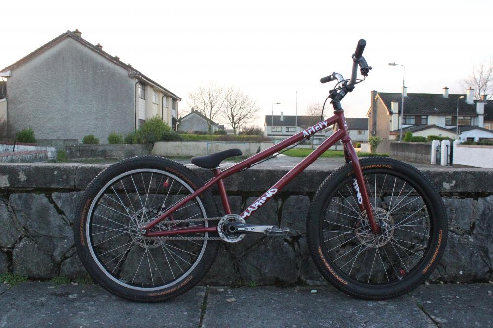

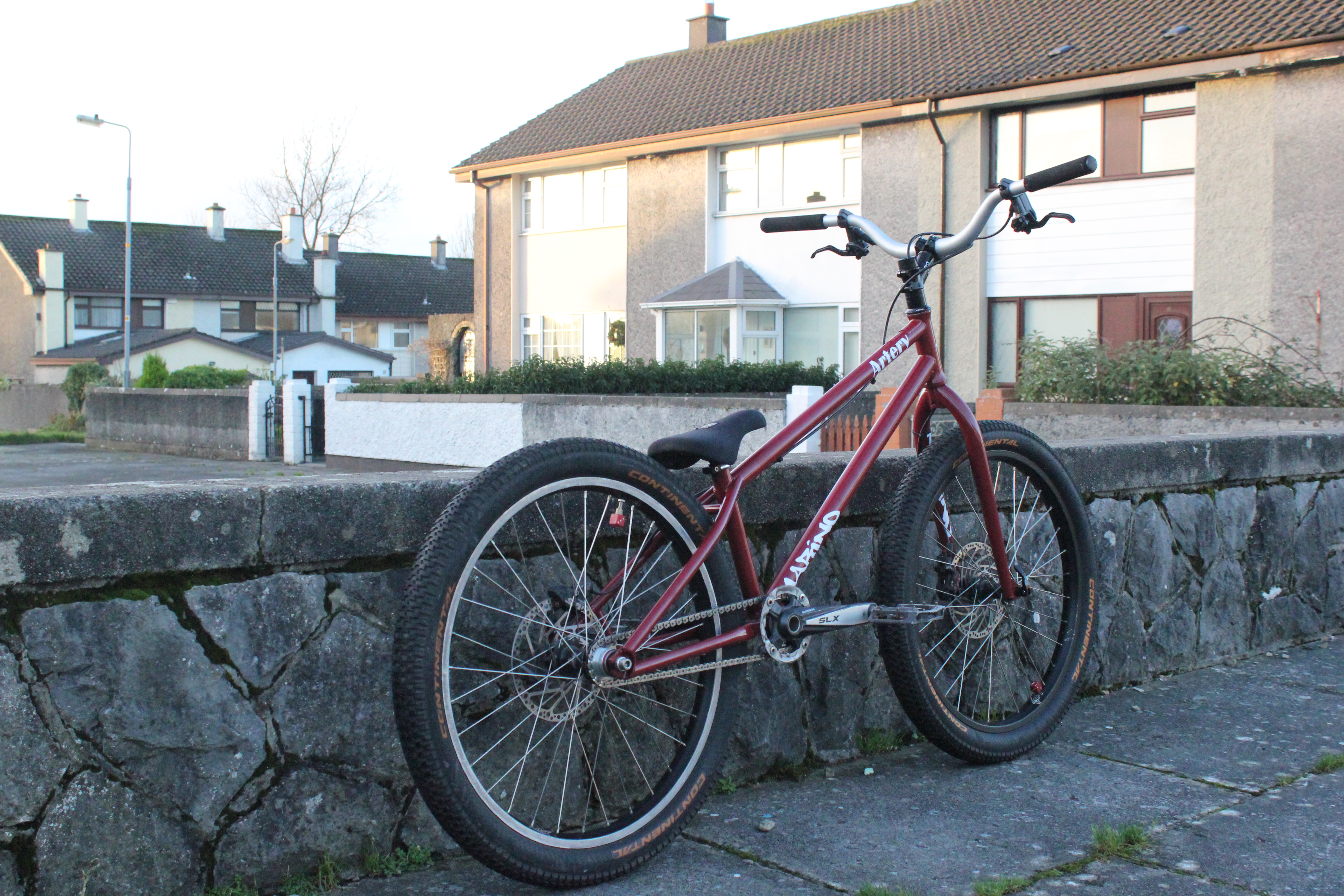

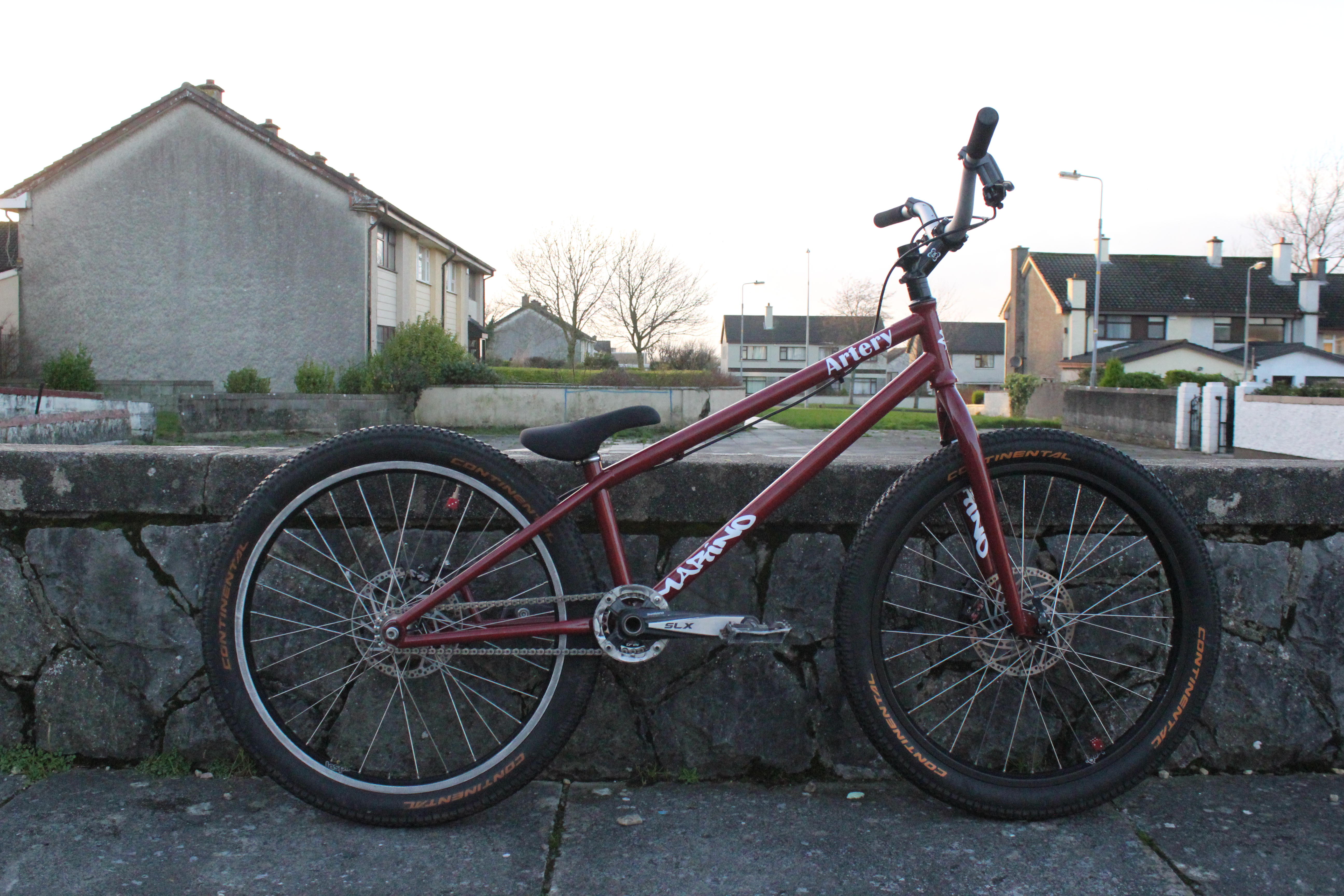

Hey so i finally after weeks of waiting have received the new frame and fork from Marino ! the geometry Top Tube- 587mm Head Tube- 135mm Seat Tube- 260mm BB Height- +15mm Chainstays- 363mm Wheelbase- 995mm Head-angle- 74.5 degrees The Parts List Marino Frame Marino Fork Marino headset Marino topcap Stolen F-boss seat and pivotal post System EX 35degree stem Inspired Arcade Bars Shimano XT 775 levers with Shimano M810 calipers , 203 mil rotors and sintered pads F+R Cult X Vans grips Shimano Tiarga BB Shimano SLX cranks 22T with a bent as hell chaibashring and the odd blue crank bolt Shimano Saint peddles Gusset slink halflink Superstar 16T double wide sprocket Hope Pro 2 SS/Trial rear hub Formula 15mil front with a bolt through axle from euan beaden Spank Spike35 chrome rims front and rear with polished spokes and nipples Continental tires The weather here has been absolutely terrible the last few weeks , ill try to get a video up as soon as theres a few days without rain or crazy wind . Heres the photo update for now . here is a link to other photos of the build before the shiny parts . http://www.pinkbike.com/u/sggodll/album/2015-MARINO-ARTERY/
