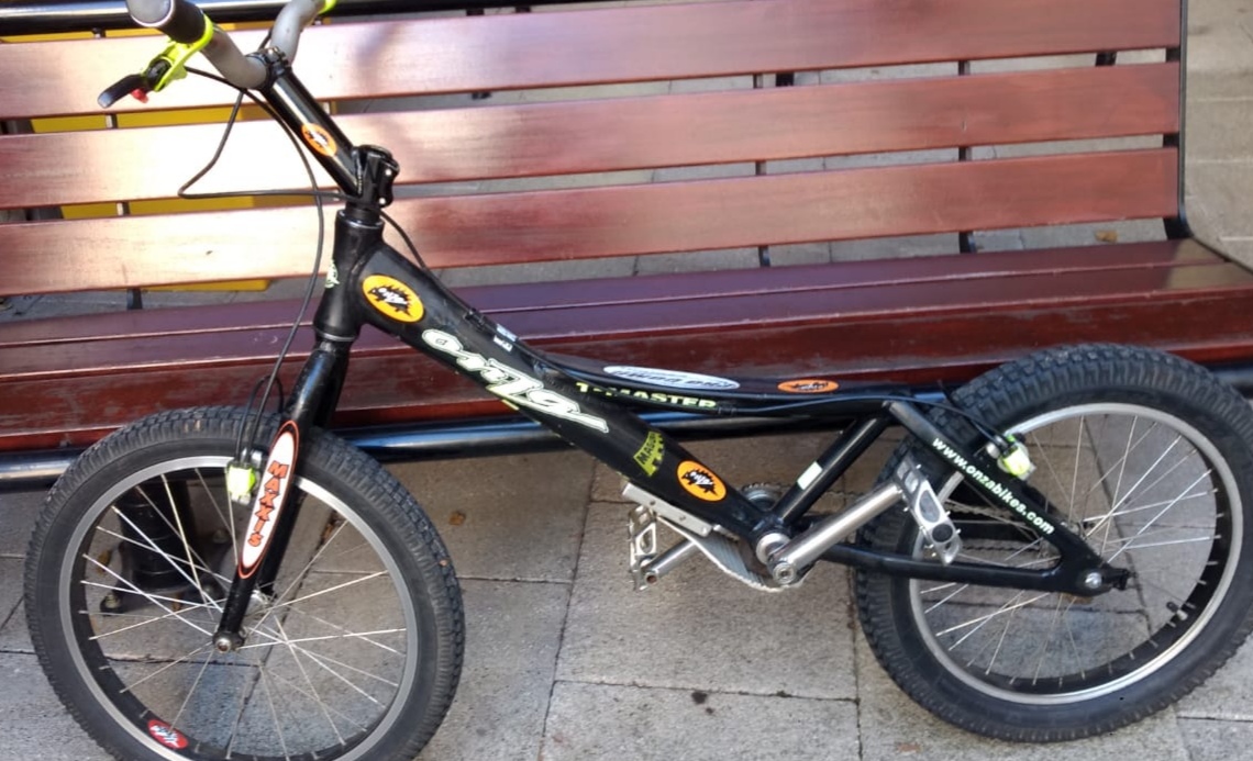

  6. PM'ed you mate. I cant send anymore messages as its apparently reached a limit... Its 100% 4 bolt. I don't have any bolts or spacers to attach the booster but willing to add on the cost if you have spares. I've attached a pic of the bike.... A work in progress!! The bike was in a total state. The rear brake was in complete bits due to the wheel clearly being 20 inch and totally misaligned. The freewheel is practically falling apart....
  7. Nice mate. Where you based? I'll collect. I took the HS33 completely apart. Scrubbed it down, pumped hot soapy water through the lot, replaced all of the hoses and rebled. It's better but now I think alot of the sponge is actually frame flex. It's pretty bad.
