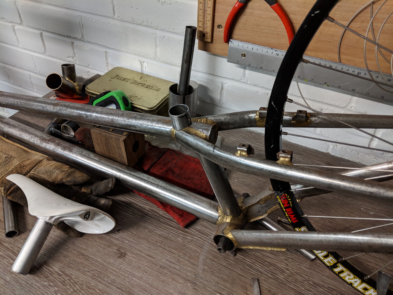

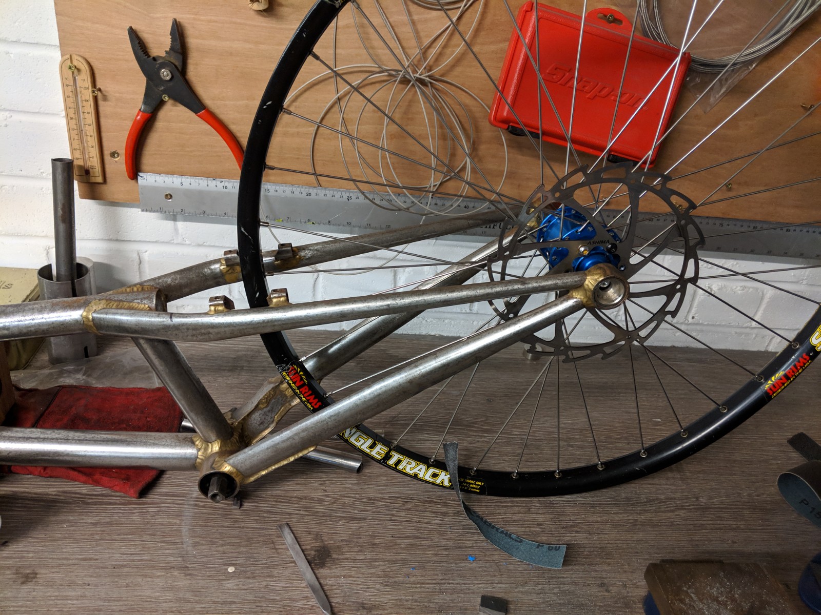

Nice! I have a 609 I picked up that is in the middle of a refurb, just need to do a bit of brazing and then get it coated.
Yep, I am not quite sure about how the frame came about, its not like any other leeson I have seen, must have been completely bespoke. I have everything ready now, just need a couple of hours in the garage to get it all brazed up!
The only bit I need to do now is make a small brace bar for between the rear chain and seat stay on the disc side. I was a little worried all the force just going into seat stay from the brake might damage it.

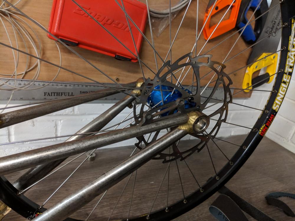

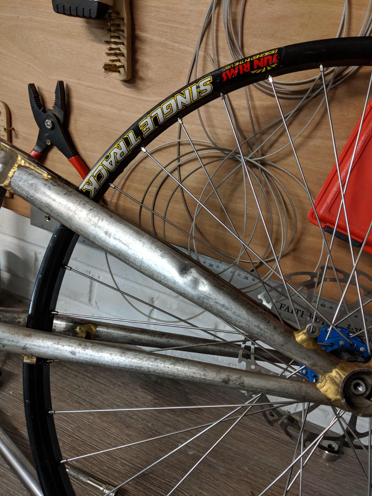

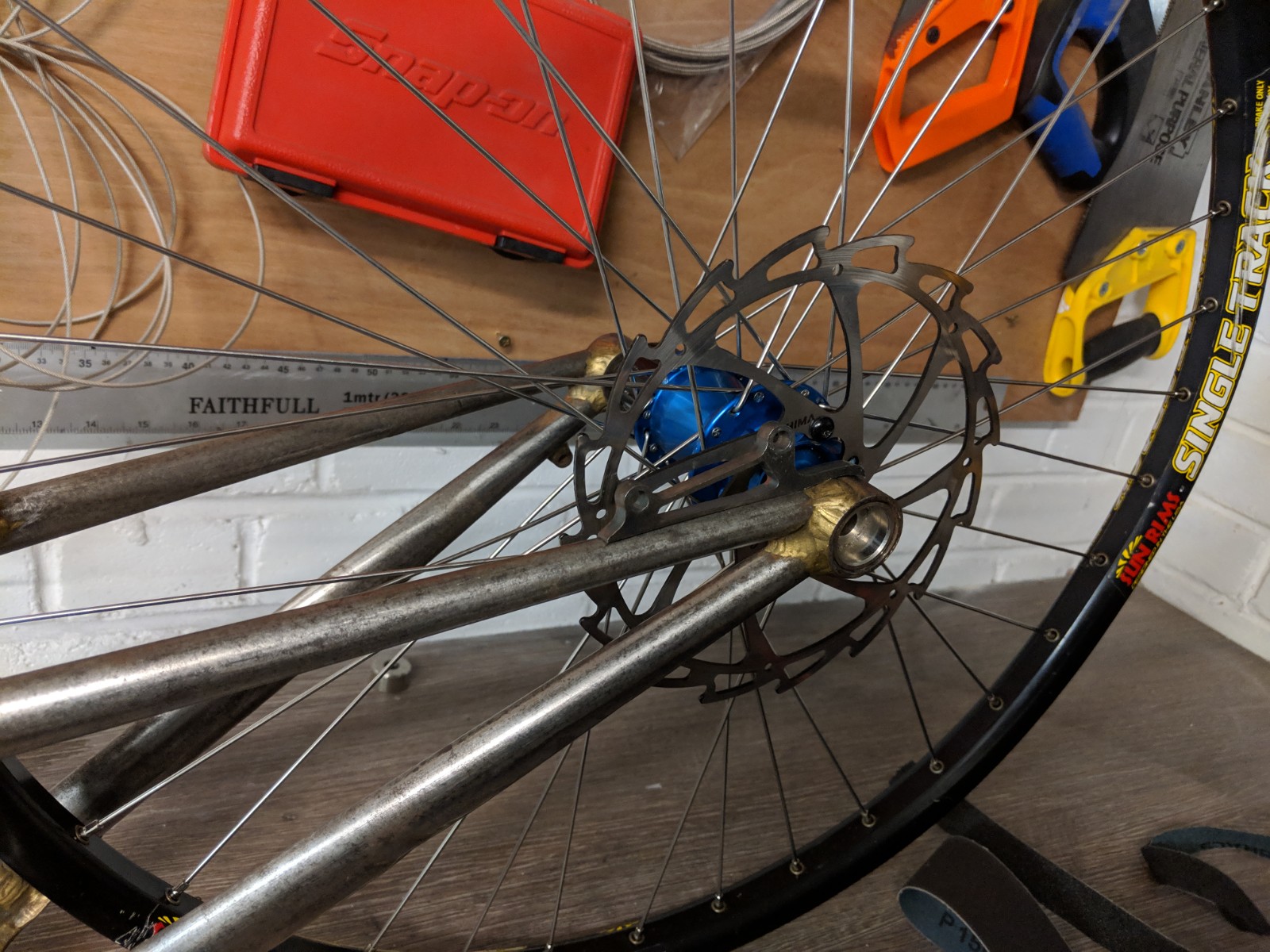

I bought this frame used from Julius Czar on here last year with the intention of building it with a load of parts I have left in the garage from years ago. However, my other half had a baby 4 months ago and I just have never found time until recently. I bought a new clear 660 about 16 years ago from Clive and I completely regret ever selling it so this goes some ways to filling that gap. It is not a "normal" clear 660 frame, I think it is longer and it has no seat. to be honest, I am well passed using magura rim brakes so I am adding a rear disc mount and I might just remove the magura mounts completely. Also I am not a fan of seat less bikes so whilst I am at it I am going to add a small seat mount and run it with one. The frame also has some dents in the rear stays I am going to fill these with braze and then sand them back so the frame will look good as new. The build is pretty old school as I am reusing parts from donkeys years ago. So far: Hope XC rear hub on a Sun singletrack rim Hope proII front on a singletrack rim Middleburn cranks. Slightly newer but I have a set of Hope Mono Ti discs for it. Stem and handlebars to be confirmed Forks to be confirmed (I am tempted to go with something more modern from inspired here.) I have made and filed the disc mount to fit, I have a small home made jig I have used before for centre and locating it. The seat post is mitred and a slot cut. So I am hoping to braze these on and finish it this week, I will also be adding some cable guides for the rear brake hose.... Frame as it currently is: Seat post made: Dents to be cleaned up: Disc mount cut to size and mitred:

Thanks for all the positive comments so far. There are a couple of bits I am already not happy with design wise, but this is the beauty of building your own, there is always something to change on future builds! I am going to fabricate some steel plate chainstay protectors and incorporate them into a reinforcing bridge so they all look slick. I built this frame around an old pair of middleburn square taper cranks. This meant I could try something with a 100mm bb, I basically have massive tyre clearance but the chainstays are dead straight so the rear should be mega stiff. This would limit future ISIS cranks but it was something I really wanted to try.
