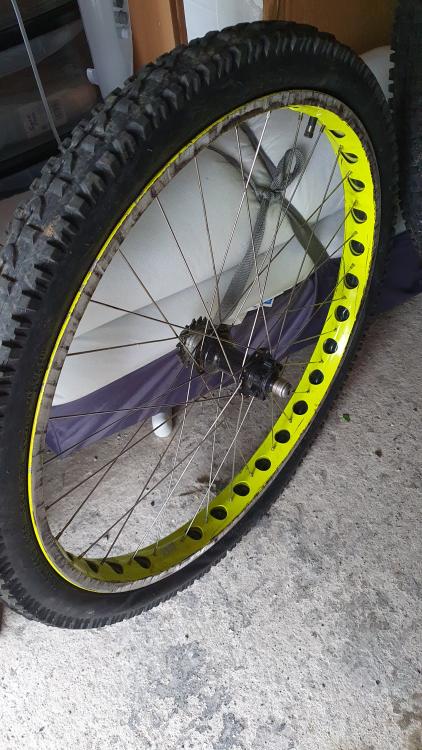

  7. Got the rear wheel sorted this weekend.

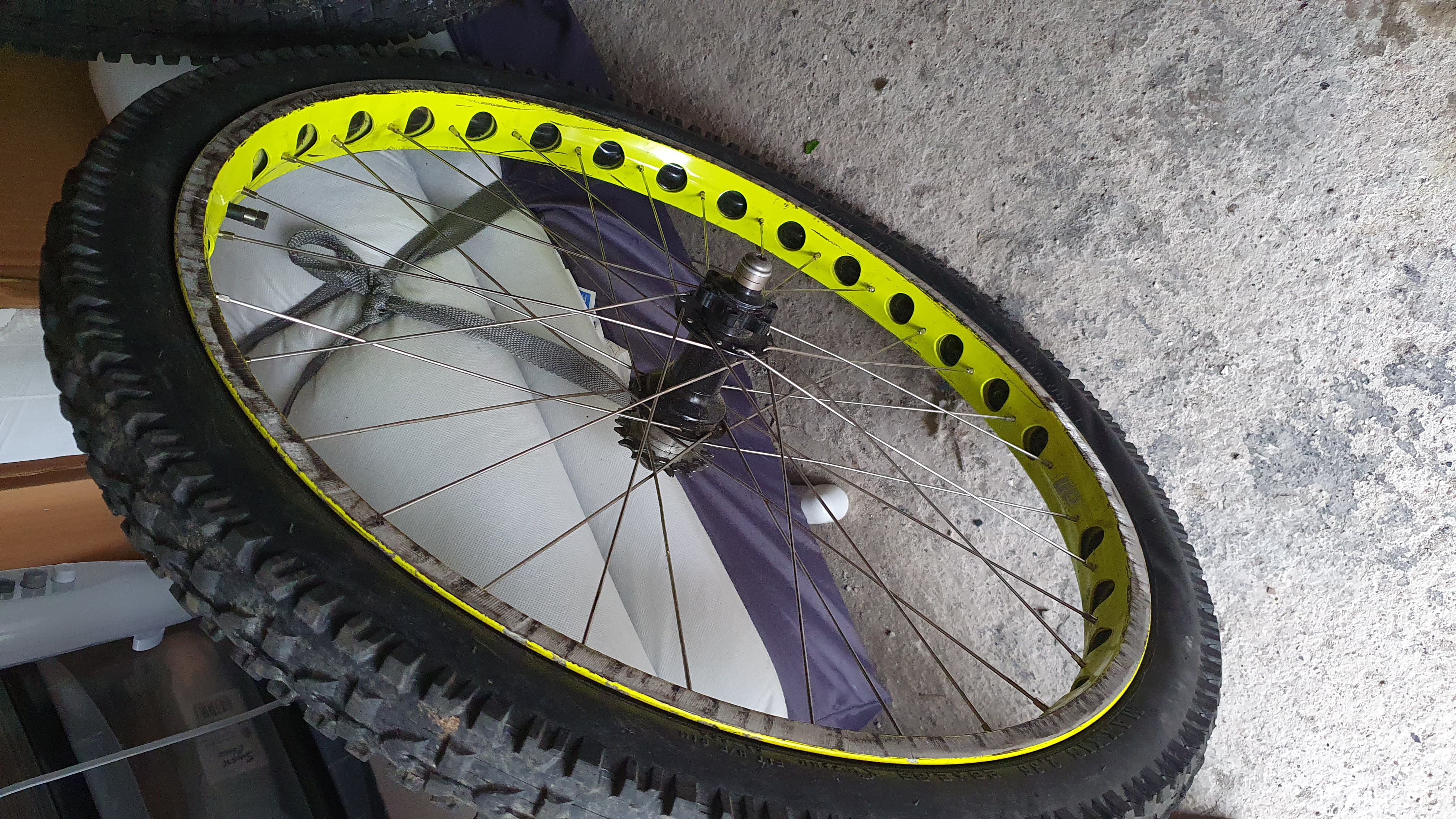

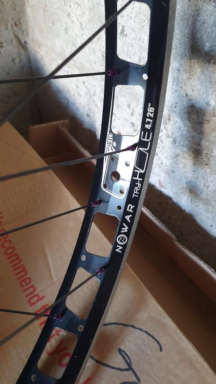

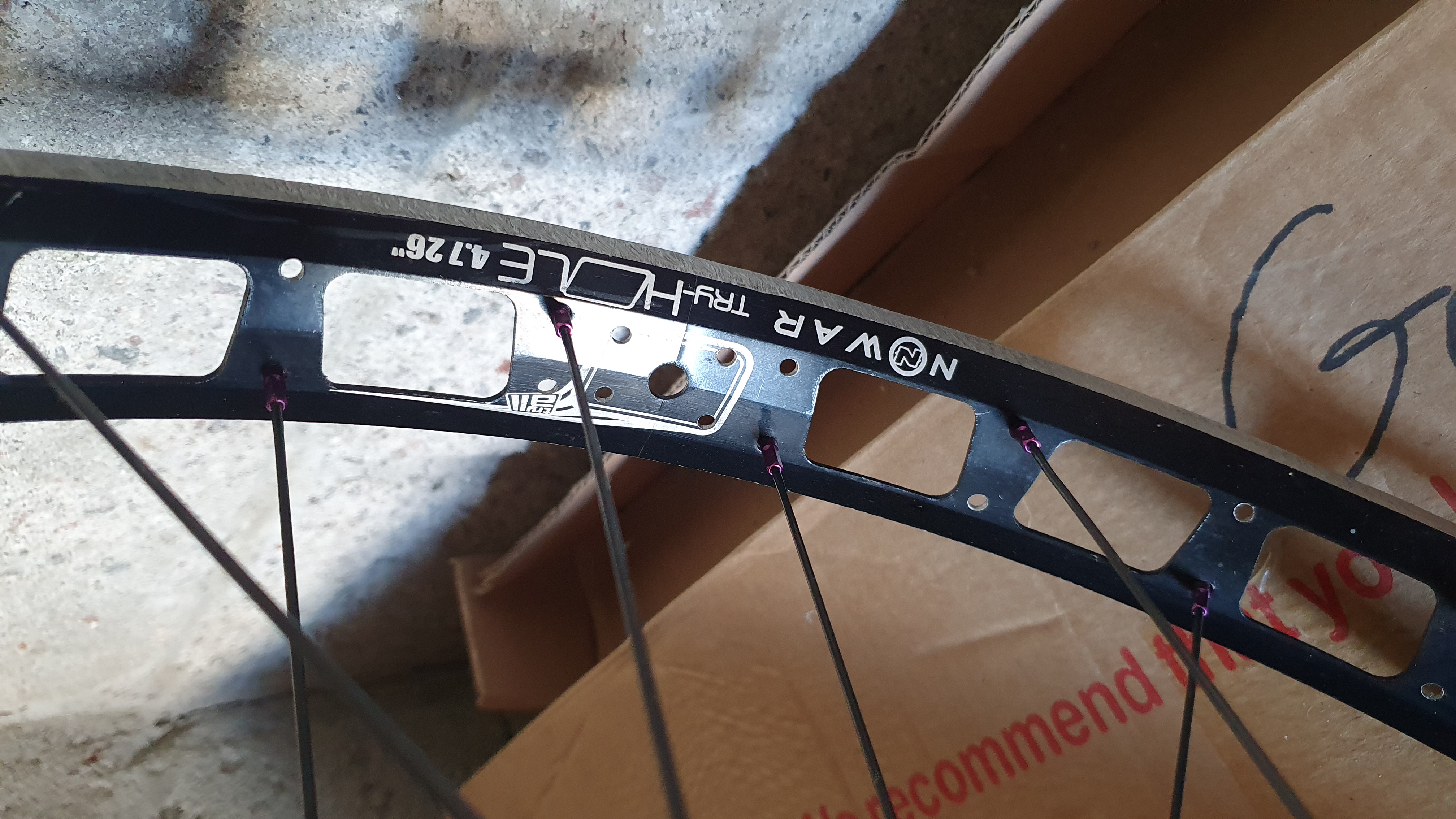

  11. Perfect, thanks guys. The rim swap is on! Was really hoping it was close so I could keep the awesome fluro rims!
  12. Hoping someone can help, I have an original Koxx/Tryall Fluro rim that I want to swap with an Tryall hOle rim, anyone know if the erd is similar enough to use the same spokes? These are the 2 rims: Something in my head is saying they were similar erd, but I am not confident to commit on that. Lol. Thanks Adam
