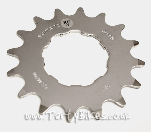

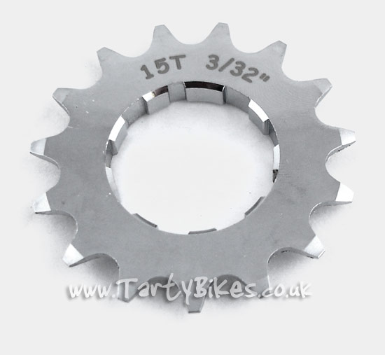

Thankyou for that. Is the bachelor that much better than the 1er and worth spending the extra on? I'm just thinking if it does feels pants its less of a loss to go with the 1er - but at the same time, i'm not going to skimp on my bike...
As you can see, there's a fair bit of difference just from looking at them:
The Bachelor has a far wider base which'll stop it digging into your freehub body (especially if you're cranking around with 18:12 on :P), and it should last longer in general.

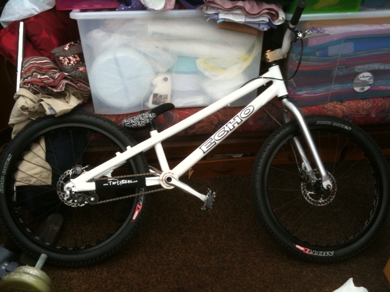

Just built up my 24 literally 2 days ago and im running 18/12 on it. I was going to run 18/13 but my mate who runs an inspired reckoned it would be way to easy to ride anywhere on so got the 12 and thats perfect - still a little quick if anything but I ride alot of street. You are making the right decision to run it I reckon!
