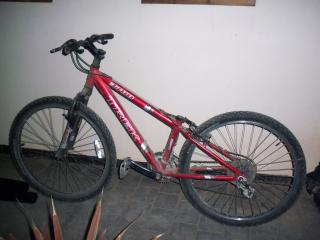

I have fixed the puncture on my MTB. It is a Trek 3700. There is a picture of it below.
It doesn't have a front brake as I took it off as the front wheel is buckled so when it went round it kept moving/touching the brakes. I am guessing it would help with a front brake?
I quickly just took it out and found a small step (about the size of a pavement ledge) and just slowly drove into it, back brake on and lifted the front wheel. It came up suprisingly easy. I could balance for about 3 seconds but then the front would go down. What should I do to stop it going down?
I also really like the front suspension as I can use it to take the shock not just using my body.
I want to be able to balance on my backwheel so I can jump from a ledge to a ledge, or just drop off and land on the back wheel. Is this possible with my MTB?
Would this be suitable as a trials bike? If it helps, I could get a video of me 'attempting' to do the above, that way you might be able tell if it is suitable or not.
I will be riding it around a farm, which is mostly concrete. I will hopefully be jumping off walls, going over and around obstacles, jumps, wheelies, that sort of thing.
The only two problems I have found so far are:
1) I sometimes smack my knees on the handbars
2) There isn't much ground clearence. Is there a way I can make it have more? I was thinking if I could just have one crank (is that right, maybe front sprocket?) instead of the three that are on there. I only really use gears 1-7 anyway. Unless I am getting a lot of speed.

Started on an x-ess too...if you learn the basics on that, then move to a trials specific rig...in my opinion you'll end up a better rider :)

True your front wheel...practice everything on www.trashzen.com
Ride it as it is!!!
Save your pennies, when something fails replace it with a decent trials specific part!
Damn straight, best way of doing it :)
Just kill it, then replace with bits as needed.
Also started on a Trek. Which held surprisingly well, considering the XC Racing rims.
1) true front rim and get a brake
2) adjust both brakes so that they bite and lock well. i.e - both pads touch at the same time, and all pads makes contact with the rim at once (sometimes they're a bit angled to help with modulation).
3) start by practicing rear wheel hops by leaning forwards with brakes locked, then rocking back. get the balance right. improve your balance by practicing Track Stand for a few minutes each time... it pays.
4) move on to pedal kicks, hopping on rear , bunnyhops and such...
enjoy

You'll find you'll spend nearly that much sorting the front wheel out, gettin some half decent brakes and setting your trek up to single speed.
You really wanna get rid of the forks for some rigids to start with, ditch the biggest chainring, cut the teeth off the middle and fit it where the big one is currently to serve as a makeshift bashring and get the front wheel trued by a bike shop an get the brake back on an setup nicely.

a) you dont true the rim, unless you have some experience. Basic truing is so difficult, but you should have some idea of what you're doing. Its a simple and cheap procedure at a local bike shop usually. you can also check some online tutorials, there are plenty (check out the website of guru "sheldon brown"). And again, do it with care, its easy to do more damage than good if you're rushing it.
B) i've used Avid Single Digit's and they're brilliant. any decent V brake will do, its mostly a matter of setup and decent pads. V brakes lock really well when dialed.
c) at first try little hops going backwards, while pulling the bars towards you. start with arms stretched, lean back, and when you're at the sweet spot pull the handlebars a little bit towards you. rear brakes lock, yeah? that should get you hopping a bit, usually backwards. when you're comfy with that, u can start pedal kicks to get the wheel up. and yeah, hopping in place is easier than standing on the wheel motionless (ever tried a pogo stick?)
There are tons of tutorials - everyone started from something! just google, and soon enough you'll be elbow deep in them.
d) track stand- when you stand with the bike in place, pretty much motionless. both wheels on ground. great way to improve balance and THE basic trial move i guess... (at least until i get the hang of tap ups)
