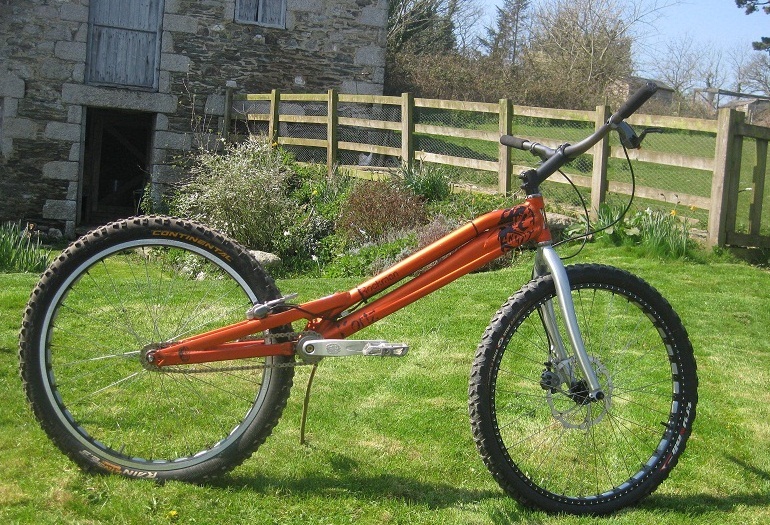

Hey Guys, I have been told that it is OK now to show people the frame i have been riding for the past 4-5 months, this is the new kortz 2 frame, the frame has been improved alot, and the geometry is very nice at 1095mm, +60, 380mm and 72deg head angle (with koxx disc forks), the frame is due for release within the next 3-4 weeks.
Pics:
Current Spec:
Rockman Proto Kortz 2 frame
Koxx disc fork
Front echo TR hub on custom milled DX32 (Single walled, large square holes and sidewall drilling), try-all tyre
Rear echo TR hub on try-all hOles rim, continental rain King tyre
Rockman Cranks, Echo SL free wheel and cut down atomz bash between the BB and frame
First 128 IRB BB alu bolts
Magura HS33 rear with 4 finger lever, chorillaz TPA CNC rock pads, cut down RB booster and home made splitter.
Magura Louise Carbon with 200mm aztec wavey rotor
Welgo MG1 Ti pedals
Echo SL headset
Rockman handlebars
Tartybikes 15 x 125mm stem.
Hope you guys like the frame, They are Aiming to be released within the next few weeks, I am un-aware of the final colours or graphics but the frame will look like this.

Looks beefer than the original Kortz, so should be strong enough for street bashers yet remain light enough for comp use. Will interesting to see the final colour scheme, though this kinda bronse/orange finish look sweet enough (Y)

how has the frame changed adam to be beneficial to the rider?
is it geometry changes? structural changes? purely just aesthetics.
cant say i am a fan myself, but do weirdly like the orange. get a video out...
There are alot of Changes Ben:
Geometry is slightly different to the previous Kortz, 1095, +55, 71deg for the original and 1095, +60 and 72deg for the new one.
Structural changes: They have raised the seat tube meaning that the angle where the seat stays meet the top tube has been reduced, this is where previous kortz frames had failed, this current frame has lasted longer than both of my previous kortz frames did, There are new dropouts which still have the integrated tensioners but are much more compact, it has the 2 piece hollow yoke from the slate 2 frames, different booster setup to the previous kortz and also a pretty sweet hydroformed downtube which has a flat underside which seams pretty resistant to dents!!
I might have time to make a quick video, I am not sure, as I will be recieving another proto soon to test. I will see what I can do!
Hope that clears a few things up.
Adam
Well you know i like it, definitely looks and feels sturdier than the original Kortz, the geo feels nice too :)
If you're about this weekend, go for another little ride mate?
I certainly Will Craig,Gimme a shout when you are down here! We shall go ride some rocks somewhere!
Adam

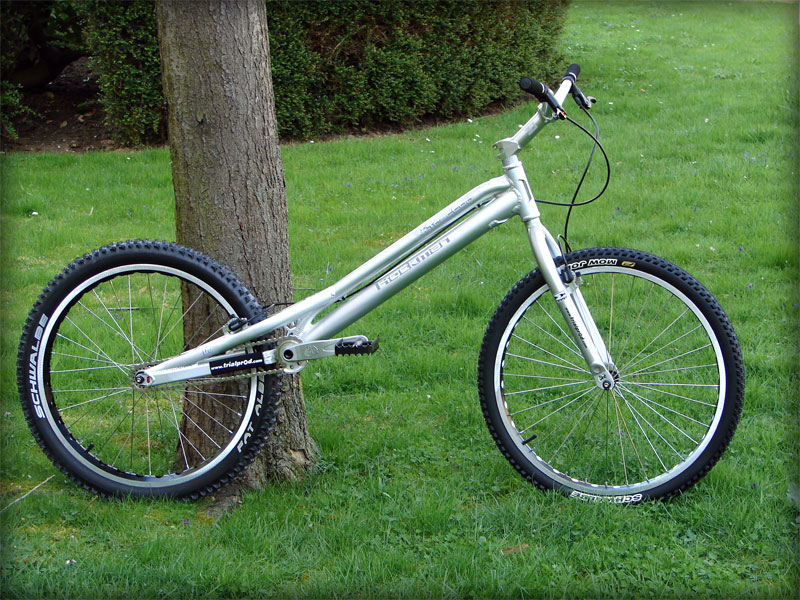

Oh right fair enough. You've gotta admit it does look like the tractor.
It does yes, BUT the original kortz, as below:
Was released last spring, so has been out way before the traktor frame.

Looks to me like it will crack at the top of the seat stays just like the old one. bet it rides nice but there just not built to last B)
I have been riding this frame for 4-5 months now, the previous frames l lasted me a maximum of 2 months each, and this one is still going strong, So I am sure it will deffinatly last longer! The angle between the seat stays and top tube has been reduced too, which has made a massive difference to this.
