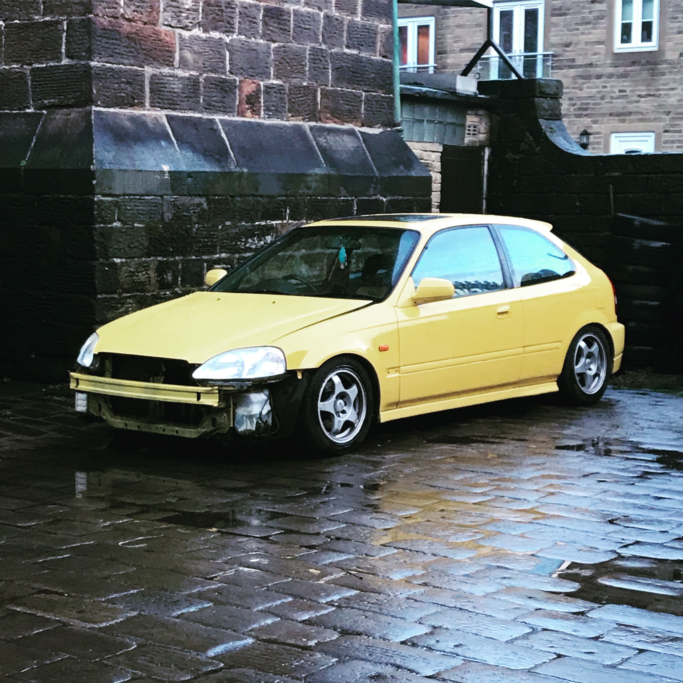

Finally got to doing something on the new Civic this afternoon. Side skirts removed to reveal the cleanest sills I’ve ever seen on a 96-00 Honda Civic. Over the moon.
Also got the front end off and gave everything a de-grease and steam clean in prep for two small patches that need welding into the inner wings.
I hope to get the dash board and all the associated wiring out over the coming week in preparation of swapping the current coupes wiring in when the time comes. There is differences in the wiring in these cars being different ages and I want to avoid buying another K swap conversion loom at almost £400..
Fuel and brake lines to remove along with the fuel tank before I cut out the spare wheel well and flat floor it to mount the swirl pot and pumps.

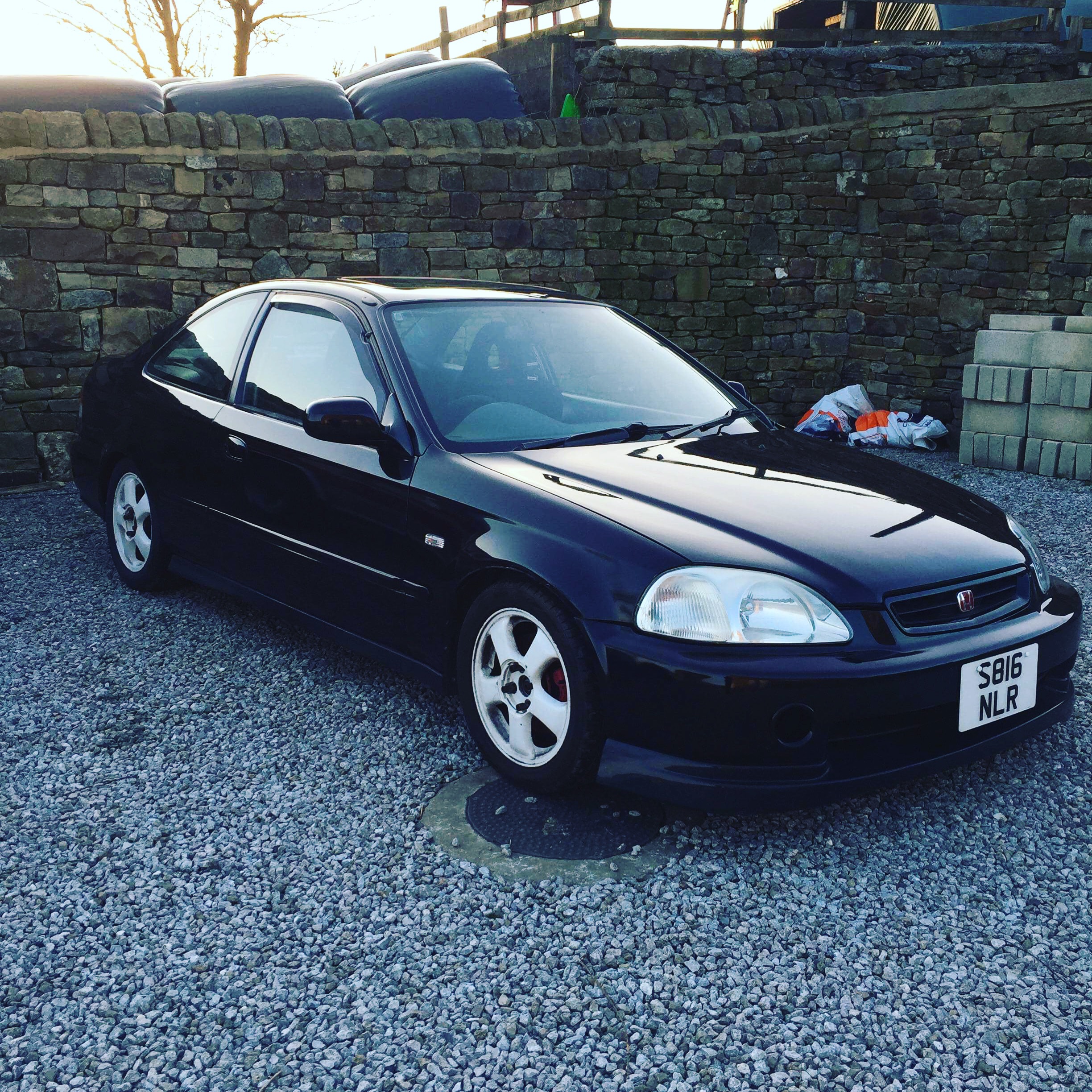

A day trip to Bedford and a half tank of fuel later, I was the owner of another LCR. It's by no means perfect, but given it's 15 years old I can forgive a few niggles and I have a spare car to pilfer parts from now anyway. Having wanted a PG LCR for the better part of a decade I have finally ticked the box, and it's given me the bug again which can only be a good thing.
The car has covered more miles than I'd have liked at 150k, however when driving it feels as tight as any other 1.8t I've driven and there's a reasonable service history with it, showing a cambelt and waterpump change in Oct 2017 which is encouraging.
