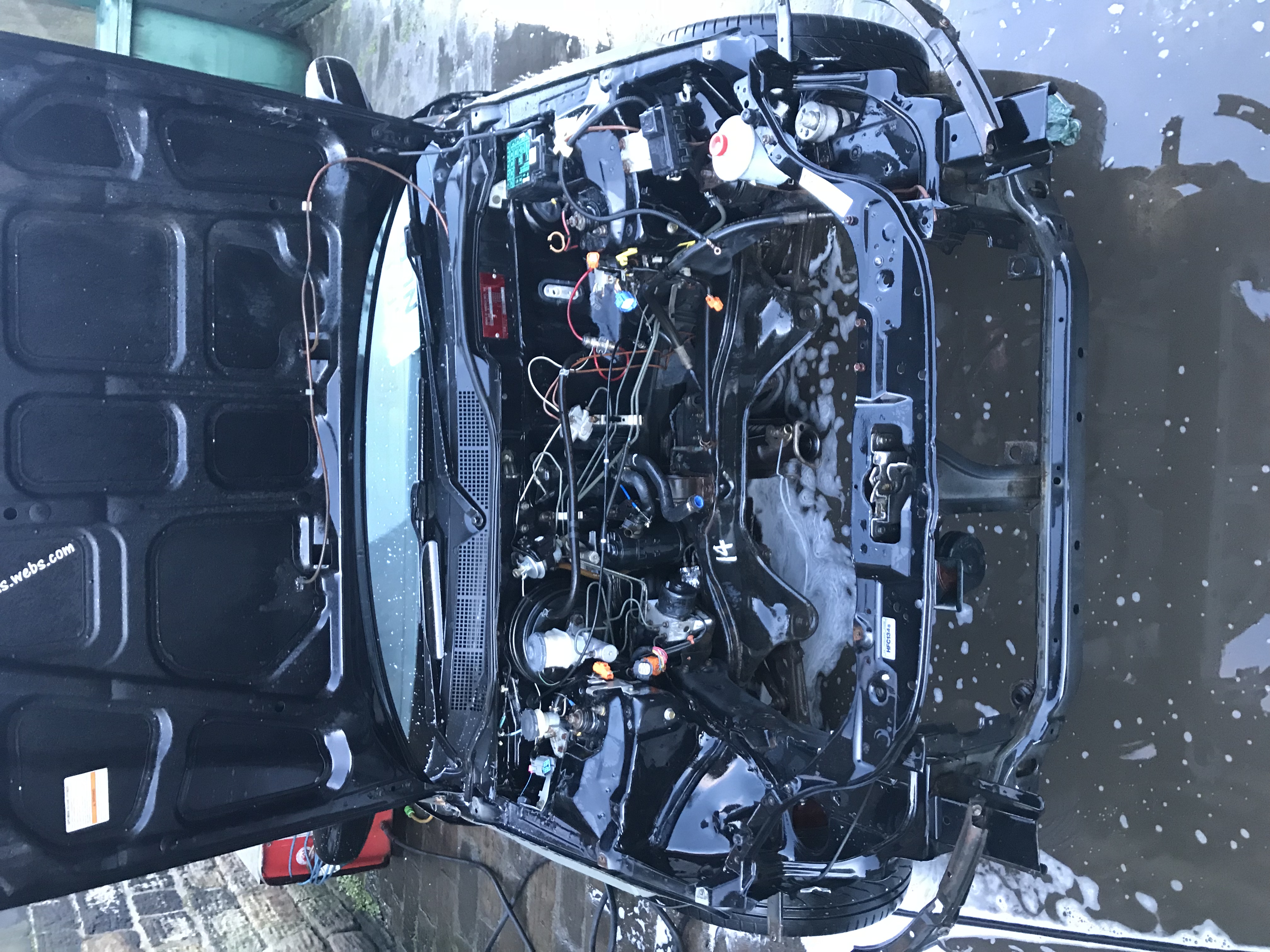

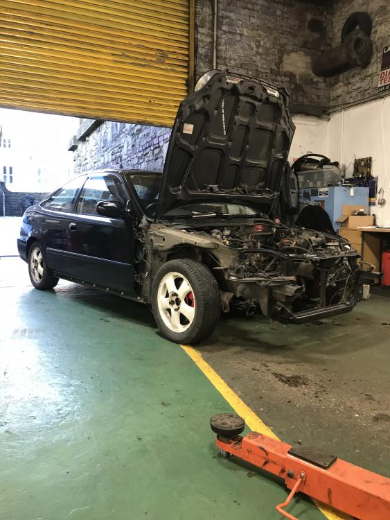

Inner wing to finish, all old brake lines off along with the master cylinder/booster and get all the interior out. I want to get it ready to accept an engine next weekend if possible!
