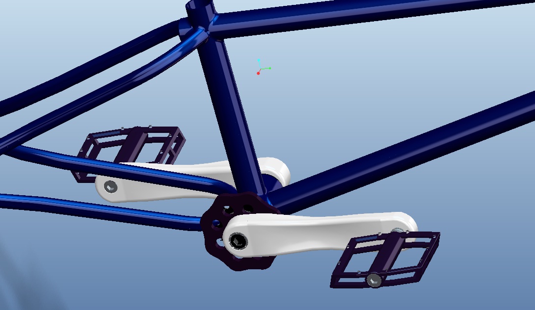

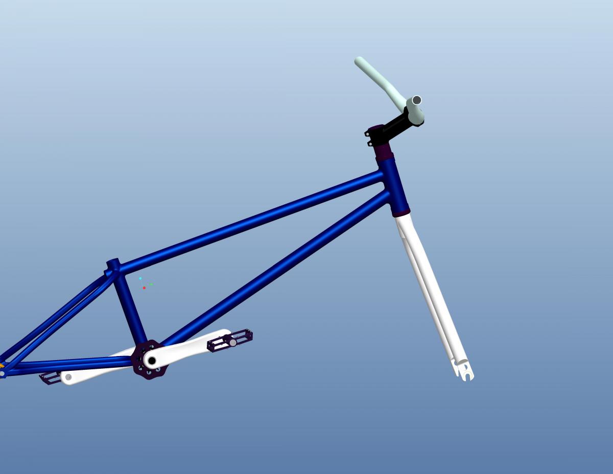

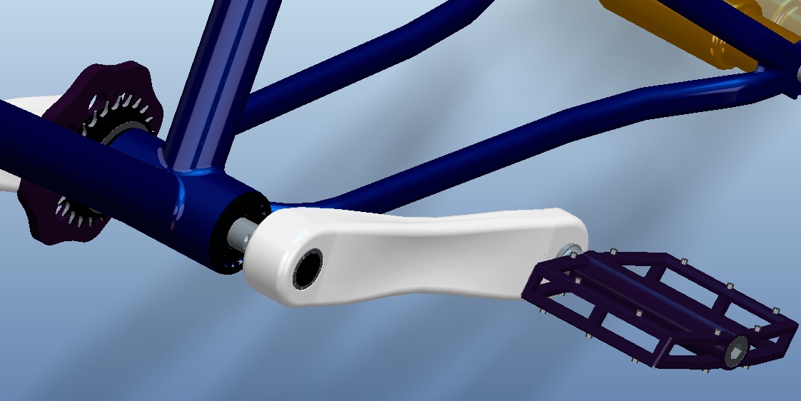

Finally got round to doing some more stuff. There's some dodgy dimensions going on here but lets ignore that! The cranks look a bit fat, mostly because everything else was designed overly thin. I realise that the bb isn't very accurate, and there's too many teeth on the freewheel, but I'm not too bothered about these things. Continuing with the purpley white colour scheme for the time being but I'm not sure what I think about white cranks...

Nice! Cranks look like they've got a pretty nice profile. Pedals are pretty sweet as well. I'm considering putting a full bash ring onto my model, although other than that there's not much more I can add - my computer can't take much more and it already takes several hours to render anything :P
I'm tempted to make a street orientated frame, possibly with Inspired like geometry. Then I get the fun of modelling a seat >_<
Some sort of alu street frame would be cool to see, a seat would be easier if pro eng would work the way I want it to! The swept blend tool only let's me create same profile sections, whereas I thought the whole point of blend was to enable you to go from one shape of profile to another. I need to watch some more tutorials to see what's possible.
