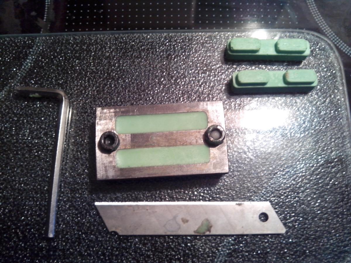

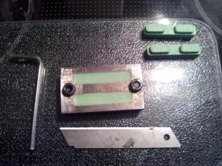

in terms of pouring and setting : about an hour, cutting the backing shape ect : 20 min...my index fingers are right to be scared of stanley blades, cut myself making the last set haha
vacum forming a mould would be a hell of a lot cheaper than cnc too, plus the initial blank isn't too difficult to make with balsa wood or something :)
with a resin that has a handling time of around 2h you´ll be having far less bubbles without doing anything,the bubbles have time to rise and pop.
just saying ;)
look what i am doing right now,
post-30389-0-02171200-1399141710_thumb.j
first green ones with the good stuff.i had to change the receipt to match the amount of pigment added,too much of that stuff and it doesnt cure fully,bubblegumish pads then lol
whats the wear like on your pads with 70a?
on my 85a ones its pretty much non existent yet,after 3 rides though.
thought i´ll be glueing pads into the backings 24/7,but surprisingly still running the first set lol
Edited by FamilyBiker

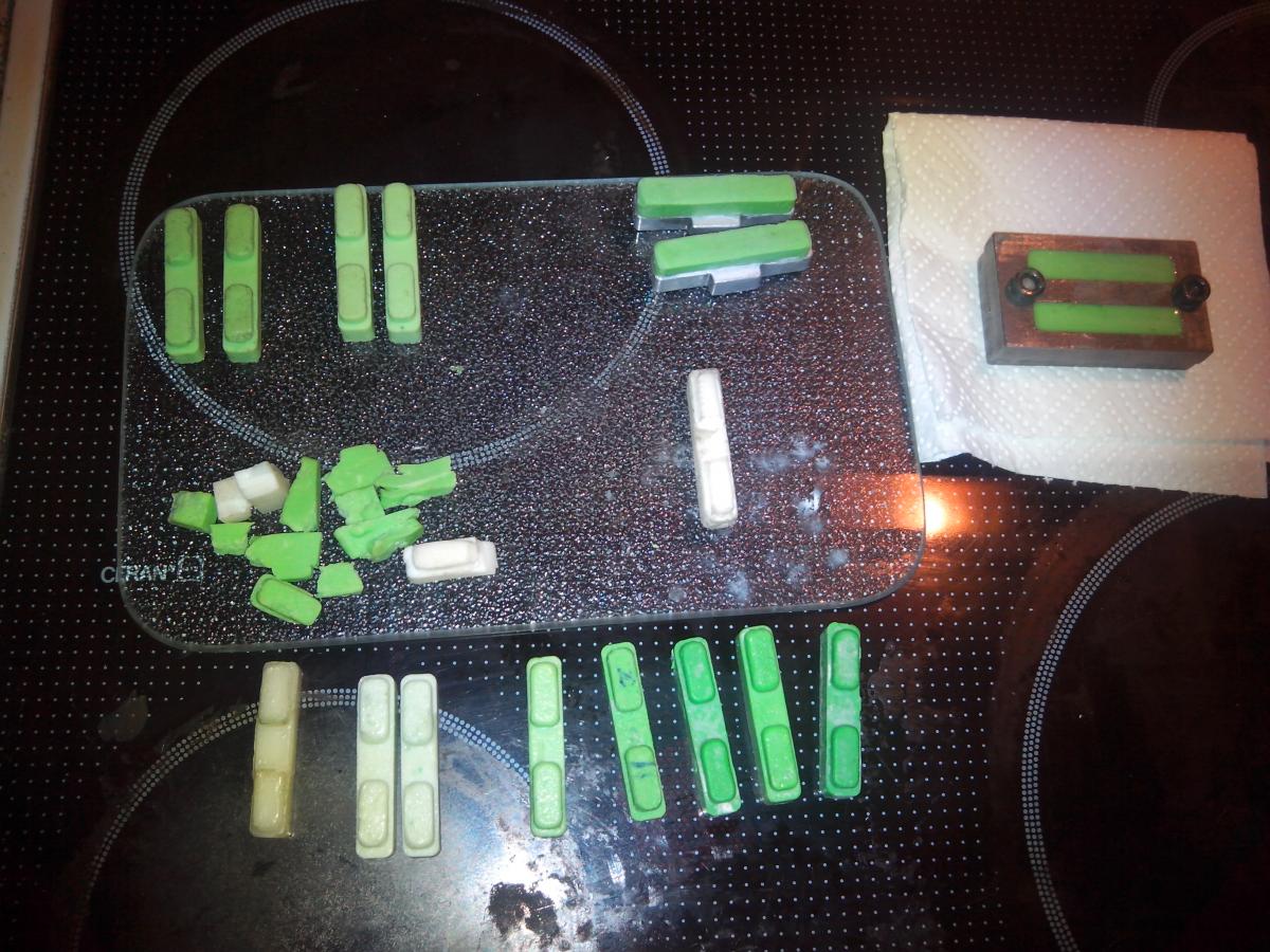

i went through a huge amount of research now,on the bottom you see different pads,every one was another compound,and i made 2 sets of every compound.
then i cut one pad in half to see how consistent (air trapped,colour inconsistencies) the compound is and kept the single pads for future purposes,while riding a set of each during every of that processes
post-30389-0-43176300-1399237204_thumb.j
thats 8 different rubbers and compounds of each i´ve tested,with number 9 being the first of the new rubber,and number 10 being my personal "bullseye"
i went through 100euros to achieve this,so:
