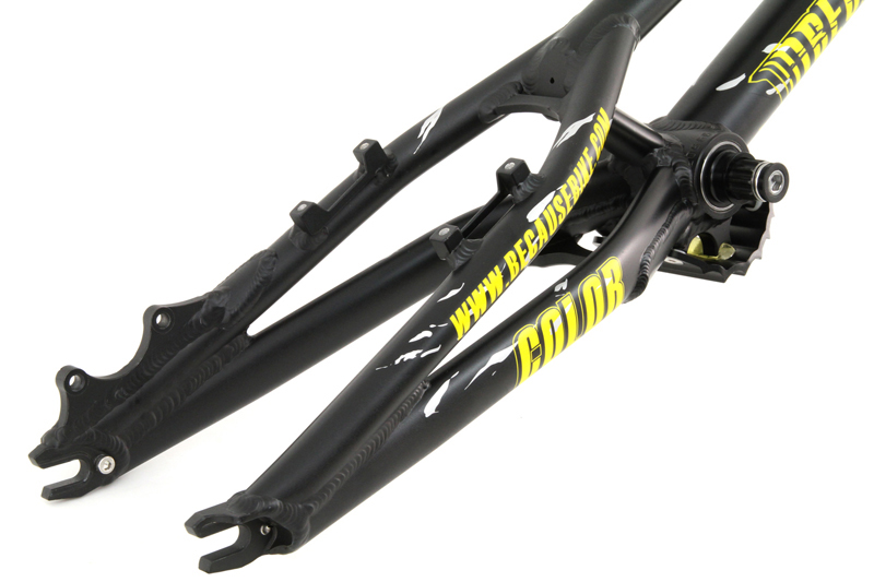

Yeah, frames will tend to have a little bolt hole down by the dropout for you to put the snail cam bolt in - you can see them on this frame here:
Theoretically you could just drill your frame out yourself is the dropouts have room, but if you're running chain tugs at the moment then I'd stick with them (Y)
