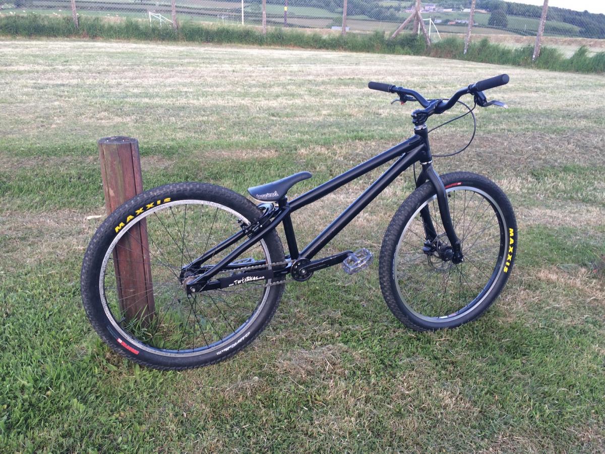

Mikee Posted June 10, 2015 Report Share Posted June 10, 2015 Had this frame lying around for a few months whist I had some fun on another frame and because I was making up my mind what colour to paint in. After lots of thought though, I chose the boring option and went black. I'm still not 100% happy with the set up as an allrounder. I had similar feelings last time I had it built. I think the bars, stem or both are wrong, so i'm going to have to have a play. 1 Quote Link to comment Share on other sites More sharing options...
bing Posted June 10, 2015 Report Share Posted June 10, 2015 Think stuntman terry runs a 90x35 and tactics on his hex, seems to do quite a bit of tgs stuff on it as well 1 Quote Link to comment Share on other sites More sharing options...
LEON Posted June 10, 2015 Report Share Posted June 10, 2015 I'd say the front's too low, looks good though. Quote Link to comment Share on other sites More sharing options...
Mark W Posted June 11, 2015 Report Share Posted June 11, 2015 Yeah, I'd go with that as being the issue too. On old school bikes you could get away with low/long stems, but with the greater BB rise on the Hex you need to bring the bars up a bit to get it to feel a bit more lively. A 90x35 stem and/or some higher rise bars would probably do the trick. Quote Link to comment Share on other sites More sharing options...
Ross McArthur Posted June 11, 2015 Report Share Posted June 11, 2015 I'm split on the matte forks with gloss frame. Not sure whether I like it or not. Echo what peeps are saying. Higher front end required. Nice build other wise. Quote Link to comment Share on other sites More sharing options...
Mikee Posted June 11, 2015 Author Report Share Posted June 11, 2015 I'm split on the matte forks with gloss frame. Not sure whether I like it or not. It's not as glossy as it looks in the picture. The frame actually has quite a matte finish, but I think that because the paint is smoother than the forks, it is reflecting more light. Quote Link to comment Share on other sites More sharing options...

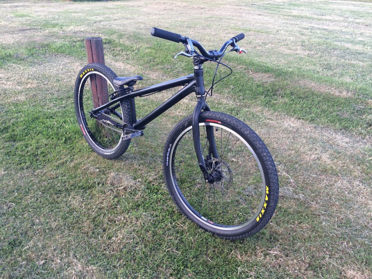

Ross McArthur Posted June 11, 2015 Report Share Posted June 11, 2015 (edited) How's the front brake? Don't see 160s on 26" that often. Edited June 11, 2015 by Ross McArthur Quote Link to comment Share on other sites More sharing options...
Mikee Posted June 11, 2015 Author Report Share Posted June 11, 2015 It's a fantastic front brake. It isn't 160 though, it's 180. Quote Link to comment Share on other sites More sharing options...
Ross McArthur Posted June 12, 2015 Report Share Posted June 12, 2015 Eyes why you so shit. Quote Link to comment Share on other sites More sharing options...
Mark W Posted June 12, 2015 Report Share Posted June 12, 2015 My eyes are so used to judging rotors on 24" wheels now that when it comes to 20" or 26" I pretty much have no clue... 1 Quote Link to comment Share on other sites More sharing options...

Mikee Posted June 26, 2015 Author Report Share Posted June 26, 2015 As you guys recommended, I have got a 90 x 35 stem on it now. After having a little play on the pavement outside my house just now, it does feel better. However I still think that steep stems look crap. I may have to get some new forks and go back to my hope stem with some stackers at some point. Too bad I cut down my inspired forks for my justice a while back. Quote Link to comment Share on other sites More sharing options...
Mark W Posted June 26, 2015 Report Share Posted June 26, 2015 I think you'll get used to the looks of it - I did after switching to a 70x35 after years of running a Hope stem. Which model did you go for? Quote Link to comment Share on other sites More sharing options...
Mikee Posted June 26, 2015 Author Report Share Posted June 26, 2015 I have no plans for doing it soon, so I will have time to see if it does grow on me. Which model did you go for? I got the trialtech forged one. Since a lot of the parts on my bike are trialtech, I thought I would keep with the theme. Quote Link to comment Share on other sites More sharing options...
