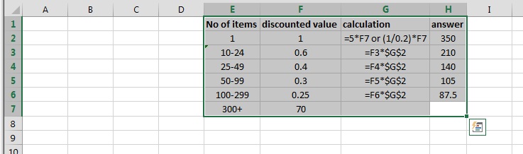

Edit: For any discount amounts the above way is probably the way to go and use something like the following:
post-1823-0-11173800-1434454746_thumb.jp
So all you need is how much you want for 300+ (or whatever) items and a discount 'curve' for the various quantities (including the maximum allowable discount for the 300+) and you'll be able to work out the respective values from there.
Awesome, thanks to you and stirling!
Just one question / comment on your screen shot though - the formula in there looks wrong and should create a circular reference??
