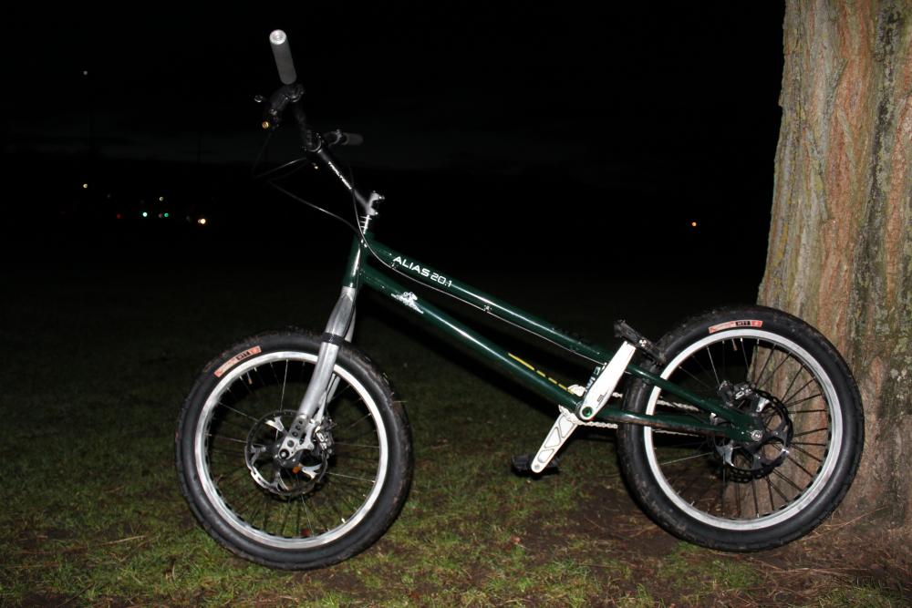

Ive finally got my alias at the stage where i want it. just a few tiny details left.
brief spec
Saint m810 brakes
180mm ice tech rotors
trialtech everything
hope rear hub/bar ends
i moved back down to a 180 at the front as the 203 would have been just death

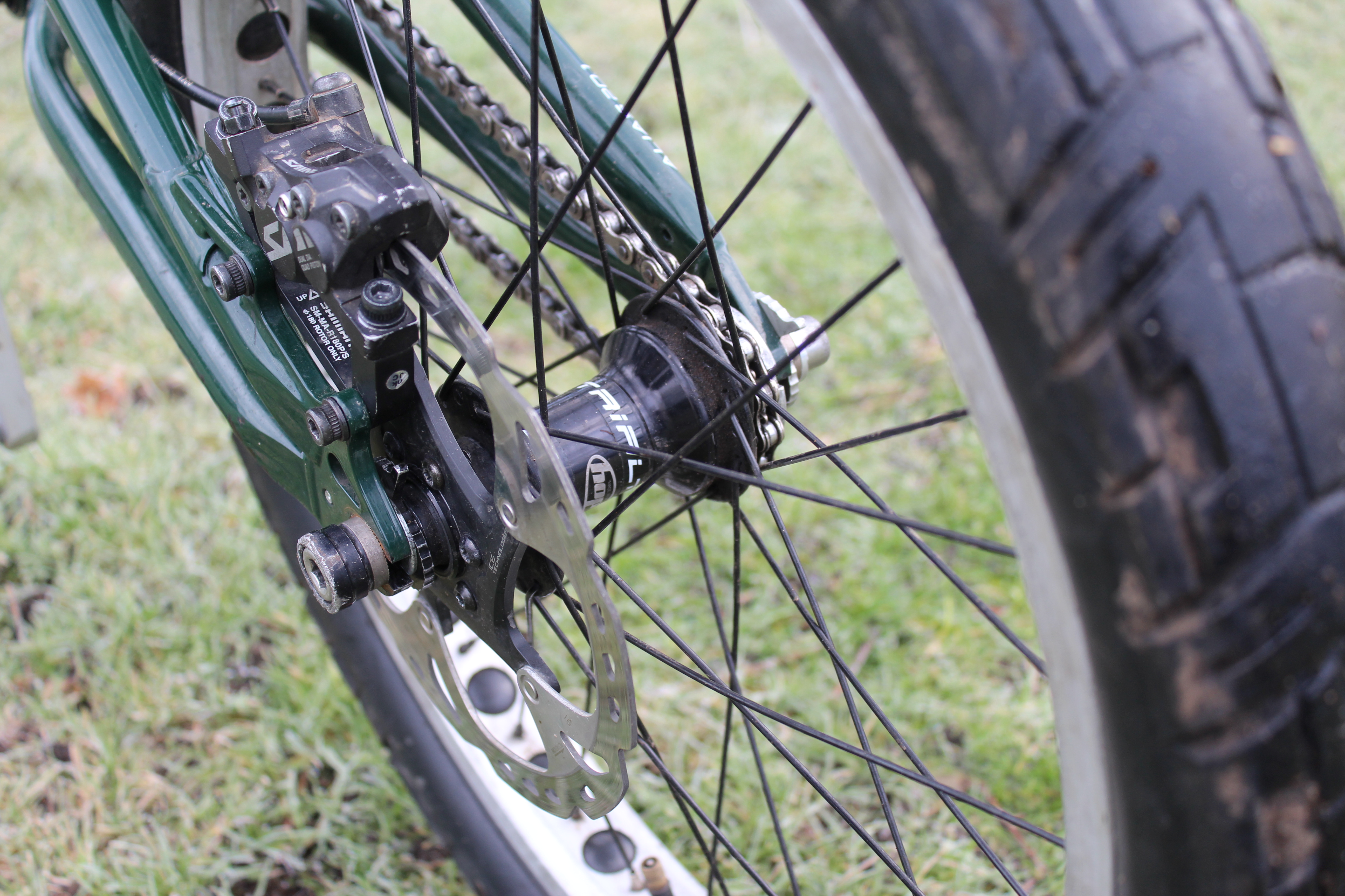

Very cool indeed, is the rear hub spacing 135mm or 116mm?
If 116 then how did you get the hope hub in there? If you've done some sort of hub modification, please tell! B)
its a 116mm spaced frame, with a custom 110mm pro2 evo ss! (plus cams/ disc spacing)  machined axle, bearings relocated, freehub machined down and threaded for an external lockring, disc tabs and end caps appropriately modified/machined. which means theres absolutely zero dish :D all done by alex.
  • Like 2
1 minute ago, Cyder man said:
Thanks for the info... Was that an expensive process? The reason I'm asking is I'm toying with the idea of getting one of these frames at some point and a hope hub would be awesome... :D
it was reasonable. especially for the amount of work done. there were a few niggles i had to fix, but they were very very minor and it was alex's first time doing the 80ep hub. as far as im aware, josh leech did flipps rear pro4 in his.
