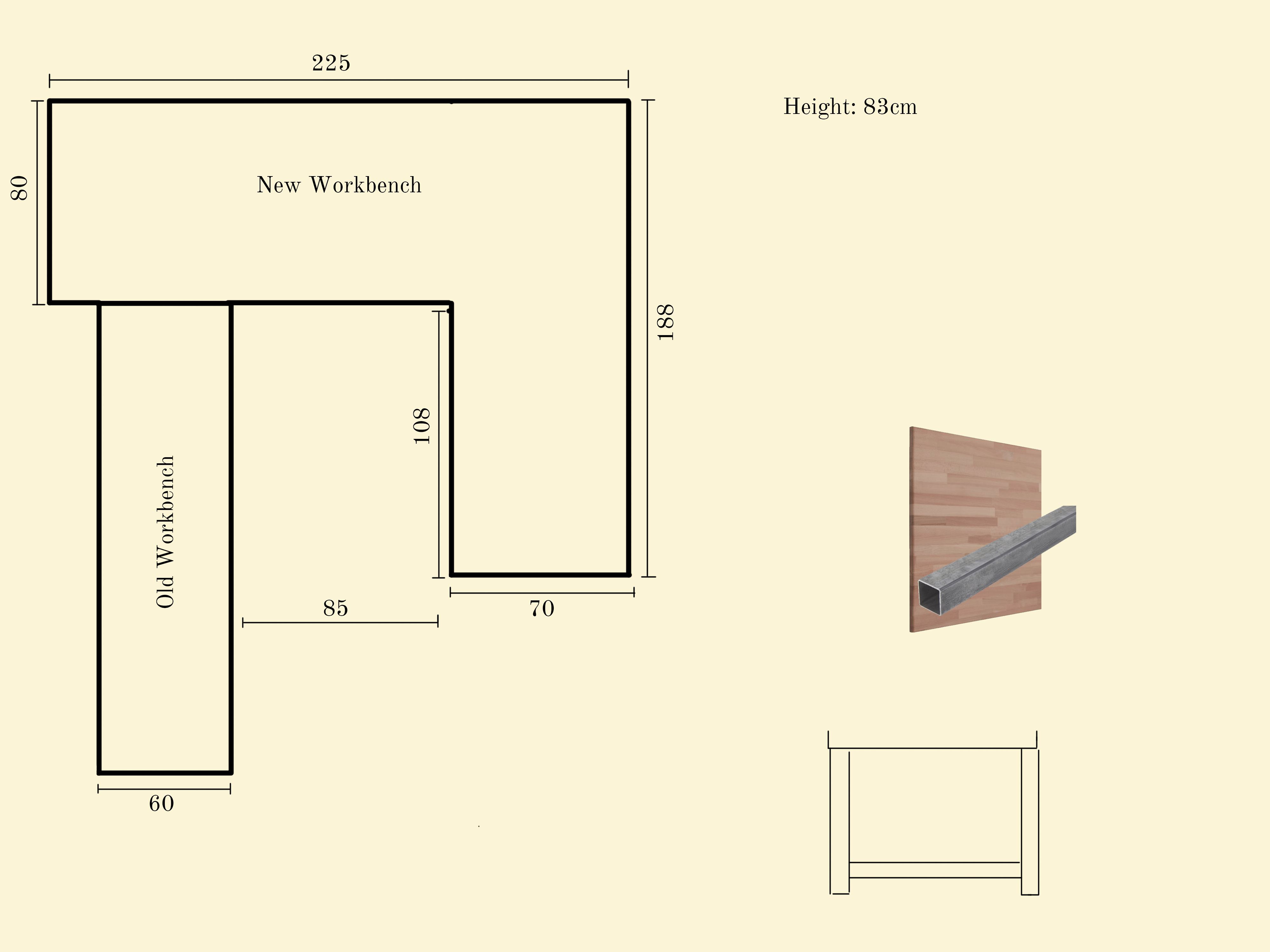

I need to make myself a new workbench to accommodate a new lathe, but before I can show you anything I'll best ask a question or two.
There's a wardrobe that needs to come away to make room and I thought I'd best got for an L shape resulting in more storage for the things that are in the wardrobe under the workbench, and enough space to expand with more tools etc.
I was thinking of box section steel and some kind of wood top, dropped (and bolted) into steel angle.
It'd be very nice to have it all welded but I don't think that's possible. Obviously I'd make two rectangular tables, not an L shaped one, but I don't believe it'd be possible to get it down the stairs and round the corner in one bit, and I can pack my things if I try welding anything inside the house. Maybe, just maybe I could get it in with the legs welded onto the top, leaving just the bottom struts/shelf to be bolted on.
Or I bolt everything together but I'm not sure if it'd be rigid enough?
Has anyone got any other ideas? Measurements are below.
