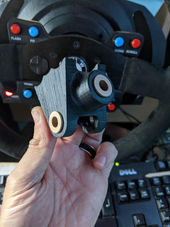

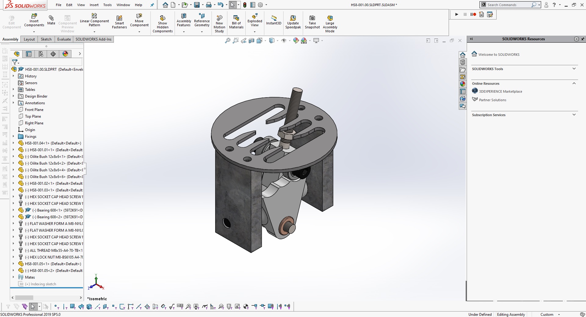

Following on from me setting up my sim racing wheel and pedals with the cobbled together clutch and handbrake I've been spending quite a lot of time driving a mk2 escort in dirt rally 2.0 and can't help but feel that I'm not getting the true visceral experience of it with a flappy paddle gear change.  The thrustmaster th8a H-pattern shifter is about 150quid but it's a no go because it's really noisy and risks waking children.  So I've fired up solidworks and I'm making myself a 7 speed + reverse H-pattern shifter :D
A friend is 3D printing the triangular shaped pivot in the middle, the rest I'll make from aluminium and steel.

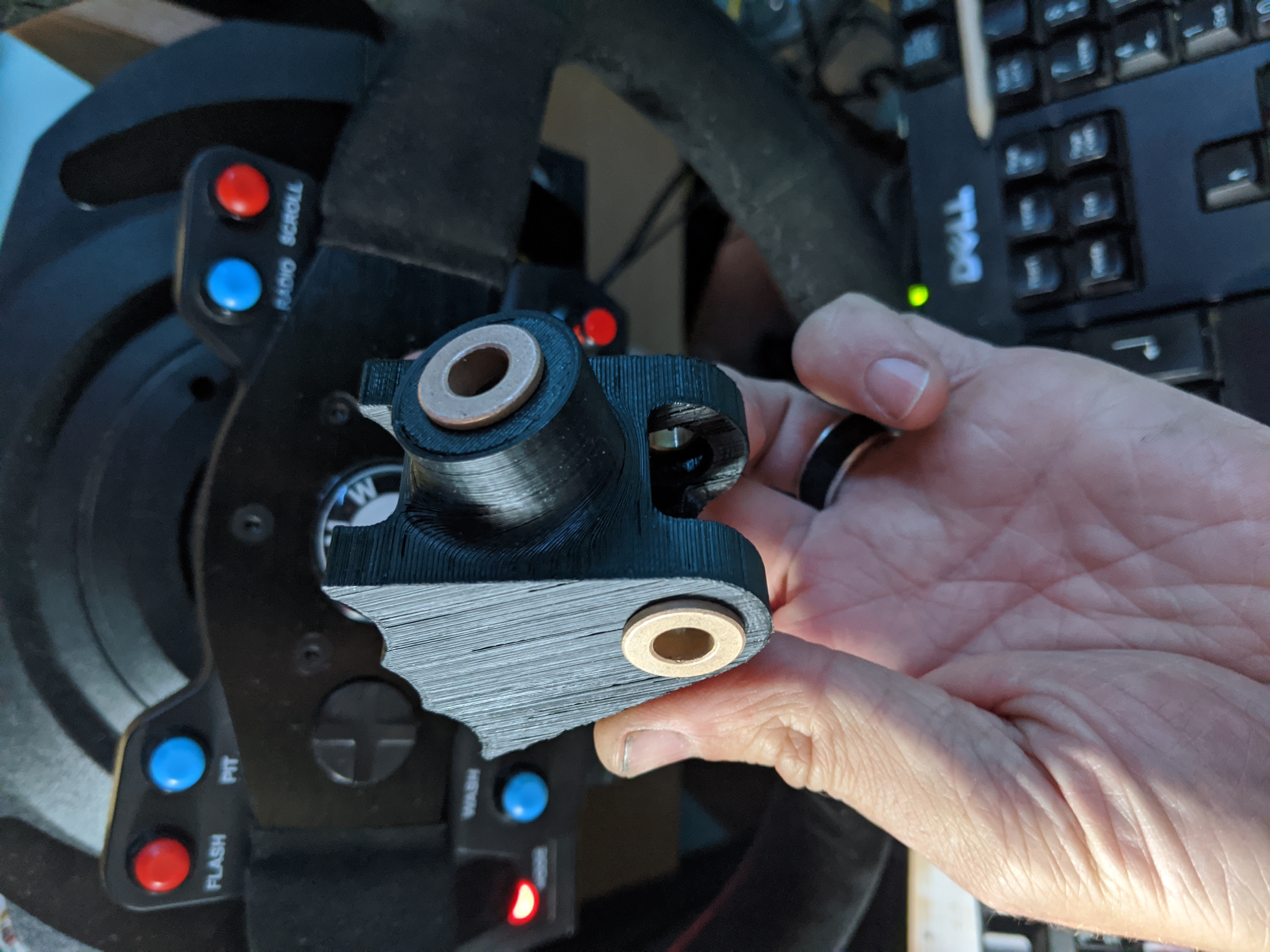

Fore and aft selector pivot printed, bearings fitted. Got all the microswitches and usb encoder board. I've changed the design to include a slot on module that converts it to a sequential shifter.
The pivot bearing centering mechanism isn't going to be stiff enough for the sequential so designing in some adjustable leaf springs so I should be able to fine tune it.
