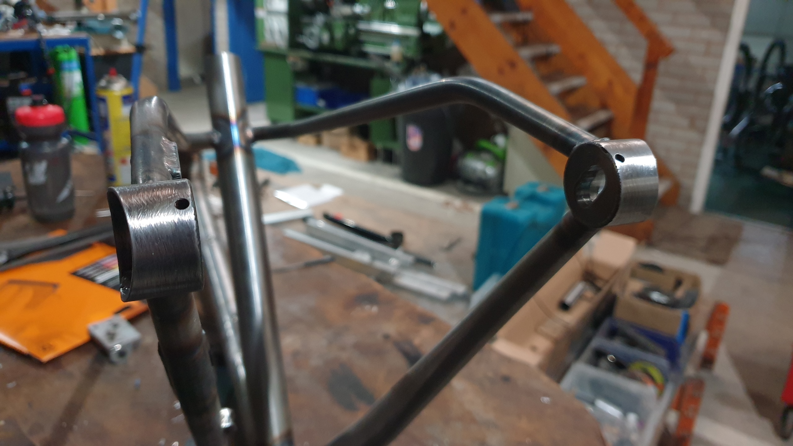

I ended up taking a flap disc to my dropouts and they came out nicely. Just a little shaping to break up the industrial look...

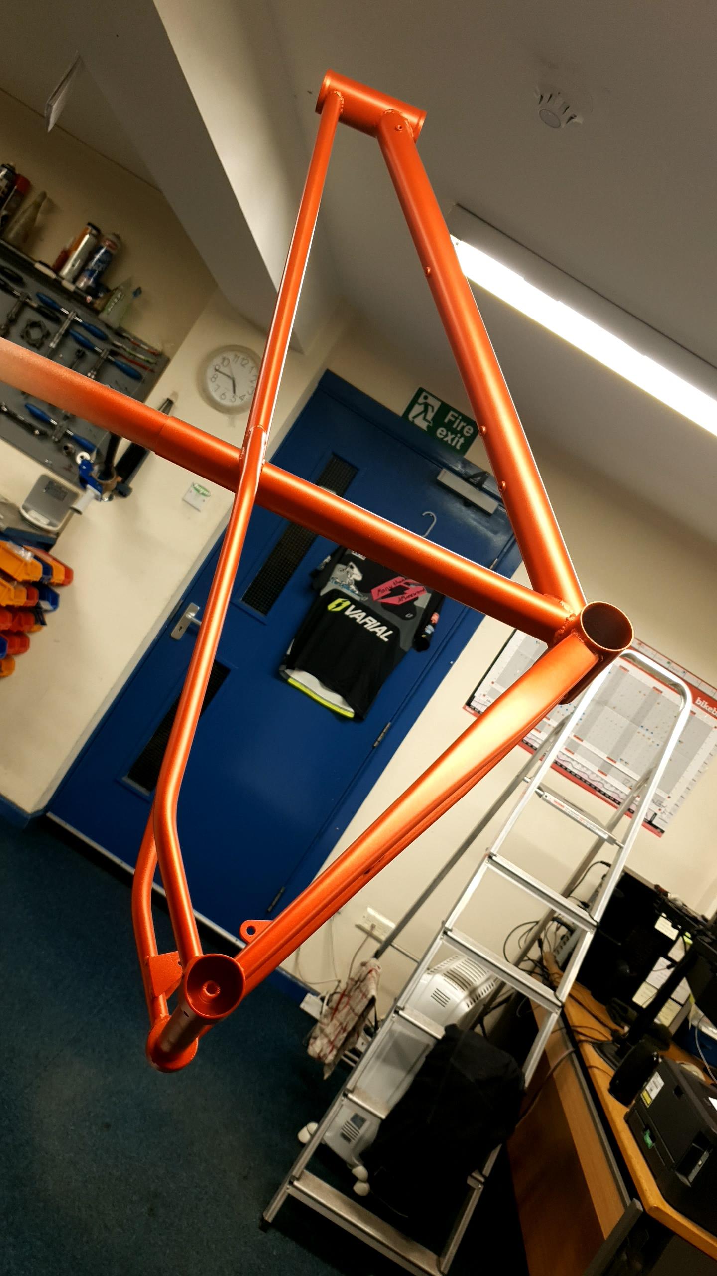

Then I lobbed some paint on. Its impossible to get a good representation of the colour indoors using a phone, but its an orange clear coat over a coarse metal flake base. Need to order another can to finish off the orange, but I'm looking forward to seeing what its like in sunlight once the lacquer has been applied.
In theory should be like this...

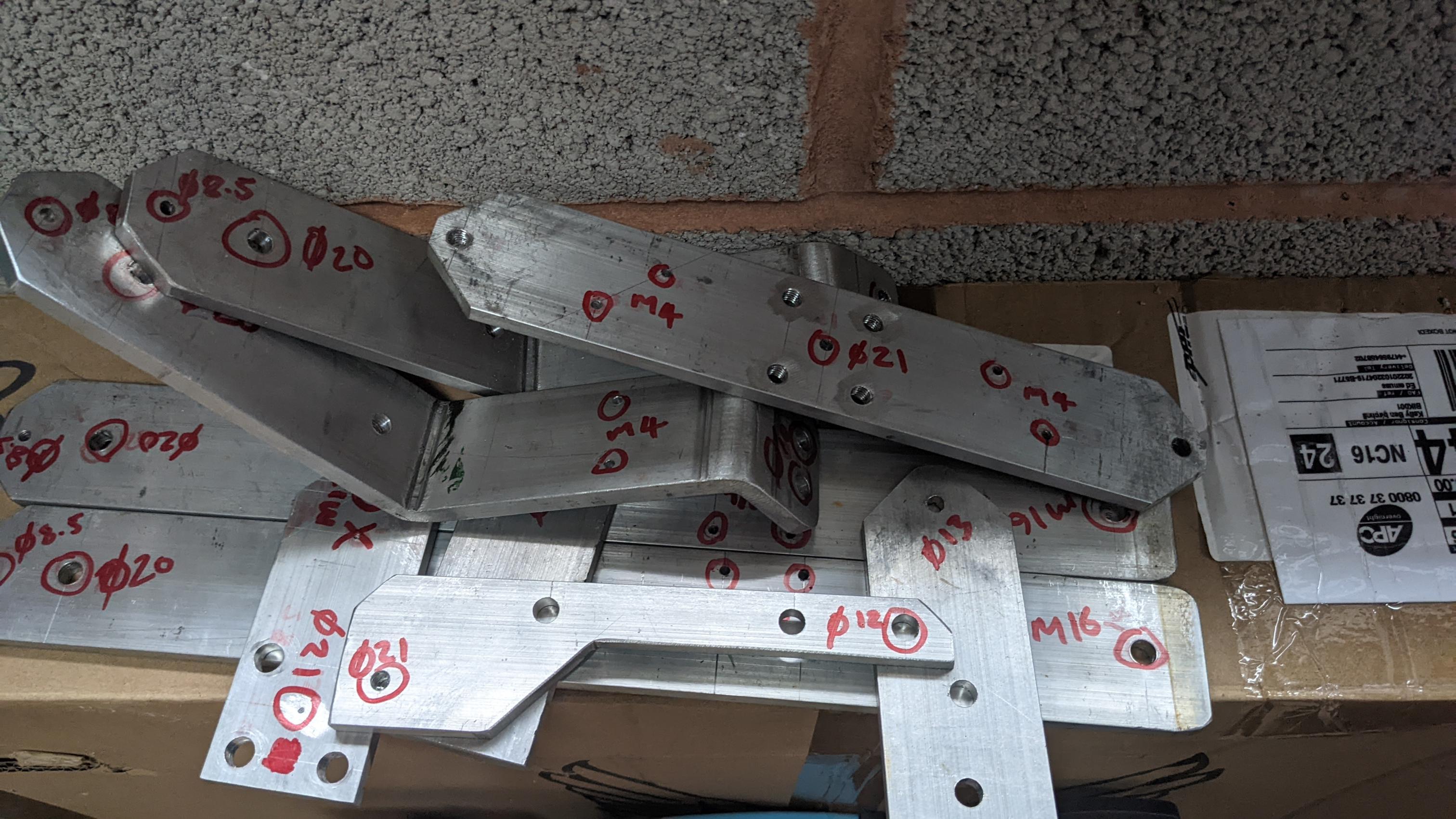

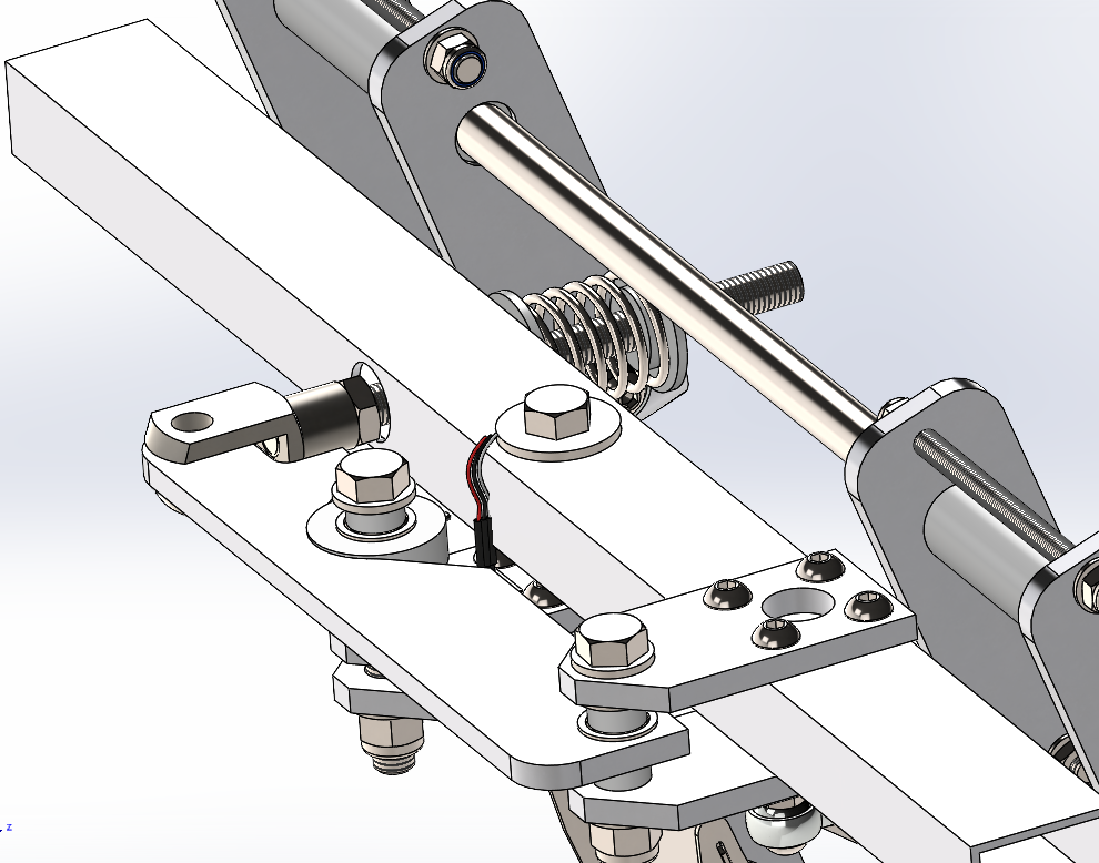

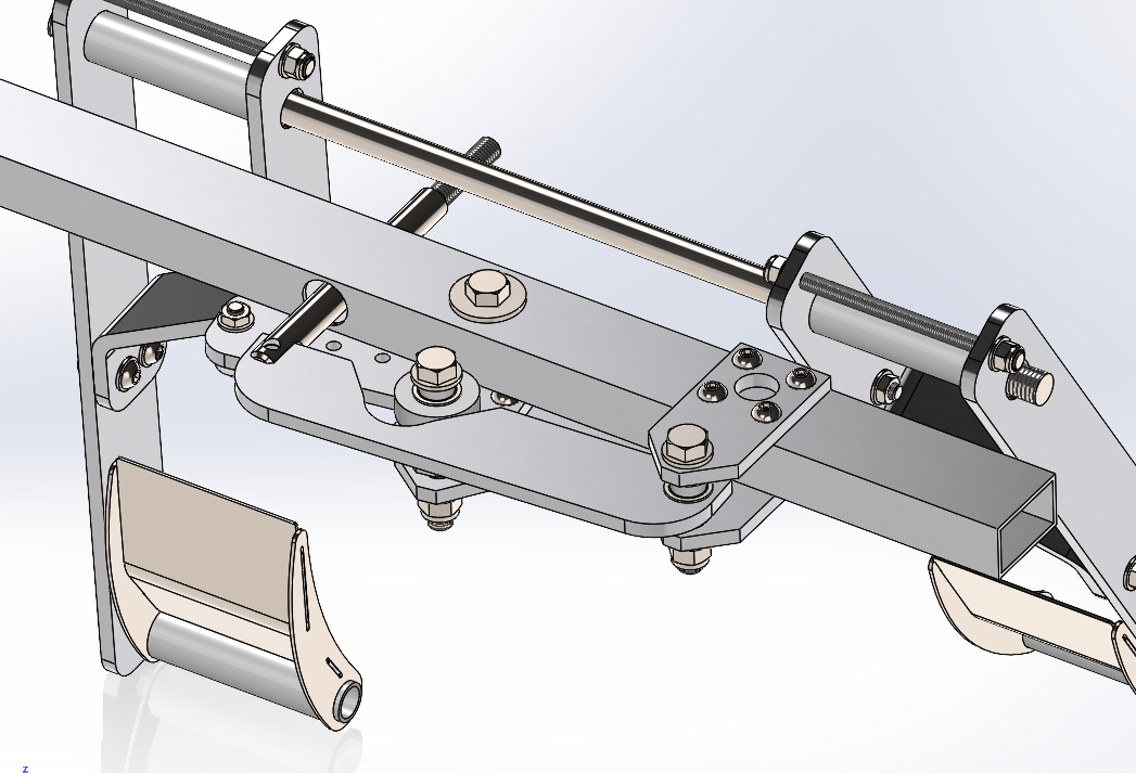

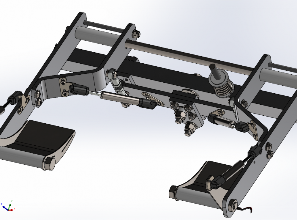

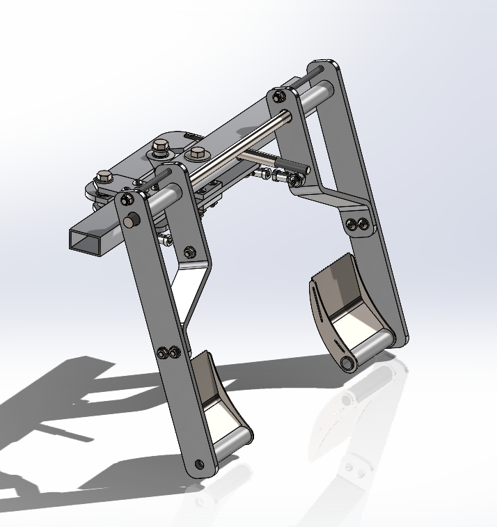

Because my flight sim rudder pedals are now close to 20 years old and getting rather clunky and stiff I figured I would make a new set to fit within the physical constraints of my nerd cupboard.
Ideally I would have a set of thrustmaster TPR rudders but the 400 quid outlay isn't possible and the central support design prevents access to my sim racing pedals. I've approached the design based upon the mechanism of the TPR but with outboard supports rather than inboard. I've decided to use a cam driven centering spring which has adjustable preload and can be backed off entirely in order to make the pedals better suited for helicopter usage (antitorque pedals in helicopters don't self centre like plane rudder pedals do).

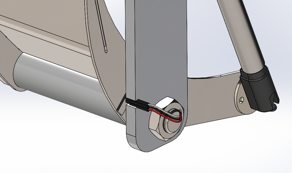

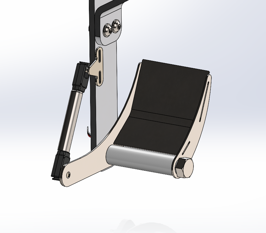

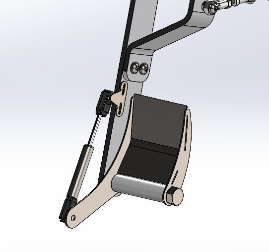

In addition to the main rudder axis (one pedal forwards one pedal backwards) there are left and right toebrakes that are applied by rolling your foot forwards.
All three axes will be positionally read by hall sensors (magnetic sensitive sensors essentially) and rare earth magnets.
The toe brakes will have miniature has struts on them for spring return and damping. I'll be using another couple of struts set at mid stroke to damp the motion of the main pedal arms.

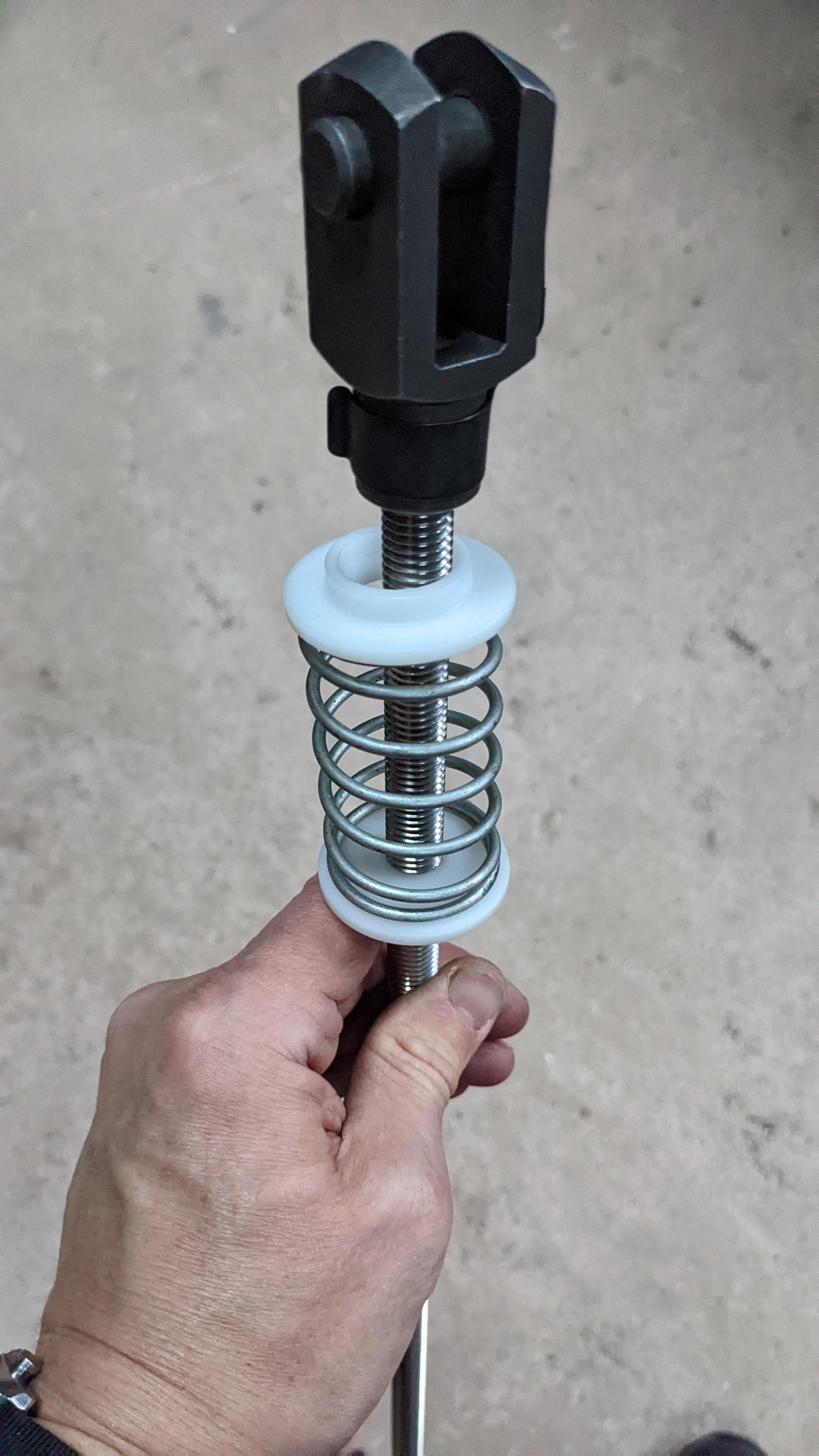

edit: added a second pair of gas struts to act as a damper for the main pedals. For plane use, engage the centering spring by winding up the preload collar on the pull rod, for helicopter use release the preload entirely and the dampers should hold it in a set position as per real life.
Also found a clevis under my work desk that has been there for the last 10 years or so, makes the pull rod much simpler to construct.

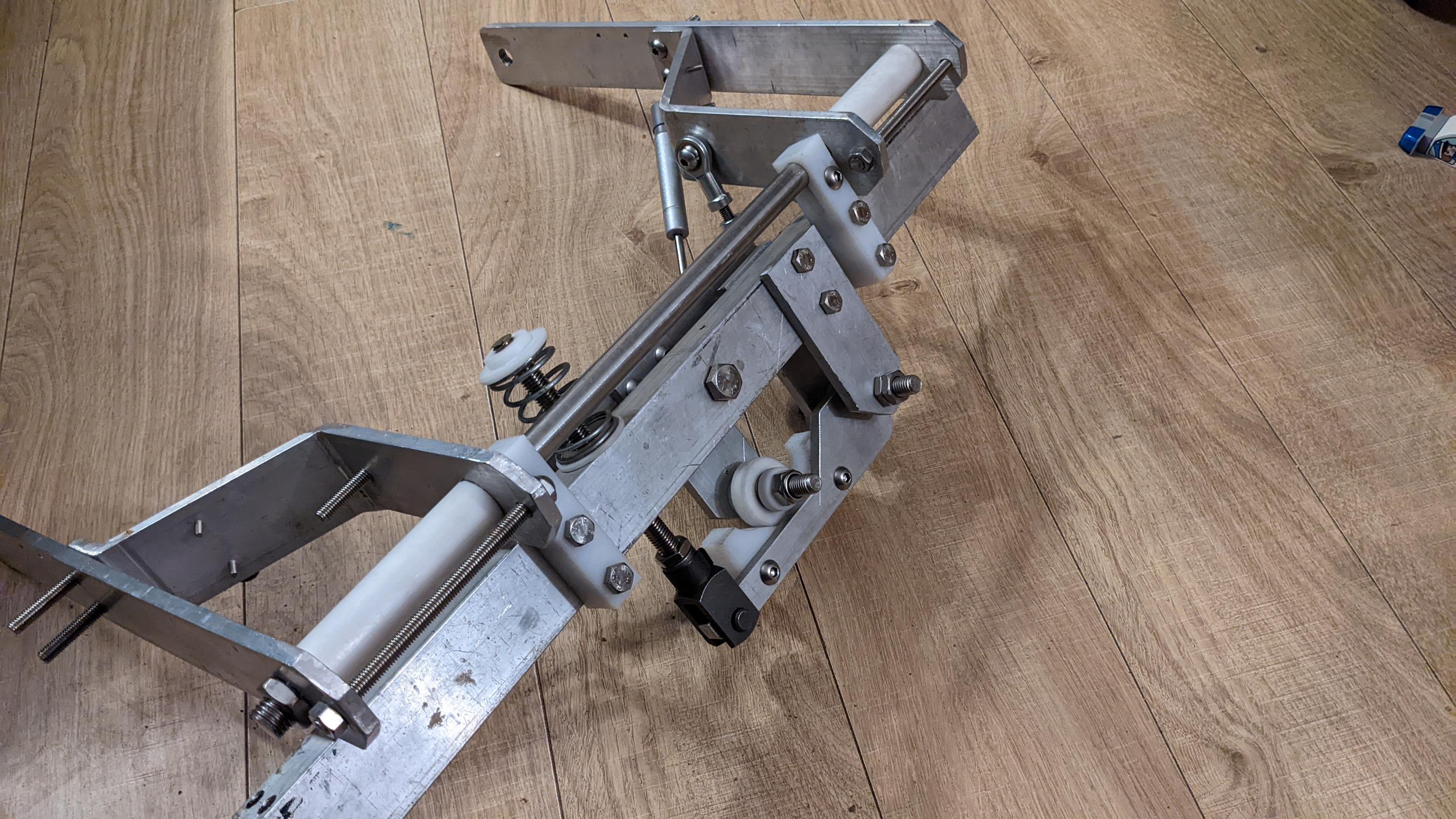

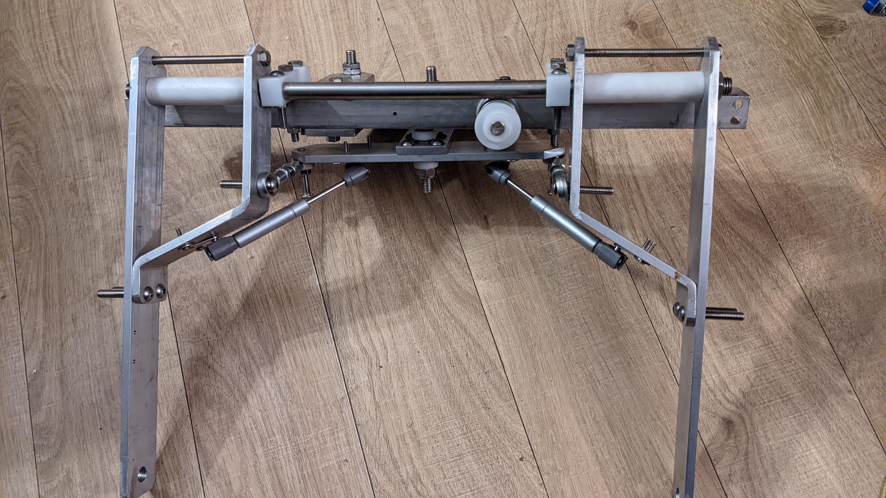

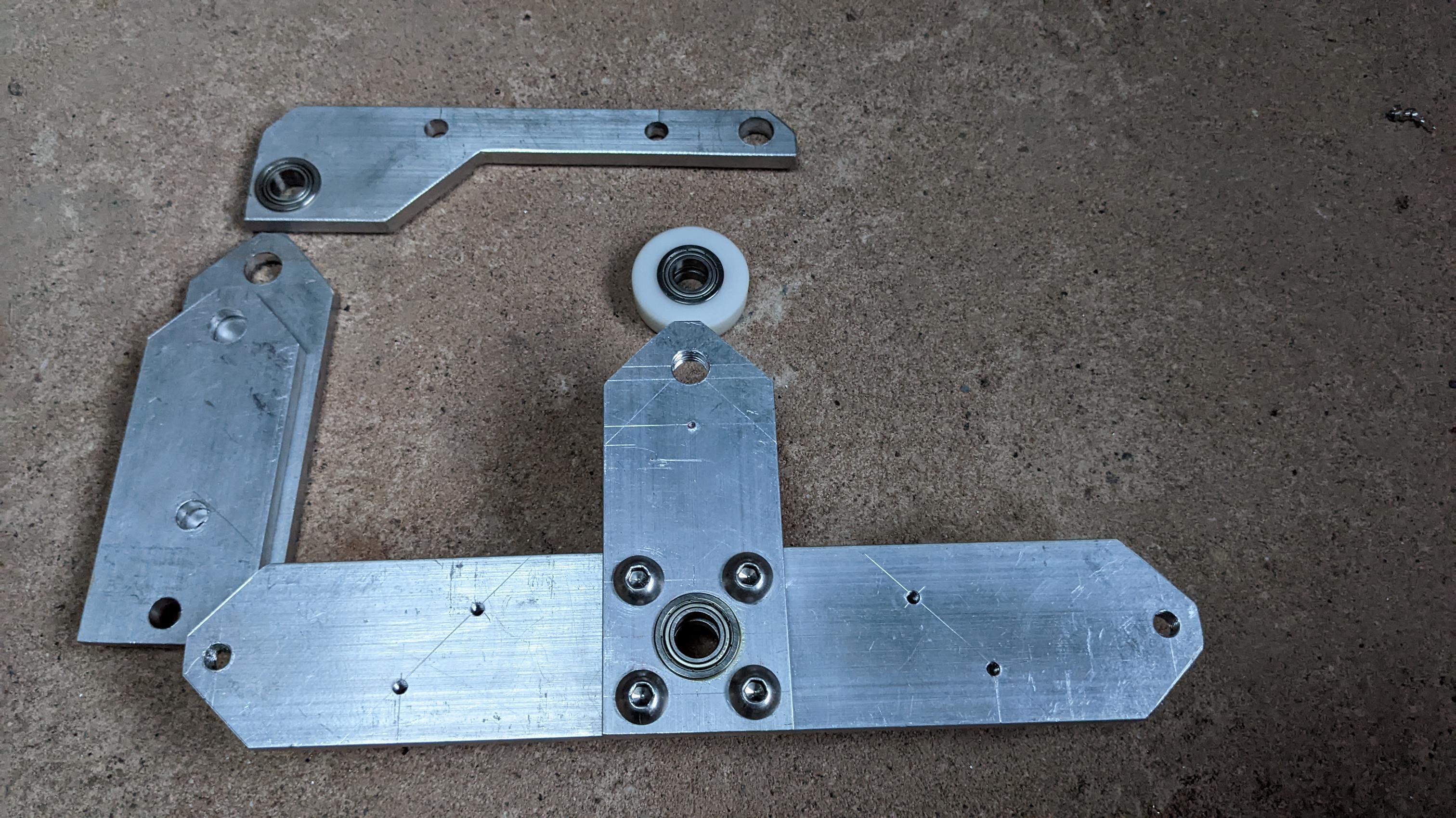

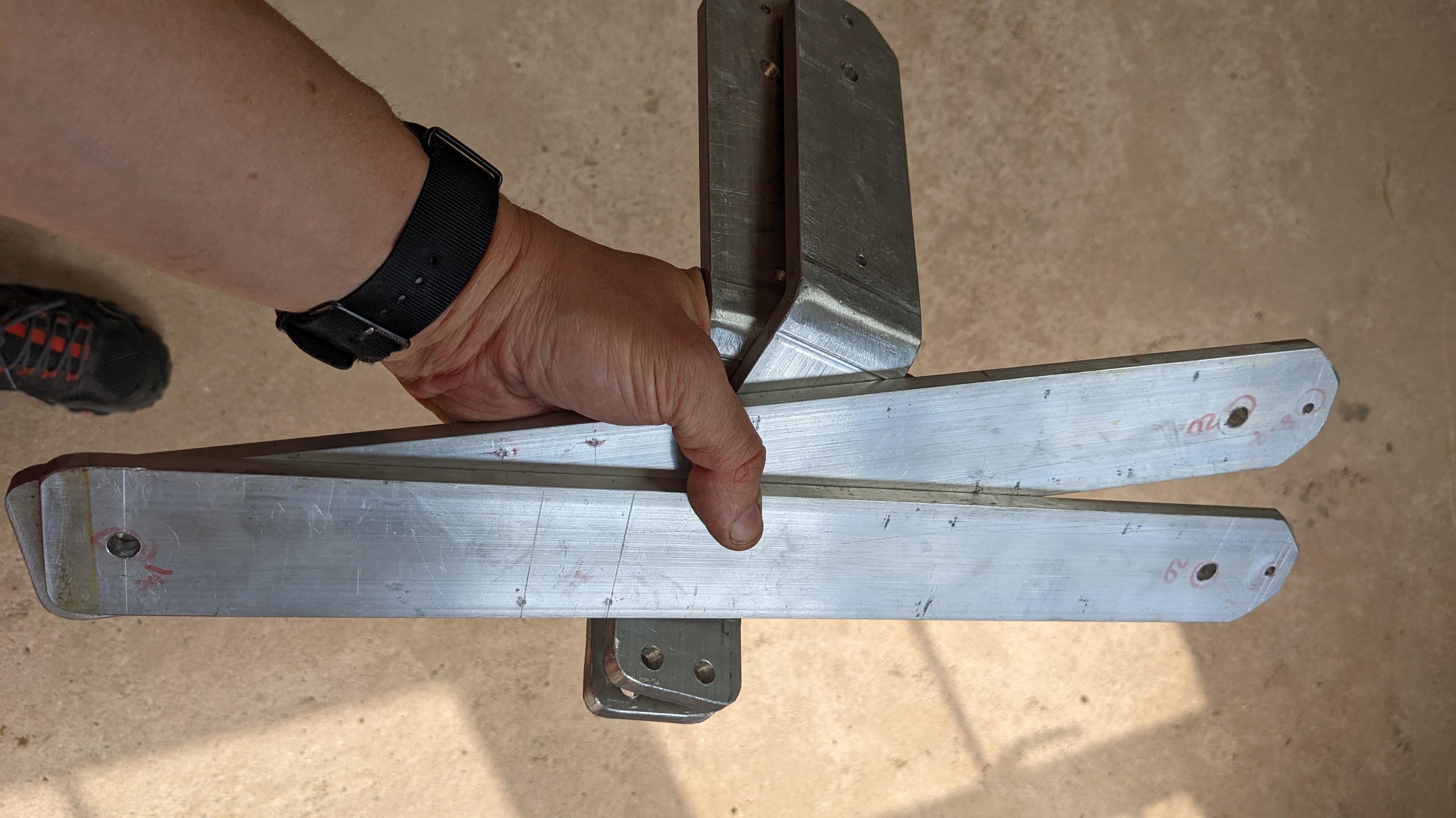

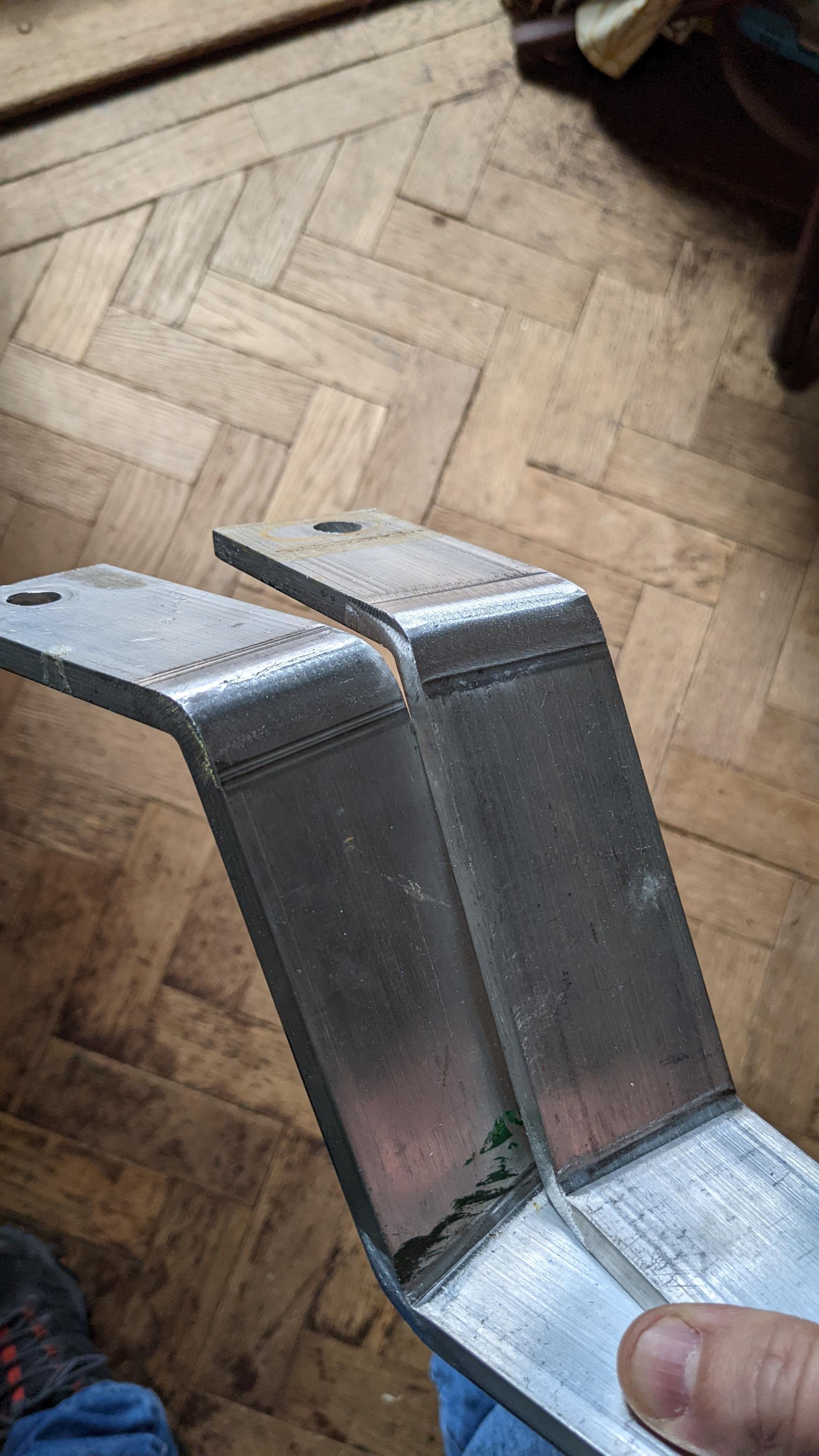

Did some making :D

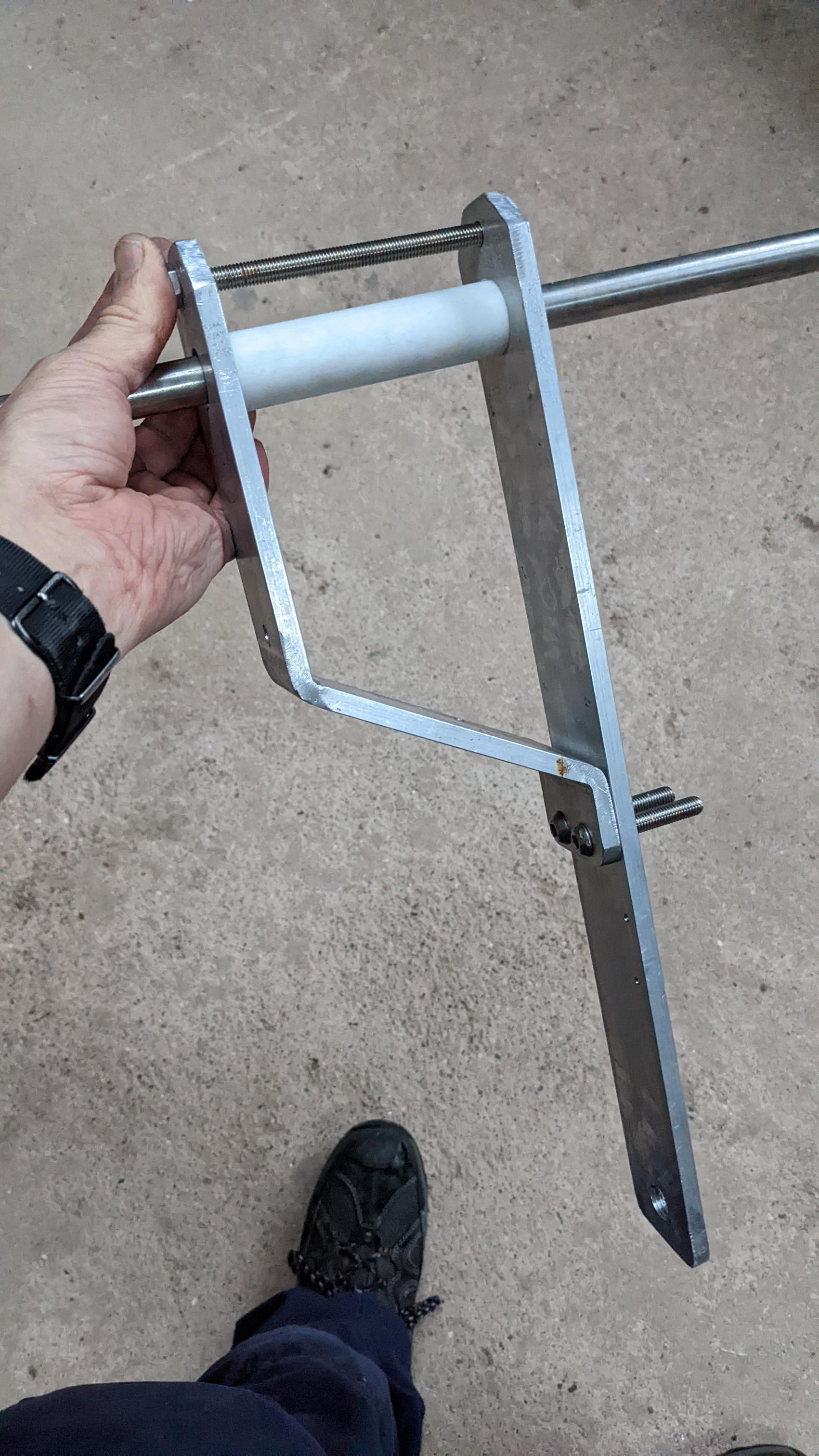

A couple of bits to tweak but for a first dry run it's not gone together too badly.  Got to wait for the laser cut toebrake parts so I can tweak the mechanism till then.
Spring preload works really nicely with the dampers, with it wound to almost zero preload they stick in one position, wind the preload on an inch and they smoothly return to centre without a noise :)

That's a bit crap, I'll reattach then when I'm back on the computer, currently toddler cuddling on the sofa :)
edit: reattached photos above, I've made the minor tweaks to the cam link plate that lets me recentre the cam much better and repositioned the lower end of the damper struts so that they don't limit the stroke now.  Hopefully at the weekend I'll be able to get the main cross beam sensor and magnet fitted, get them bolted onto my desk and go fly with them.  I'll add the toe brakes when I've got the bits.

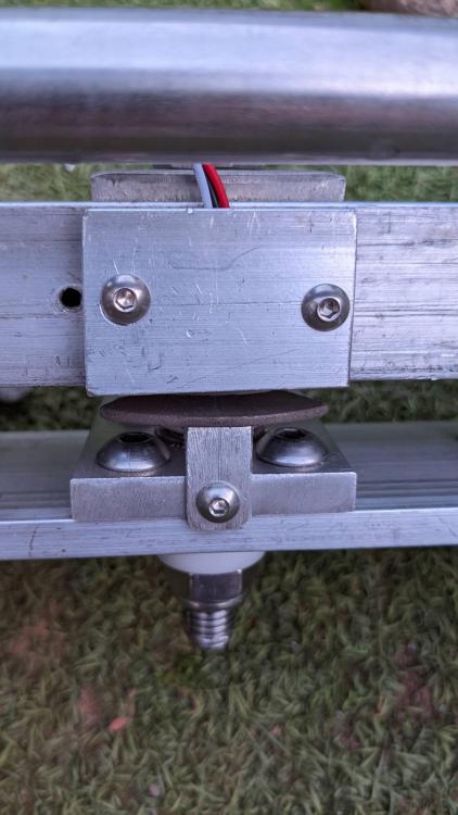

Sensor clamp and magnet bracket made up, magnet is one salvaged from an old HDD.  Turns out that the original intended magnets weren't really big or strong enough and weren't giving great results over the full range of motion; new one is much stronger and large enough for the sensor to not pass over it's boundary.  Made a small angle bracket to glue the magnet to and clamped the sensor behind an offcut of aluminium flat, cut a slot into the back of the clamp plate to keep the sensor and wires all contained and aligned.
