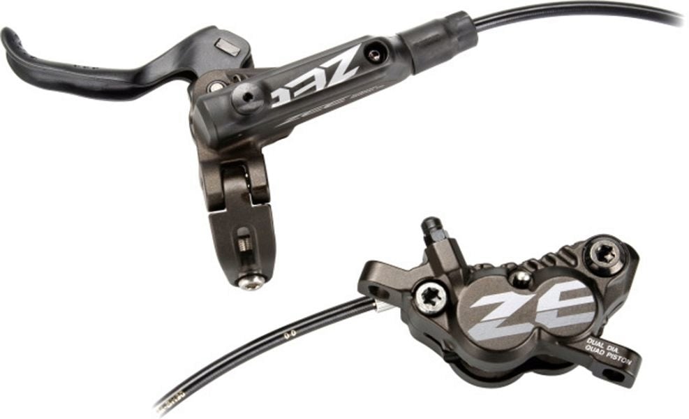

Shimano man myself. ZEE on the front with EBC red pads. Saint M810 on the back (fingers crossed it lasts a while longer!) with the same pads (or are they TrialTech, cant remember)
The one thing I like about the Shimanos is the pad clearance. They run a "servo wave" arrangement where the lever pull ratio "ramps up" as you pull, supposedly delivering more power the more you pull it. #1 Essentially this means the pads are able to sit further away from the disc...Unlike the Maguras, where, I've been told, that any slight bend in the rotor creates pad rub. #2 Essentially this means, if you side hop to the left, yer f**ked. Especially if you're @Rory Semple
Edited by Ross McArthur
  • Like 2
