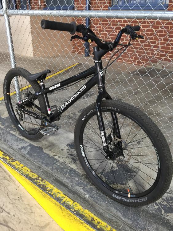

Had a hankering for a short wheelbase 26”.
Yet to fit brakes.
Edit. The frame was ridden as a jump bike by a 5 stone 12 year old, so hardly has a mark on it. The white mark on the top tube is a lightning sticker. I don't even think its ever had brake bosses fitted.

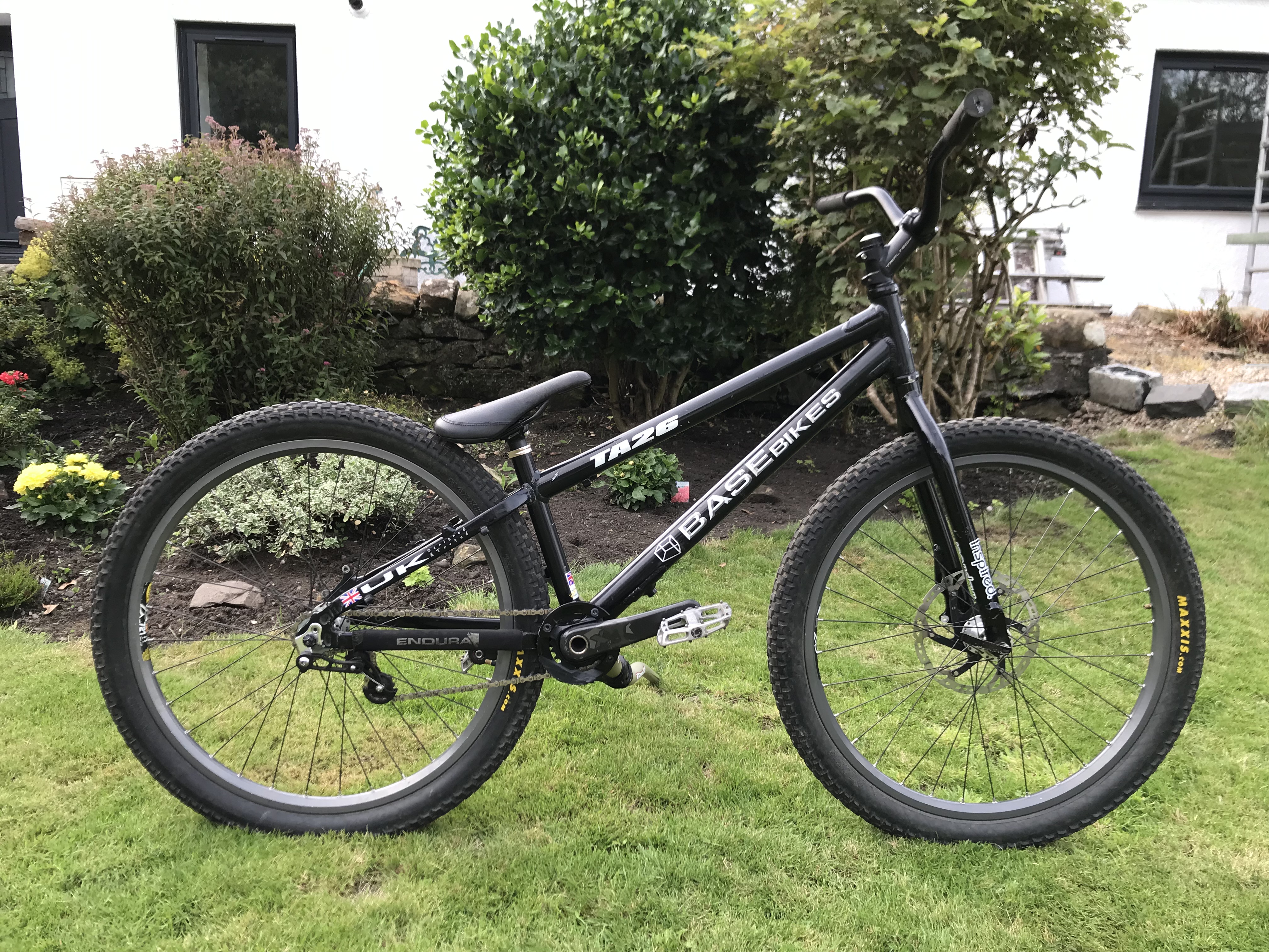

I was just astoundingly lucky. There are two I know of. frame only here https://www.arthurcaygillcycles.co.uk/product/base-frame#.XUgbrT9YZMt And there is a full build black one too. I contacted the boy about getting the black frame only but he wanted a stack of cash on top of the £150 to debuild and rebuild onto the red, which is fair enough, guys trying to make a living but I just wasn't prepared to pay that much. I found mine on eBay for 50quid buy it now. So I bought it now.
I also took my time to find the right saddle and post combo. The set angle saddles were just too laid back for how steep the SA is on this bike. They hit the tyre, nose poked too far up and showed too much post. So went for a railed saddle with an inline post and played around the positioning. I think I've got it just about right, following the angle of the top tube (maybe half a degree slacker)? Yay? Nae?

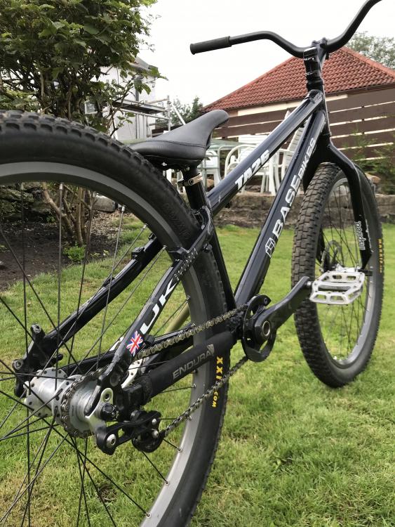

Ideally I'd run the mounting arm parallel with the chain stay and have the tensioner arm around 110-120degreees, like any trials rider would...but the first jockey wheel sits too close to the 18tooth cog.
I find with a slightly slacker than normal chain, there's less tension on the system and the cranks spin more freely because of this - making it easier for crank flips.
May still go full retar...trials rider and run 22:16.

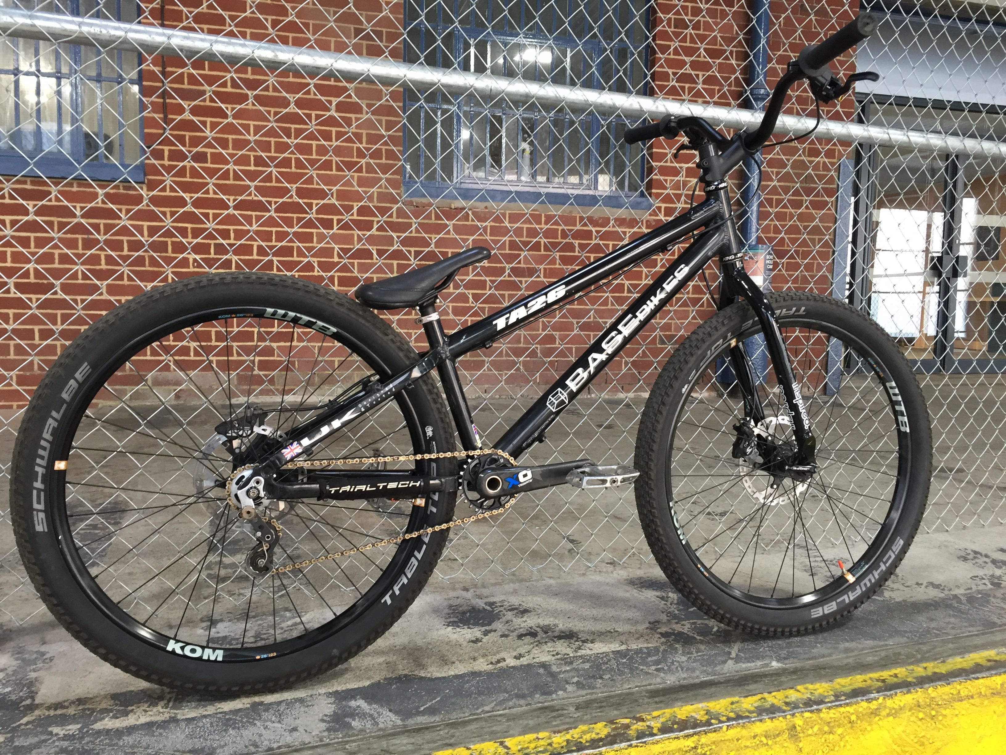

Its a weird mix of feeling soft and hard at the same time..
I can feel the flex of the wheels, cheese rims and cheap spokes and with the 180 disc on a 26" rim on a underbuilt brake mount. I also have to run the light tyres really hard.
The geo works for me but just doesn't have that solid feel of a modern street 24"..
I'm not sure how long it'll last so might have to retire it soon before it snaps! I try to limit the amount of times I lock on the brake when landing fakie..
