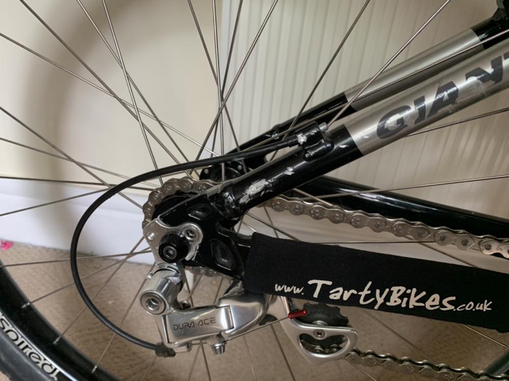

Take a bit of derailleur cable and knot one end. Put the knotted end where the cable housing would enter and run the cable to the usual fixing bolt. Now you can use the barrel adjuster to pick the gear you want. No disassembly required. Works on any derailleur with a barrel adjuster.
  • Like 1
I was at a British Comp round once and noticed Akrigg had done it on one of his Onza bikes, I asked him how he locked his out and he had done the same and just took the spring out and just set his gears up like normal. Simple and affective, plus it followed on with a lot of riders.
Until the inevitable moment when you bash it off on a side hop fail :lol:
I seem to remember having a full cassette and range on mine when I locked mine out. But the reality is you only need 2 or 3 gears.
It used to be the law. Stock bikes had to have working gears, now they have to resemble timmys pogo stick and not be rideable on a trail.
Short cage road 105 was my preferred, I would have a V brake cable, with large end to catch in the lever- but i would put that end right up to where the derailler adjustment was, and pull the cable through like normal and tighten it... couldnt shift, also zip tied the derailler body to the frame... no bouncy bouncy slap noise.  If you wanted to shift, a cut in half grip shift was the jam... or mount an indexed og mtb shift lever on your seatpost...
