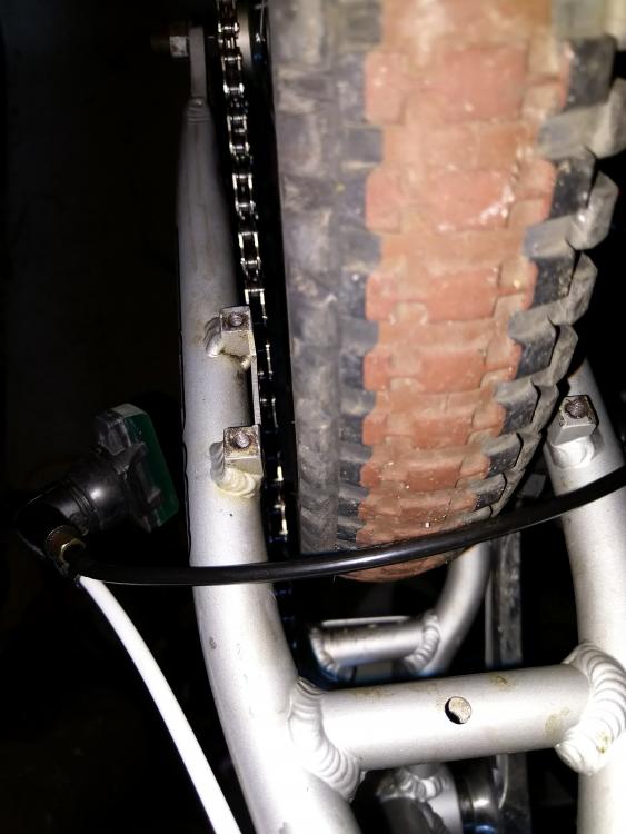

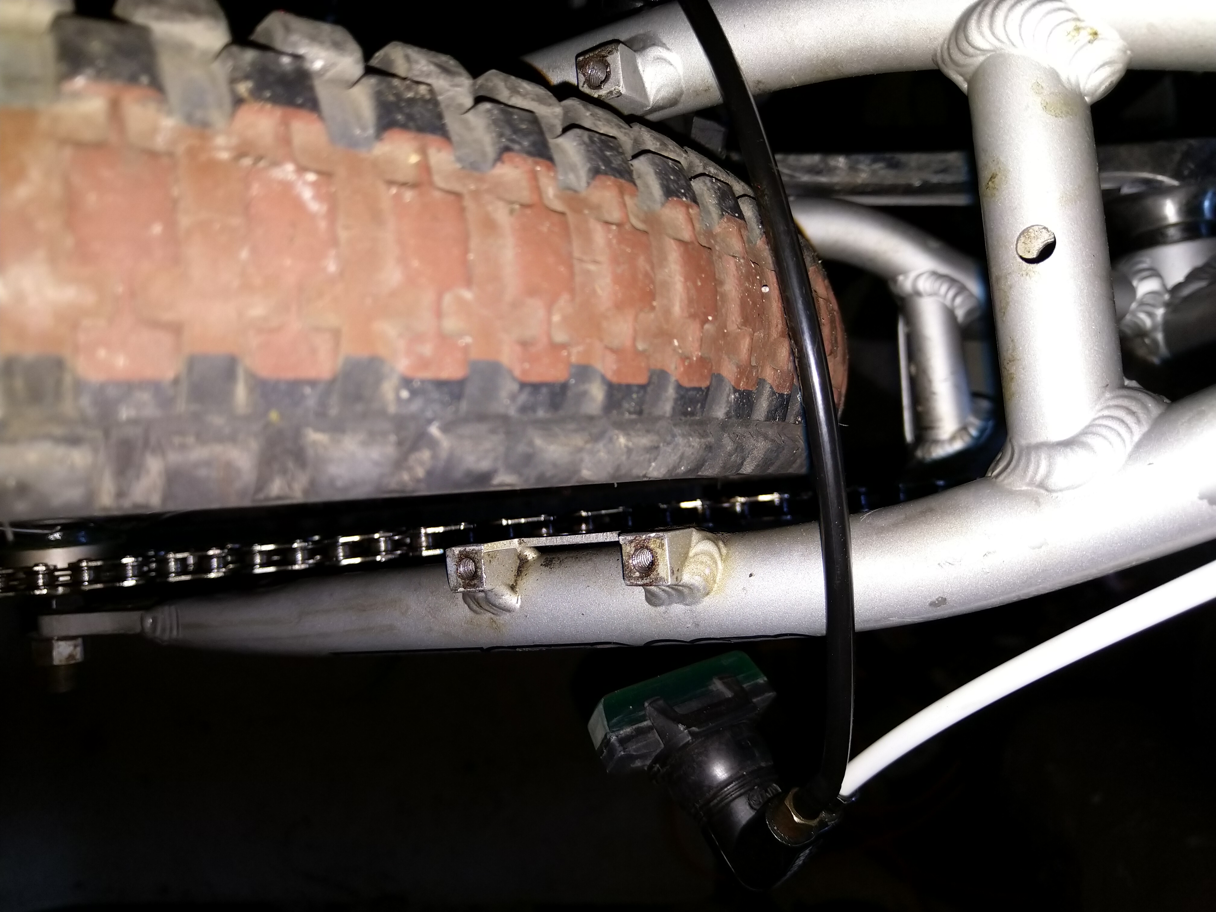

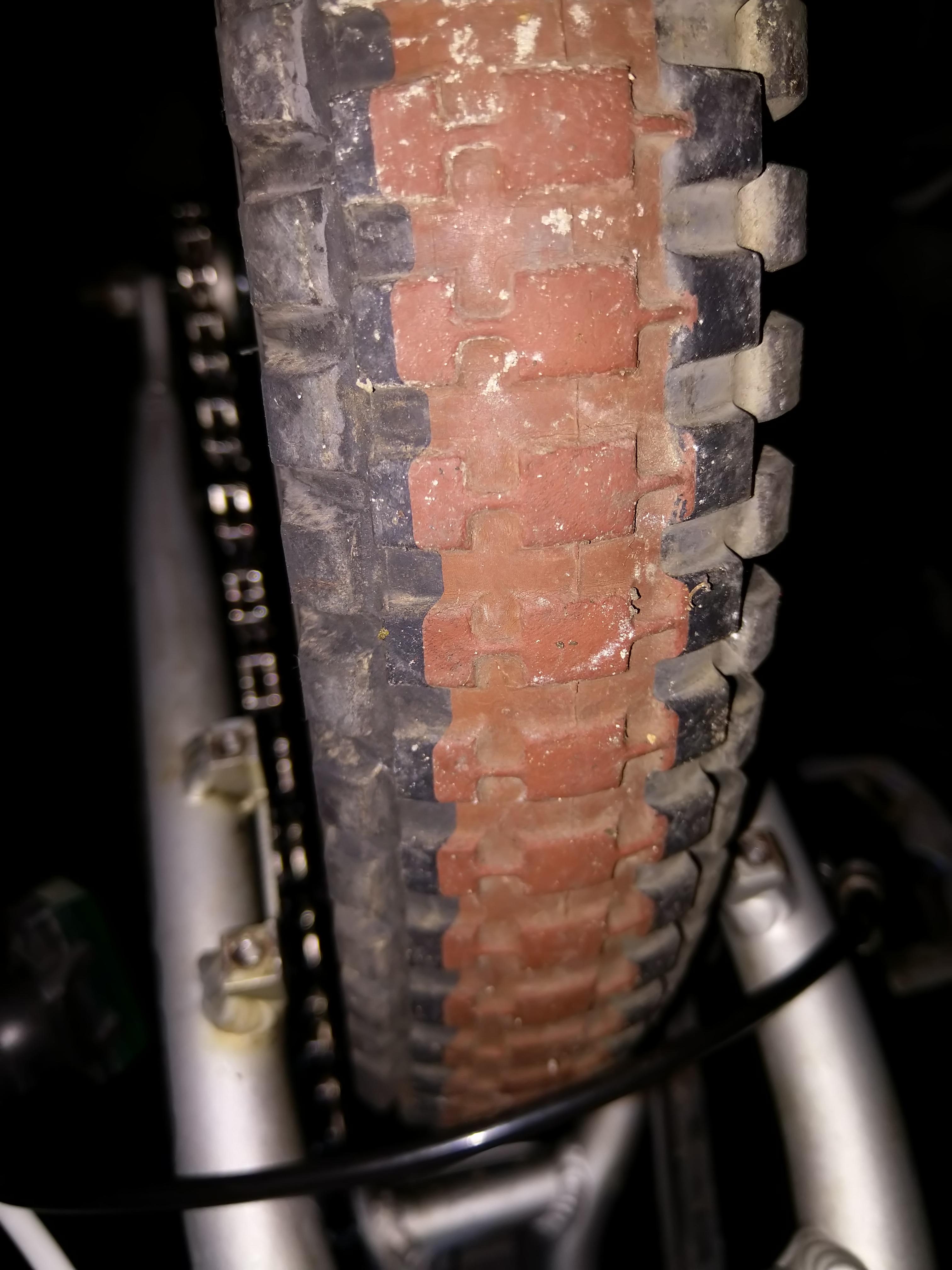

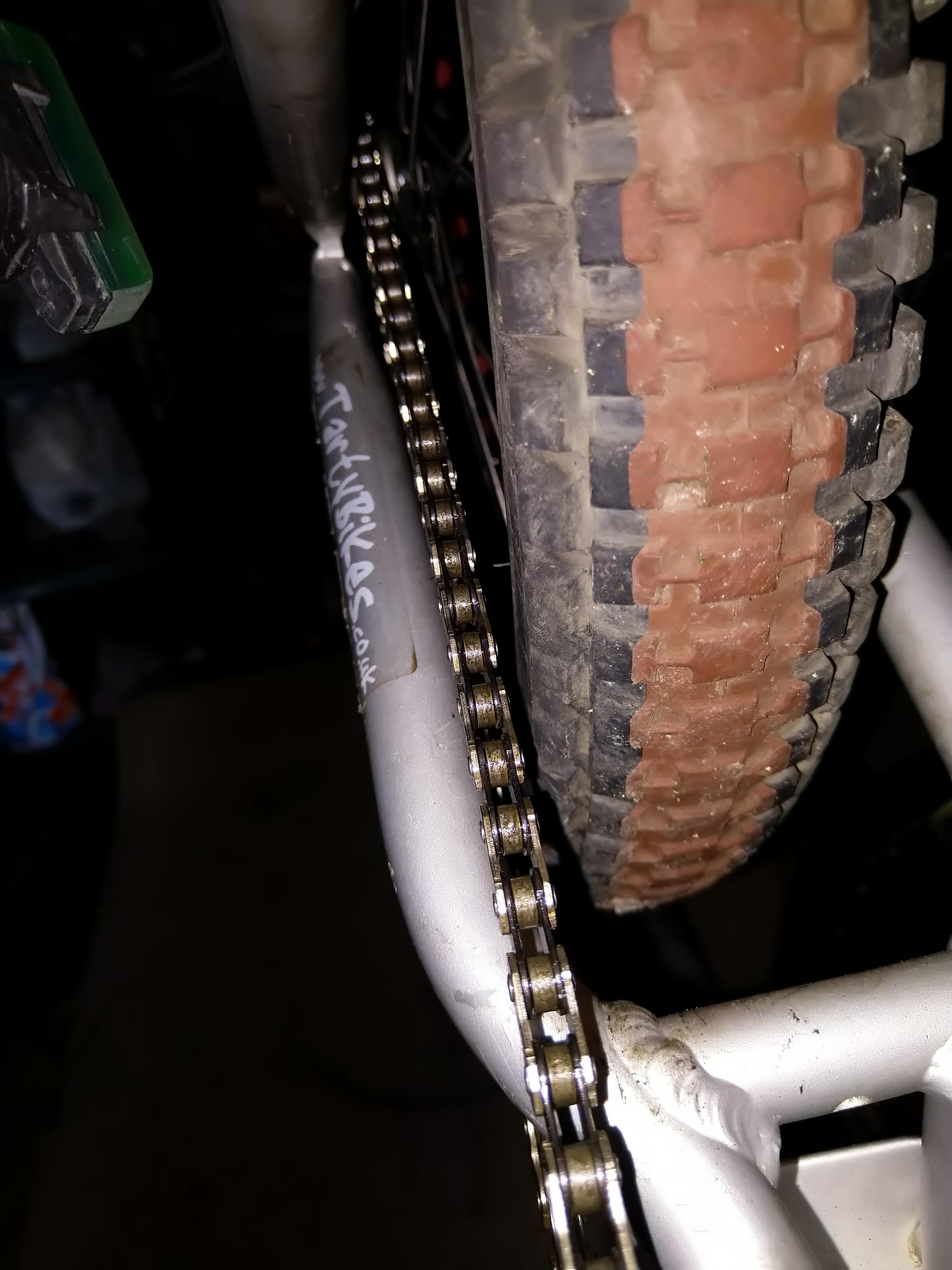

On 8/4/2020 at 9:26 AM, Karlos28 said:
Apologies for the delay... Some not great photos of the onza tyre fitted, only about 5-7mm of clearance between tyre and chain. The creepy-crawlers are a tad wider so it catches....?
1) What's the dish like pal? Excessively towards the drive side? It will be asymmetric, yes, but only a tad. It shouldn't look like a >9speed with the driveside spokes near vertical. The dead give away would be when you set the slaves up the arbitrary 1-2.5mm from the rim (with a straight and correctly set wheel) and the non drive side drive is pushed in with the driveside one having to be set pushed out off into the next postcode.
2) What length bottom bracket have you in there? From that angle I'd tek a stab that you need longer one or an offset one because you've changed the chainline measurement by adding the front free wheel set up from that donor bike (green 06 Tpro, right?).
See Ref. https://www.sheldonbrown.com/chainline.html.
The rear chainline has been changed because the rear freewheel would have sat the chain more towards the hub's centreline, also.
3) When I had my one of those T-birds (bought new, factory spec, MY05/6 T-bird in silver, onza reggie wheel, creepy crawler, 24/18 gearing, KMC K710 Kool chain) the tyre was bloody close to the chain, close enough that I recall cutting across the school playing field trying to make curfew one time & enveloping the chain is boggy grot.
4) Do an idiot check. Start afresh, run through all all the stupid shit that should be "right" such as tweaked dropouts, bent wheel axle, wonky BB axle, wonky freewheel with four miles of runout, wheel moving in the dropout as you give it the bigun on the spanner etc. and everything else that gets f**ked on 2nd/3rd/14th hand bikes. You haven't a scooby what Cletus may have been in there before you on either bike/combination and now you are trying to modify and merge the two. Nothing is a given.
5) What locknuts are those? 3, 5 or 7mm? You're getting desperate by this point if you need to do this but if those are 5mm locknuts you can do some fudgeing swapping the NDS locknut for a 3mm and the DS for a 7mm, with or without the application of penny washer(s), longer BB and taking some dish out of the wheel.
I do/have done faaarrr too much f**kin around with dirty old bicycles of all shapes and sizes that have had at least two goes round the sun and often many a 'tard piloting and spannering them >-]
Keep updating.
Ciaran.

Haha awesome reply Ciaran! Some really good points there.
1)
I honestly haven't looked at the dish that much as I am awaiting some new 4 bolt mounts (the lower half of one side is a V brake mount... How does that happen!?) Will definitely check it out though, I know the front. Has a fair few mm of dish, which I found quite odd...
2)
Errr, that's a tough one, 135 rings a bell? Being totally honest this was a bit of a guess as the original frame I got (long story) had no BB so took an educated guess...
I do have another square taper onza BB and cranks that had the original front freewheel (it actually has a double freewheel set up, quite impressively pointless!) From the T-Pro that I may try fitting, to see how it looks/rule out the BB length. They are 165cranks though... Not sure if that's good/bad/better/worse than the 175 tensiles I have now..
It wouldn't work with the rear chainring set up I originally had either, same BB... So you might be into something there...
The chain line looks really good though, not sure moving it outboard much would be a good idea... I guess that's why I never suspected BB length.
I have started a fresh a few times now as I have moved it through a couple of different set ups.. this is why I wondered if it's normal.. if you have had one on there, it must be something I am doing!
Wheel axle lock nuts? Not sure.. axle is only 10mm. I'd rather use this wider hog wheel, as it used Allen bolts to secure the wheel, I have ordered a couple.of chain tugs too so that I can make sure the axle is square.
