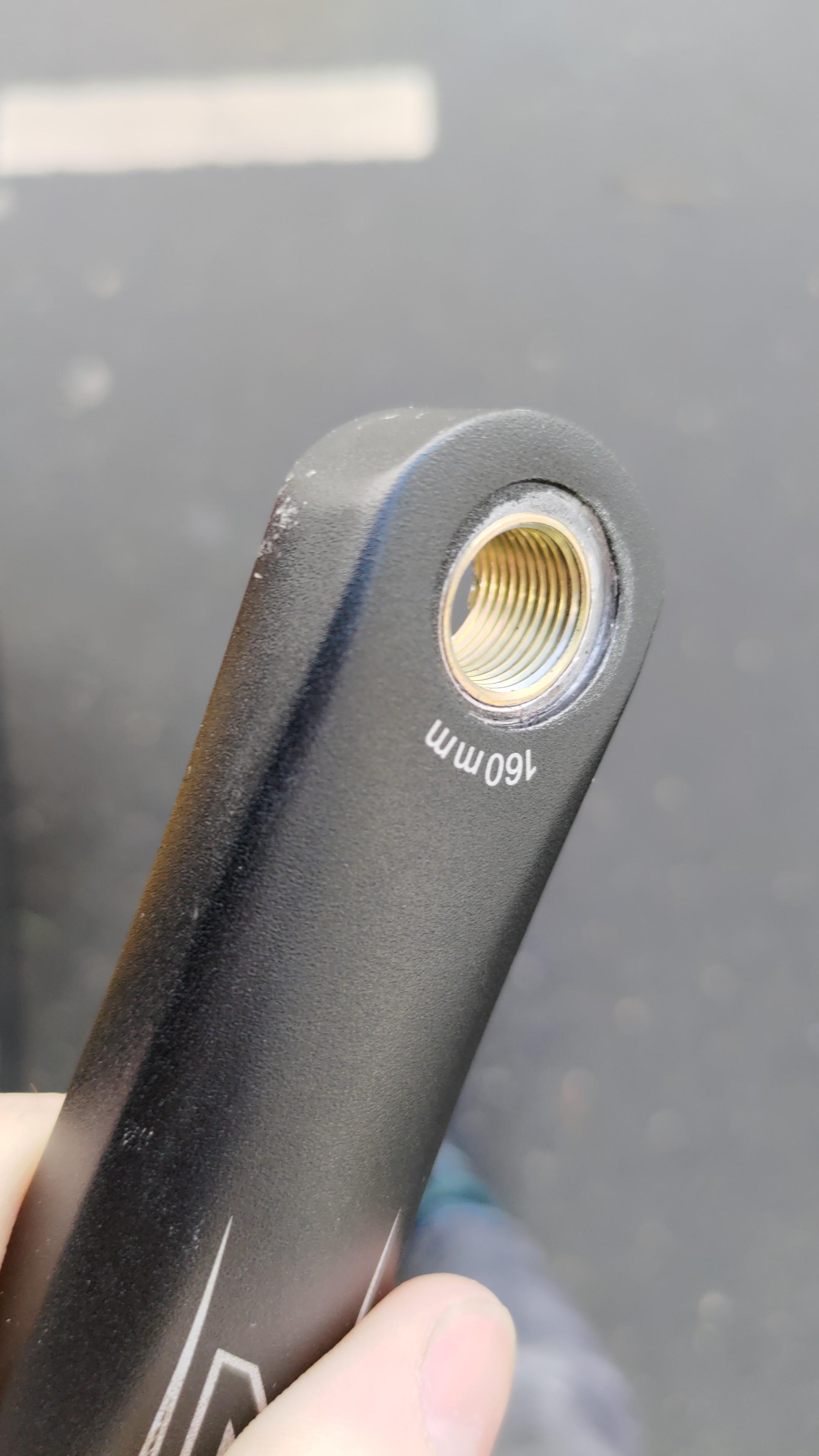

2 hours ago, Canardweb said:
Ok, so got mine repaired in Decathlon, which is a huge multisport store. Cost me 19 euros and seems they used the pedal inserts Alex Dark talked about. Really pleased with this.
That doesn't look like the insert has been set in far enough, it looks almost flush with the face, the crank face should be a little bit proud of where the insert is or the pedal can tighten up against the insert and that can cause you issues. If you run a steel pedal washer it should reduce the chance of any problems.
  • Like 3
Thanks for this. I will try to find a washer then!
