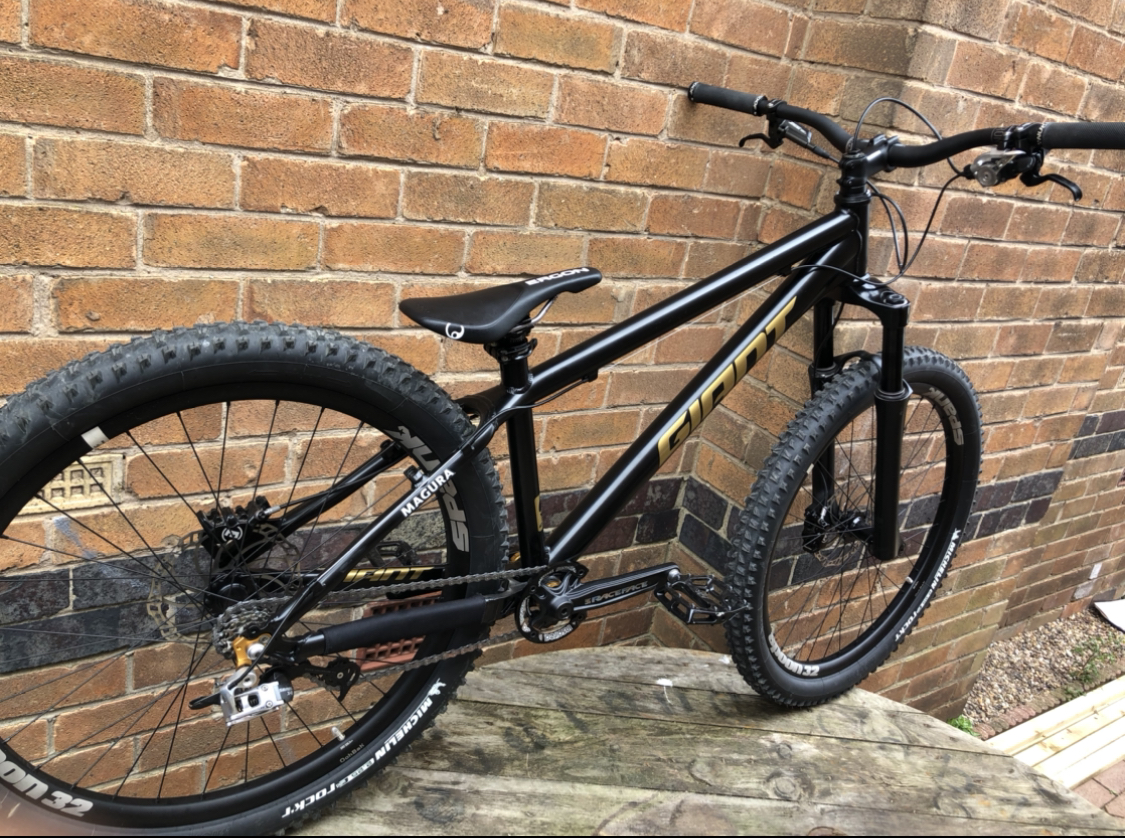

2 days later and a bit of eBaying I ended up with this as a base:
I know... she isn’t pretty, but all I really wanted was the frame and fork. I figured I could sell some of the bits off. The 24inch rims were a write off (which I knew about). But it had Hope big un hubs which I managed to get some money back for on eBay.

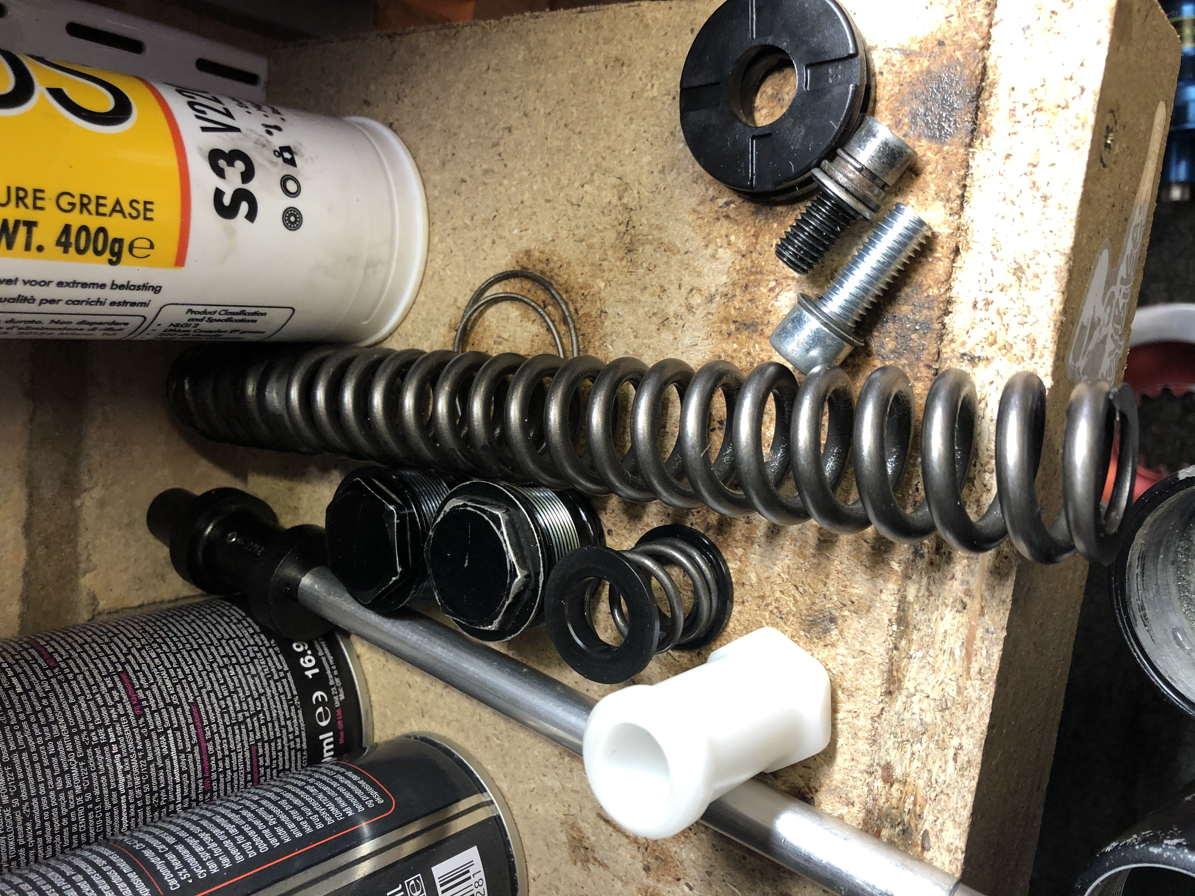

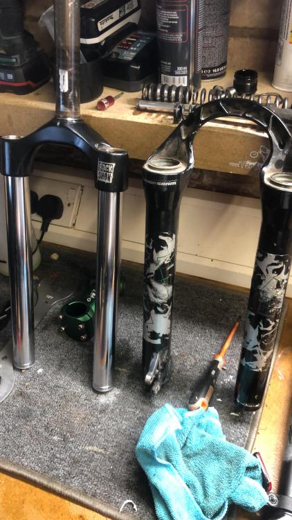

I also decided to brave the world of suspension maintenance:
stripped the forks down and cleaned all the internals

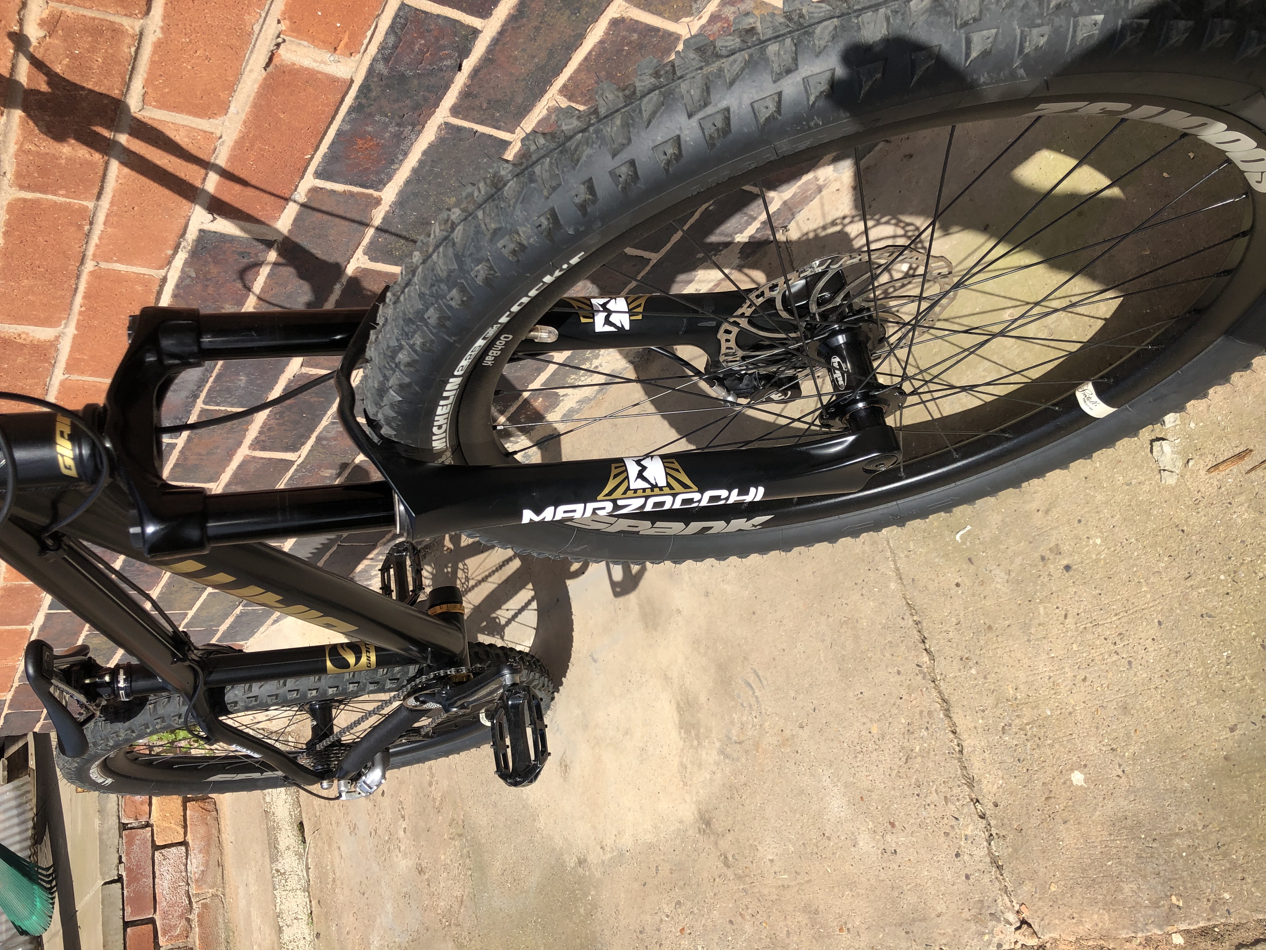

The forks are still in bits as I need to have them painted - there were some gouges that I’ve sanded out. but I managed to get some marzocchi bomber DJ1 forks on another second hand bike purchase so they have gone onto the current build

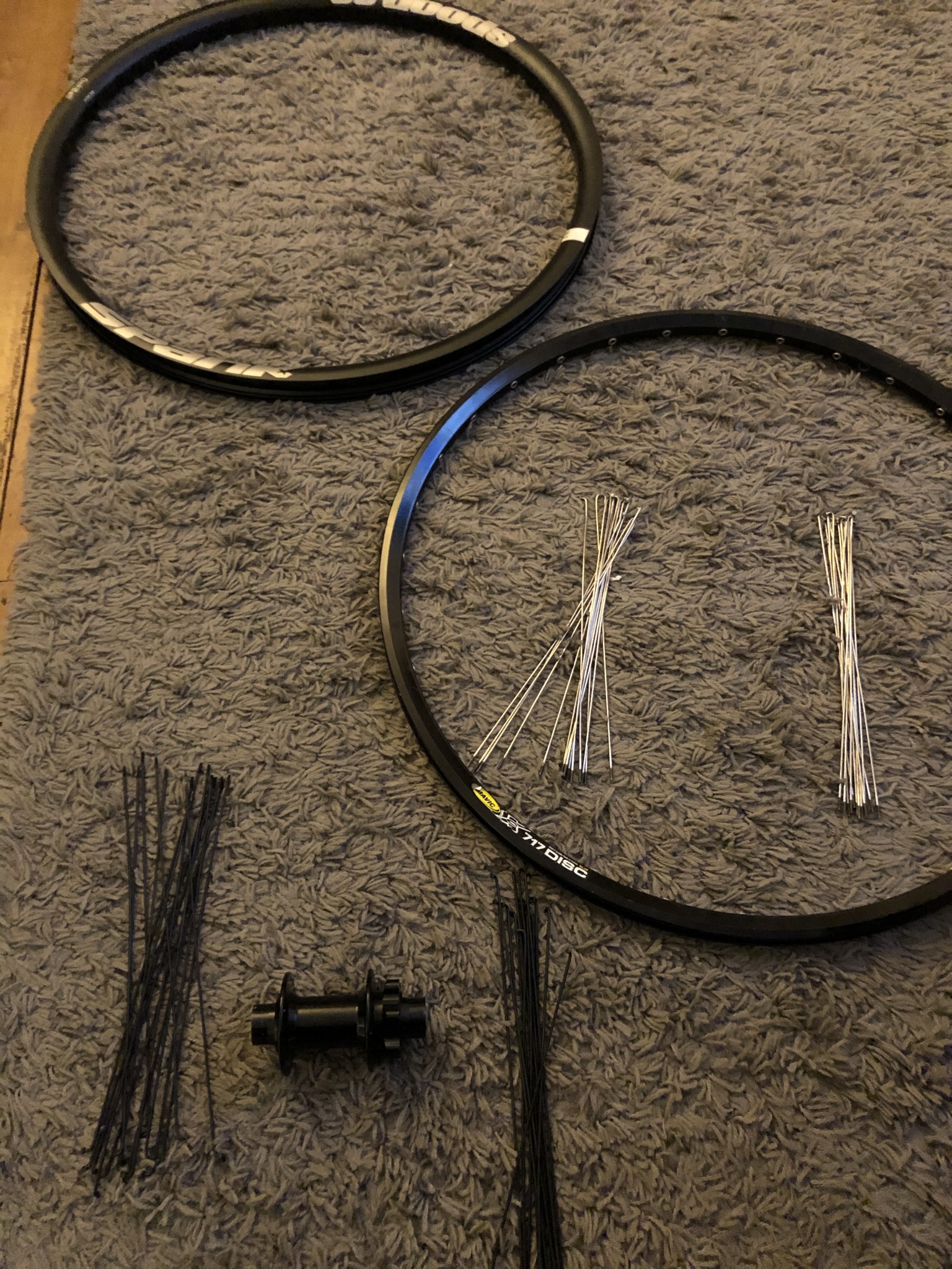

I purchased a wheelset from @LEON, I had these in mind for a different bike but black pro 2 hubs would maintain the the look I was after and I had some trusty spank rims which I pinched of my Zebdi.
so I deconstructed both sets and rebuilt them up stealth style:

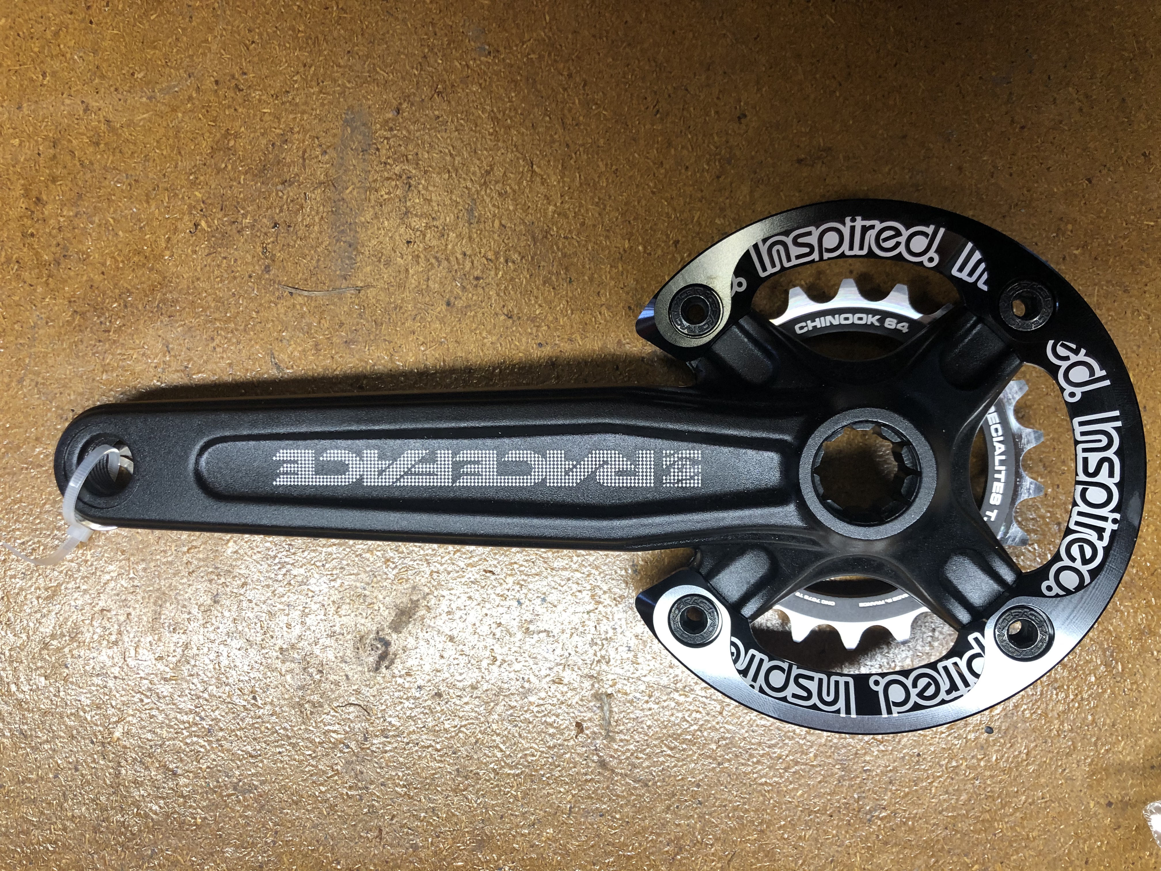

I also managed to find some second hand race face cranks. I searched for saints but finding a decent set that accept an inner ring and 175mm length was proving difficult.

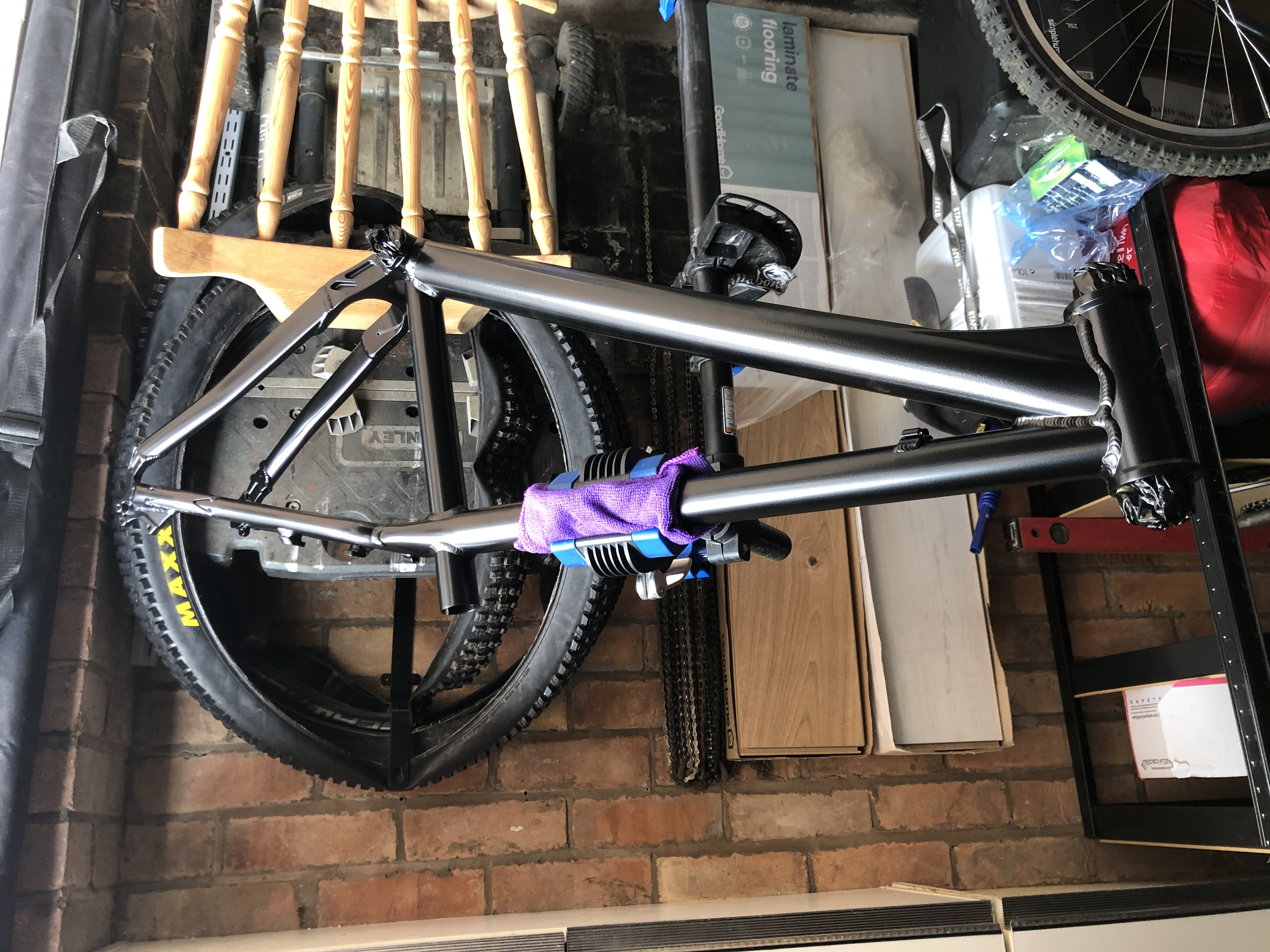

Whilst waiting on a few bits to complete the build I dropped the frame in at the powder coaters along with a couple of sets of forks - future builds to come!

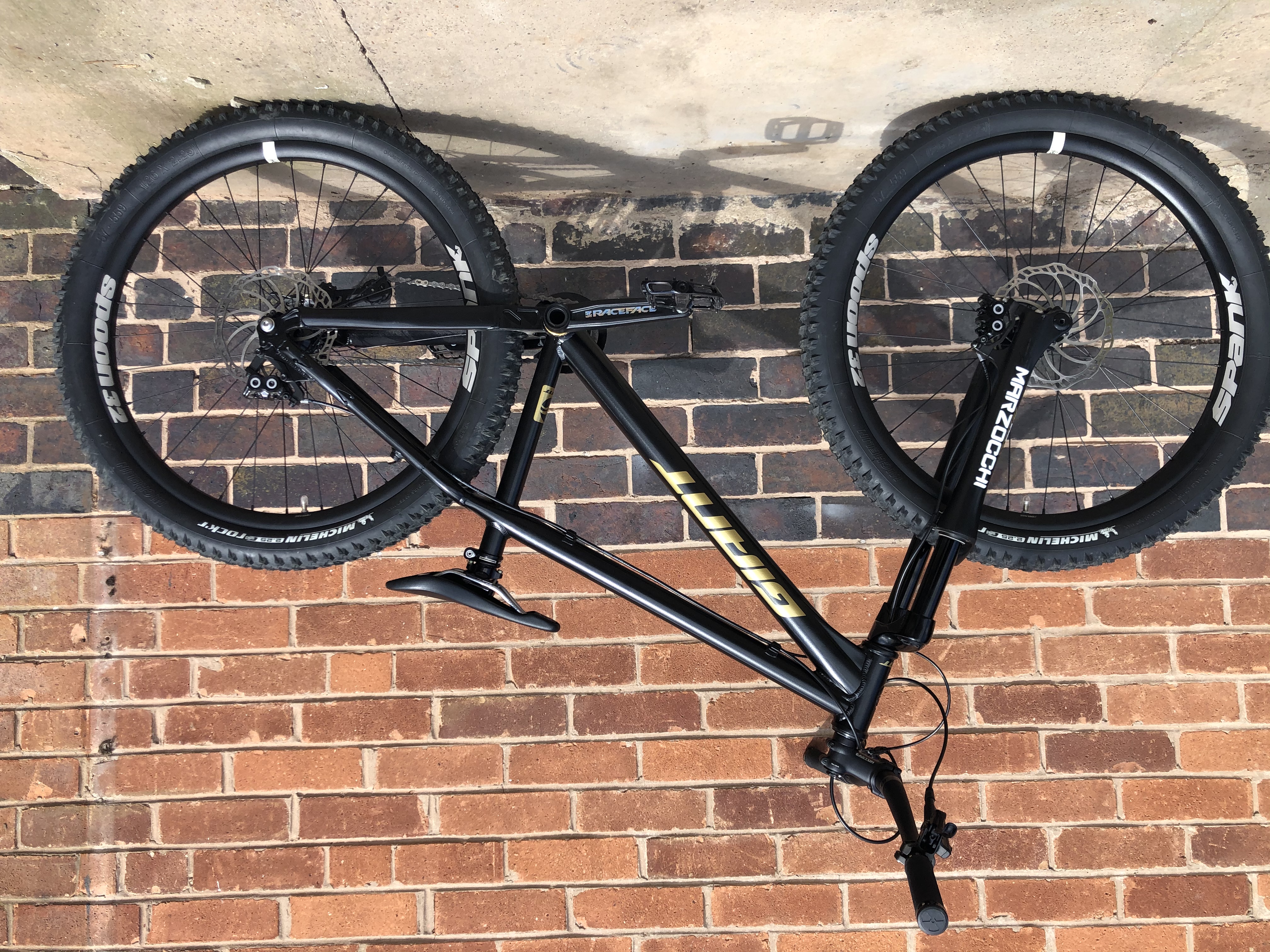

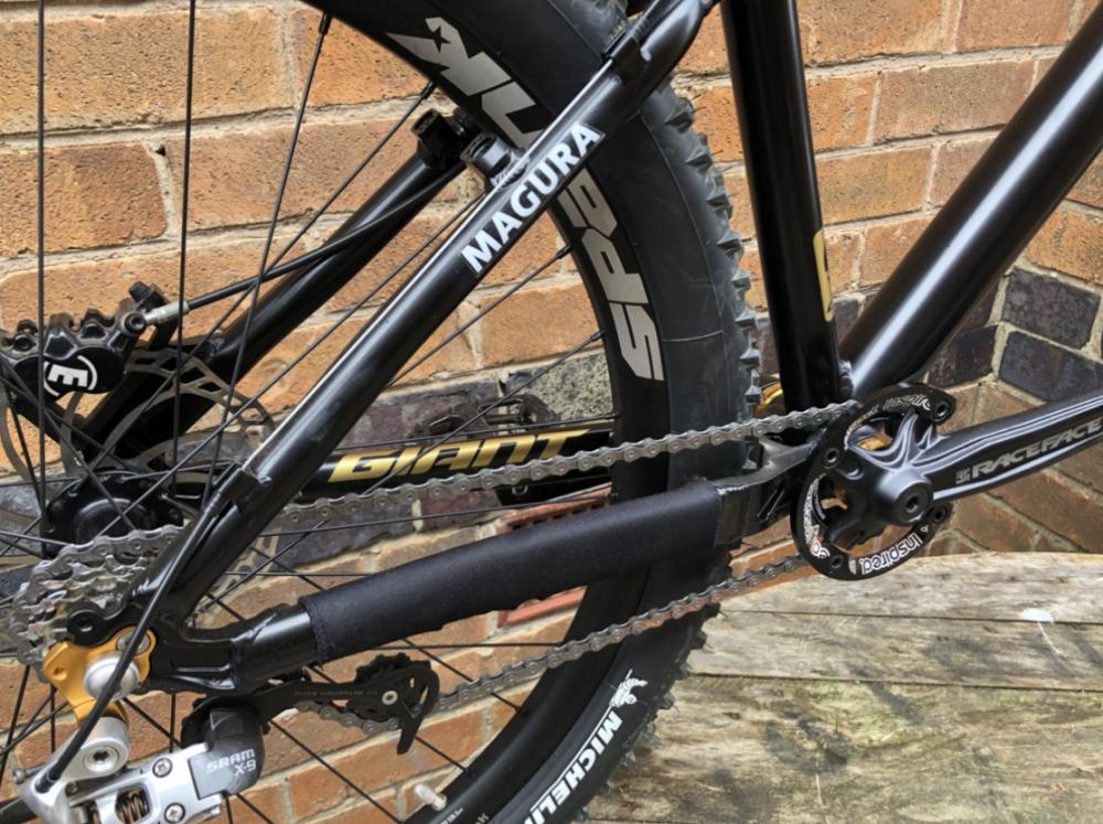

Build day had arrived. I was still a few bits short of what I’d set out to do, so used some spare bits here and there.
I wanted to run gears, although it’s a pro2 trials hub. I figured this would offer versatility for trials and park riding
With 6 gears ranging from 18t down to 11t  this offers fine tuning! And yes... it makes it competition legal haha (showing my age now!)

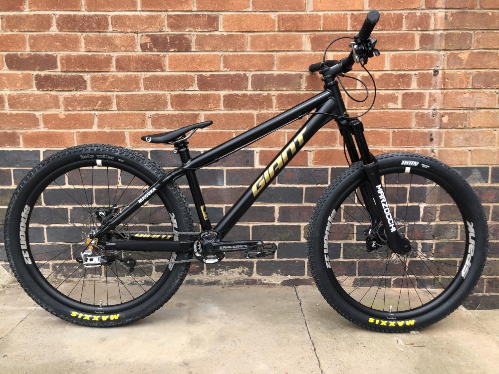

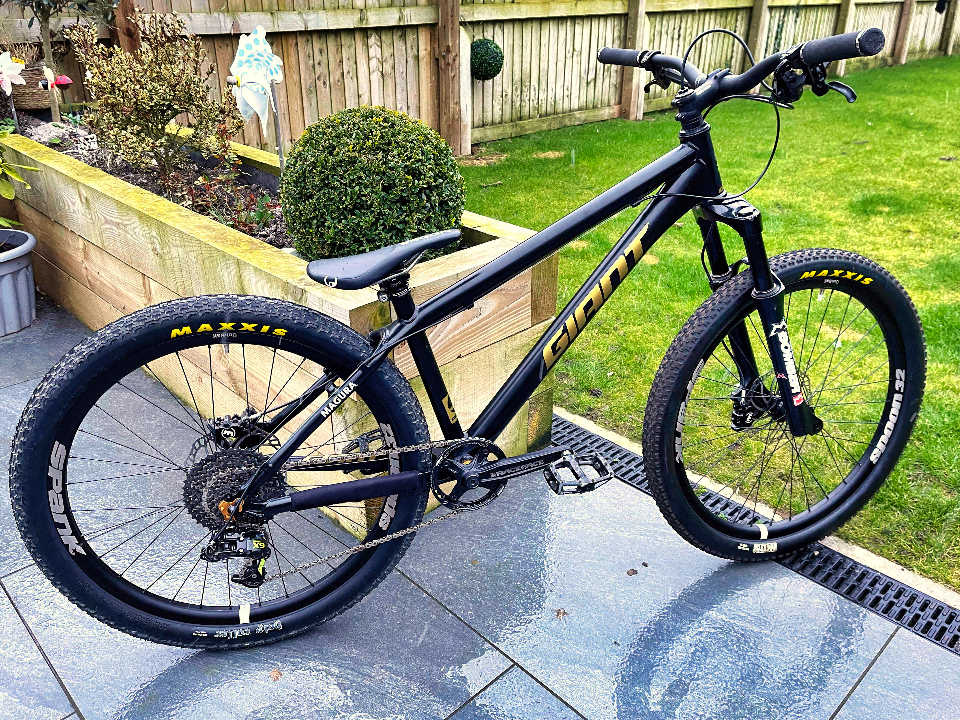

So here the bike is now as it stands. Graphics added to the Matt black frame, I have some in the post for the forks.
I have to say, it is incredibly good fun to ride, I completely forgot how good bunny hops are with front suspension. I’m running forks pretty hard.
The 70mm stem sits just right, short enough to make the front poppy, but long enough to keep it feeling Trialsy on the rear wheel.
  • Like 11
